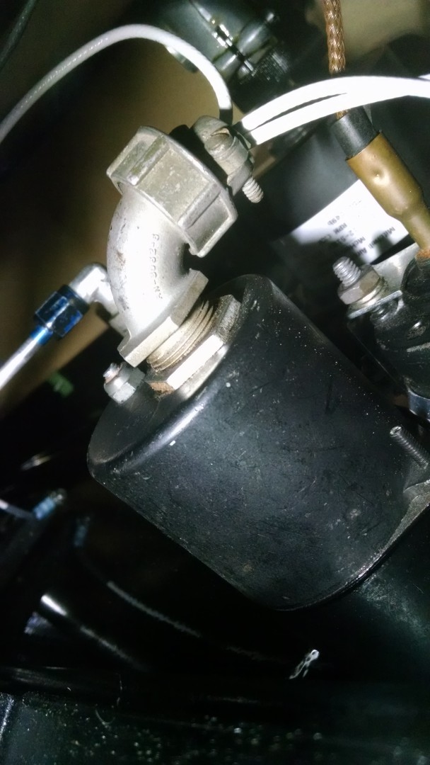

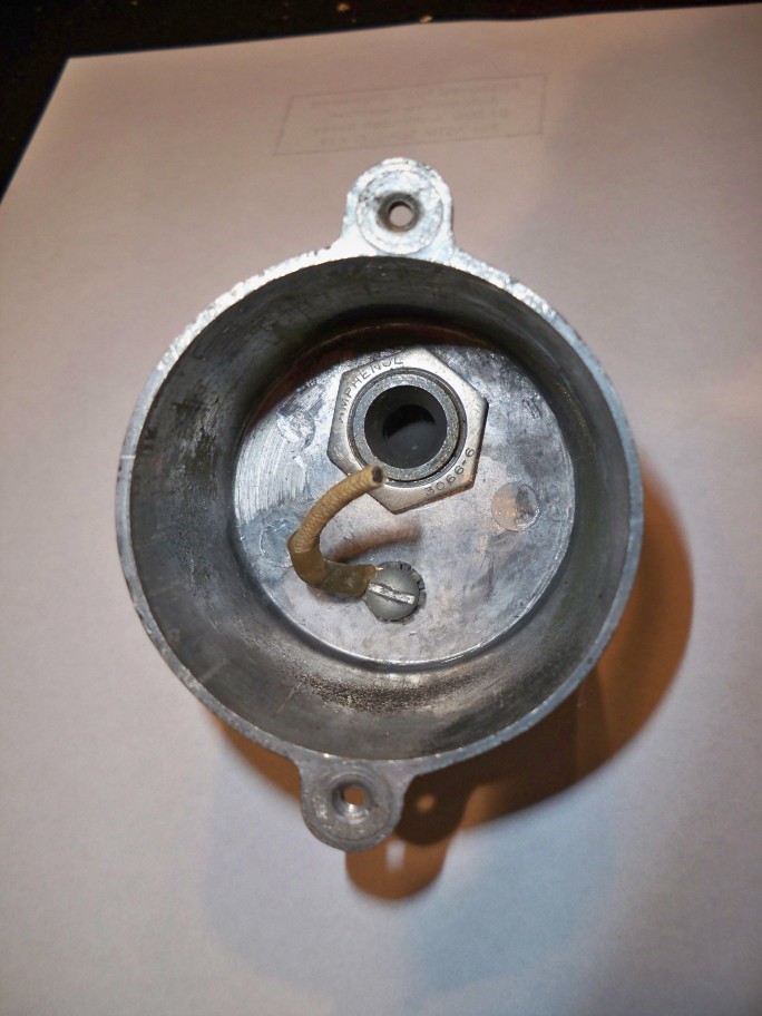

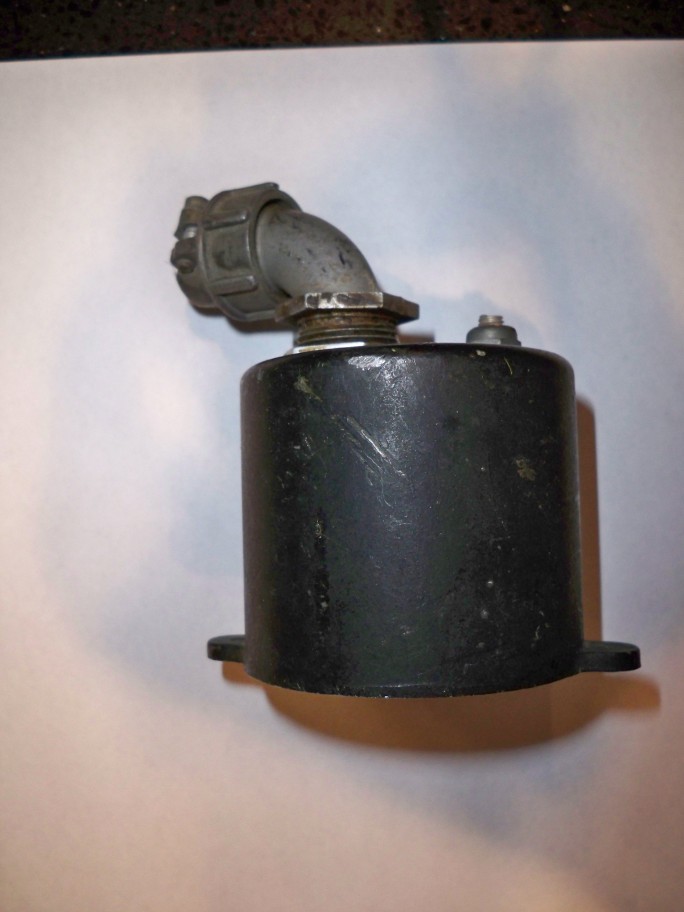

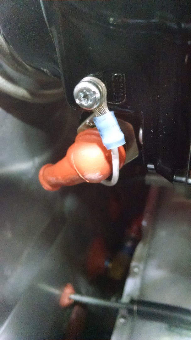

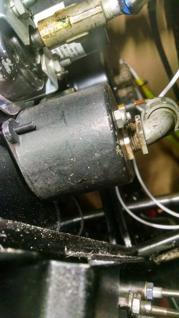

    Here are pictures of the mag switch cover, you will note there is a spot for a wire inside the cover that you ground to the frame of the aircraft. The mag wires are shielded wires which you also ground to the cover's ground screw, which then gets grounded to the aircraft. The other pictures are showing it installed on the mag switch and the mag wires going to the two mounting points on the mag.
