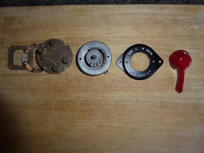

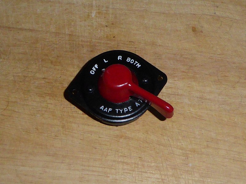

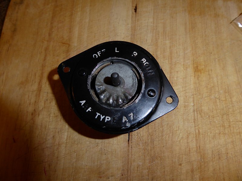

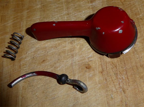

        The handle came off on my A7 switch a few weeks ago. In the first picture below, you can see wear on the lip that keeps it in place.
        A bit of judicious bending made a new lip, and after a lick of paint (and a service of the electrical connections at the back), it's as good as new.
        Interestingly, it feels very "positive" now in the detents, so the wear had been creeping up on me unaware.
        So something to watch for.

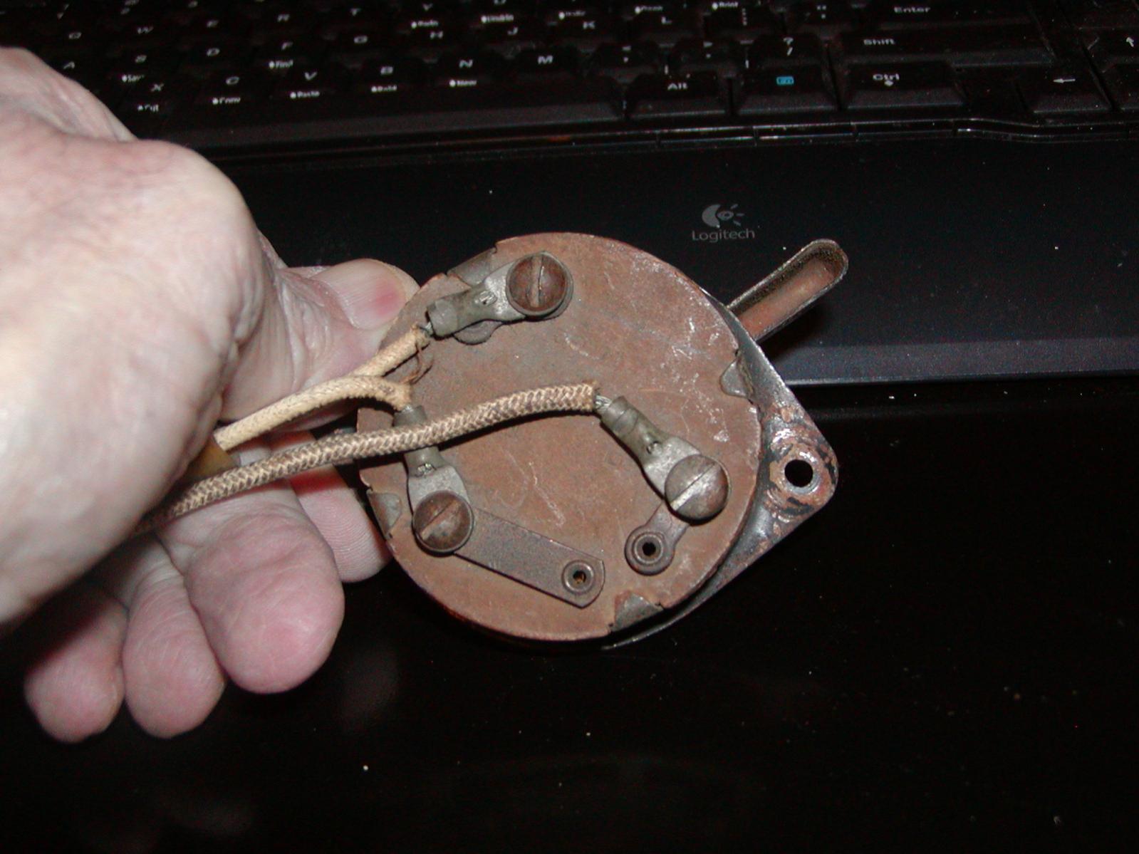

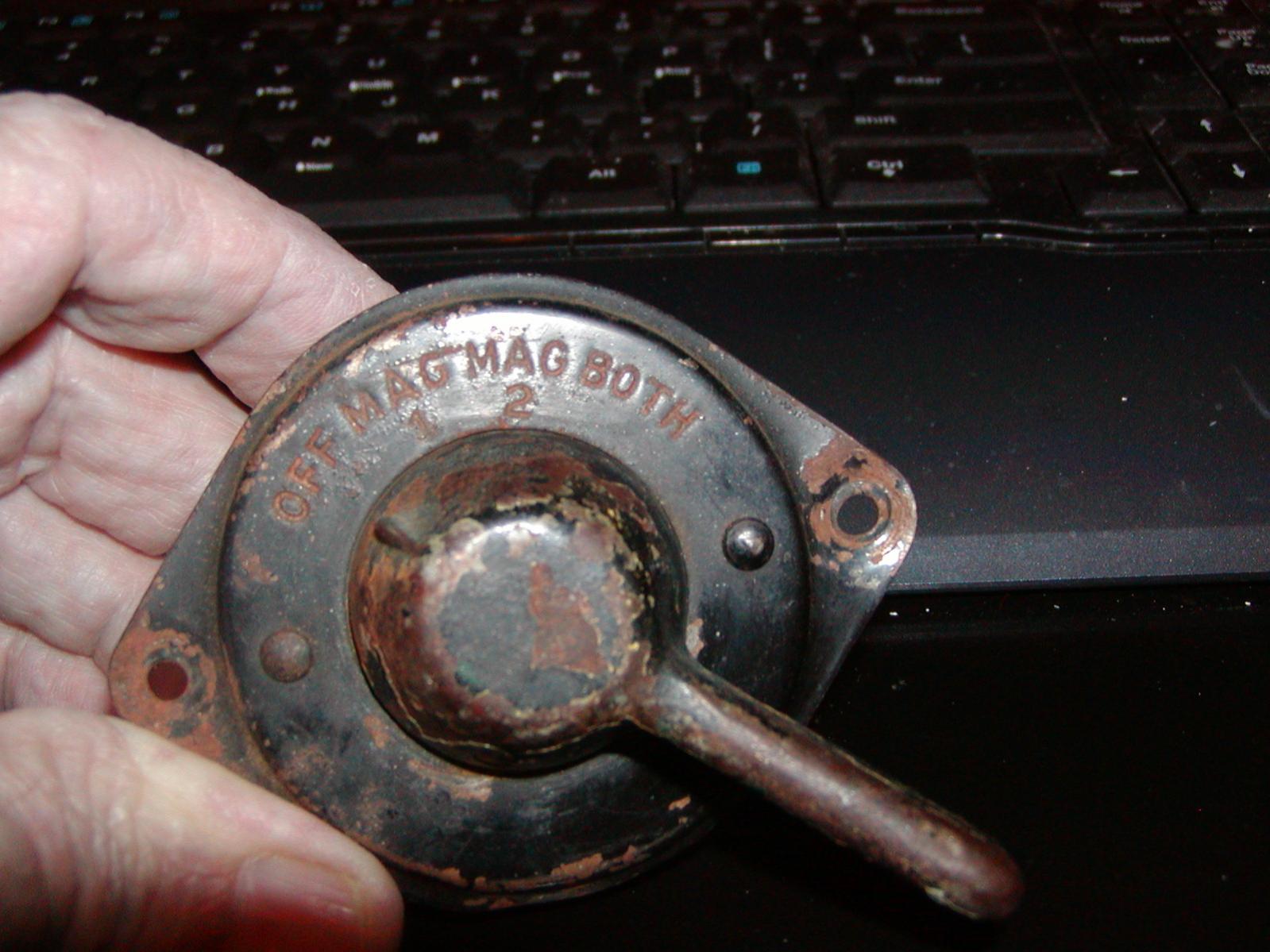

                      My mag switch is sure different from the ones pictured, it has off, mag1, mag2 and both. it has a black handle. Sorry couldn't post a picture but it's the wording that gets me with the word mag1 and mag2 on the cover plate.
                      • #26
                        Re: Mag switch
                        Here are the pictures
                        • #27
                          Re: Mag switch
                          Good pictures. Would you like to part with it?
                          • #28
                            Re: Mag switch
                            I would really like a rubbing of the markings. Wonder if I stamped a new mount plate if I could get the lettering engraved in. Looks like a photo I saw of one in a 41 Deluxe.
                            • #29
                              Re: Mag switch
                              Sorry Rob I would only part with it if for some reason I had elec start and then I might just put in a hidden button for that. Hank I'll get some good rubbing paper and see what turns out.
                              I am going to need to find someone experienced in rebuilding them to redo this one, the indents are really good-no slop in the different positions and feels good on resistance to moving to the different positions so prob will just need the refacing.
