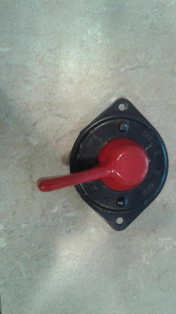

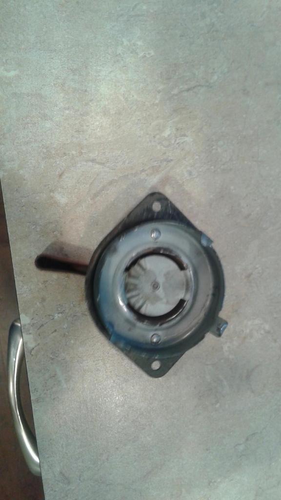

Can you post a photo or two of the lever mag switch you want to convert? We can get together and I can show you how to do it.

That's the easy one to convert, and that one is also missing parts so it is a good candidate. Maybe we should get together and do a thread on the process. I need to do another one for the 45 too. Tulsa is kind of far from Virginia Beach. We may need to do this on line.
Hank, not sure what you mean by "convert", can you explain your concept? Per Tom's article, you only keep the lever and the panel escutcheon. A new switch mounts in the panel, then braze the key into the lever, both cover up the new switch.

That is not the article that I was talking about. Mine was modification using the face plate and handle from the A7 and putting a modern keyed switch behind it. The key is installed in the handle, and then the handle can be removed from the switch and stored elsewhere.

My "conversion" is to use only the front plate and lever too but I filled the lever with epoxy. I would have never thought to try and braze to the lever. Wish I had known others had done this when I made mine. It really is a pretty natural idea.
The 41 uses a completely different mag switch from the 45 and I had to make the lever. If you look close you can see the 41 Deluxe type switch plate and lever. One confusing thing is the plate is labeled with 1 and 2, not Left and Right. Works great and most are really surprised when I pull the lever with a key out of the panel.
