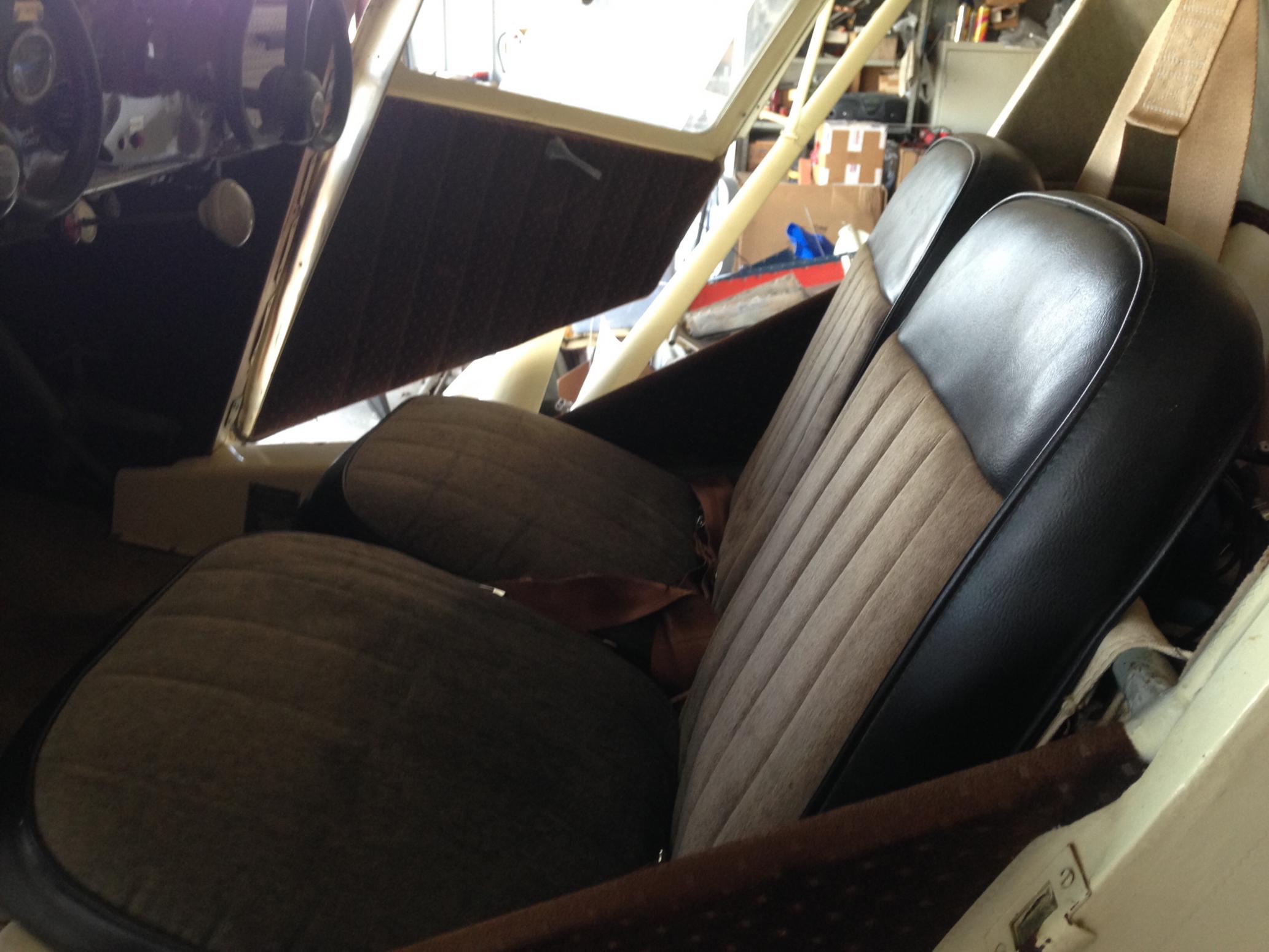

    I have a question about if i place Cessana 150 seats in the tcraft without doing any paper work is it legal. I took the original cushions out and i have a wedge shape piece of foam in the sling so that it is level with the front support tube so the 150 seats just sit in place without being attached in, just the seatbelts hold them in place. They are very comfortable and plenty of room. Any thoughts on this.

              I agree with the logic to just use and enjoy, I will probable get them recovered at some time. Thanks guy's.
