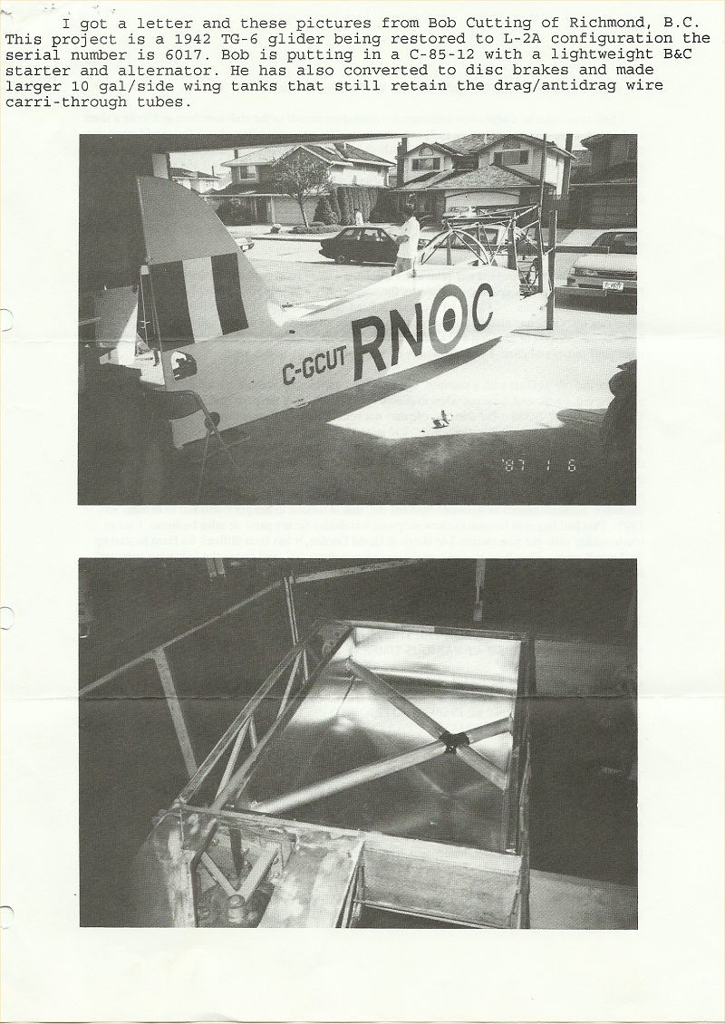

                  OK, I found the original TOC Newsletter entry, but I don't know where my colour photos are.
                  This newsletter entry is from June 1997 (so not quite the 20 years ago I was thinking). It applies to a TG-6 conversion to an L-2A as is apparent in the text.
                  Legal bit: Copyright notwithstanding, this is posted in good faith (I was a paid up member of the TOC back then).
                  Sensible bit: Do any of our Canadian Tribe know what became of this aircraft?
                    Re: So what do you think about...????
                    The fine print looks like 10 gallon tanks. Aircraft is in the States, now: N68577, LOWE ROBERT E

                    Oops, take that back. It was deregistered in 1973 so that means it went to Canada then. Sorry.
