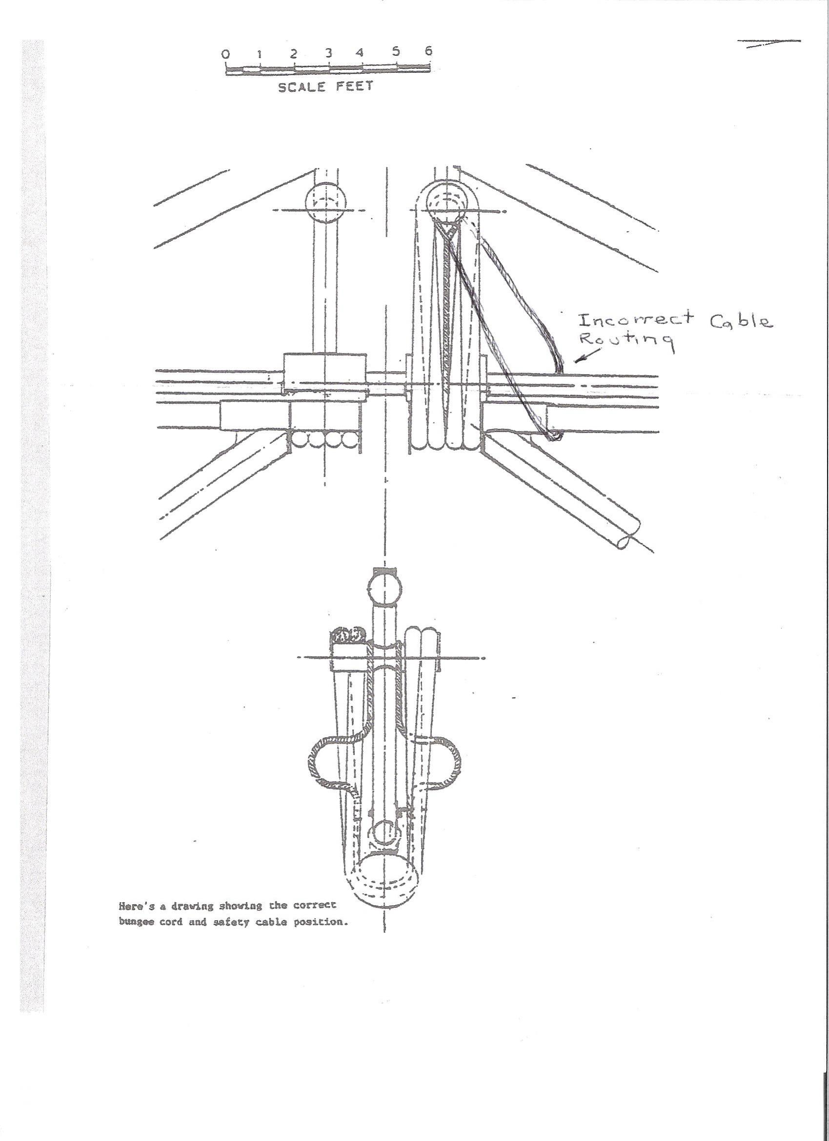

    Thank you for your help with my photos. As to why the engine quit...
    After several meetings with the FAA and my mechanic the probable cause of the engine quitting was ice or sediment in the needle/seat of the carburetor. I had the carburetor rebuilt by Aircraft Fuel Specialists and they indicated a considerable amount of fine sediment was present.
    I have attached the sketch show the incorrect routing of the cable. With that being said, any routing other than than shown in the sketch will in a probability lead to gear failure when the stop cables are needed due to overload or breaking of the bungees.
    Thanks again...
    bob p

      Thanks for posting this information here. The education that we're collectively getting from your experience is very benefical.
      I never would have thought that the cable could have cut through the steel member like that.
      I also had a bungee failure upon landing a few years ago. My safety cable did its job. So all I had to do was install new bungees.

        I have attached a sketch that I modified showing how the cables were routed on my TCraft. With the cables routed under the two small thinwalled tubes at the top (as shown) the cable will cut through them and the gear collapse. Had my cables been routed as per the sketch I probably would not have sustained any damage.
        bob price

          Resending attachment.. showing improper cable routing as found on my TCraft
          bob price

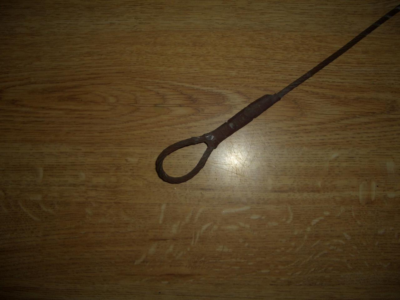

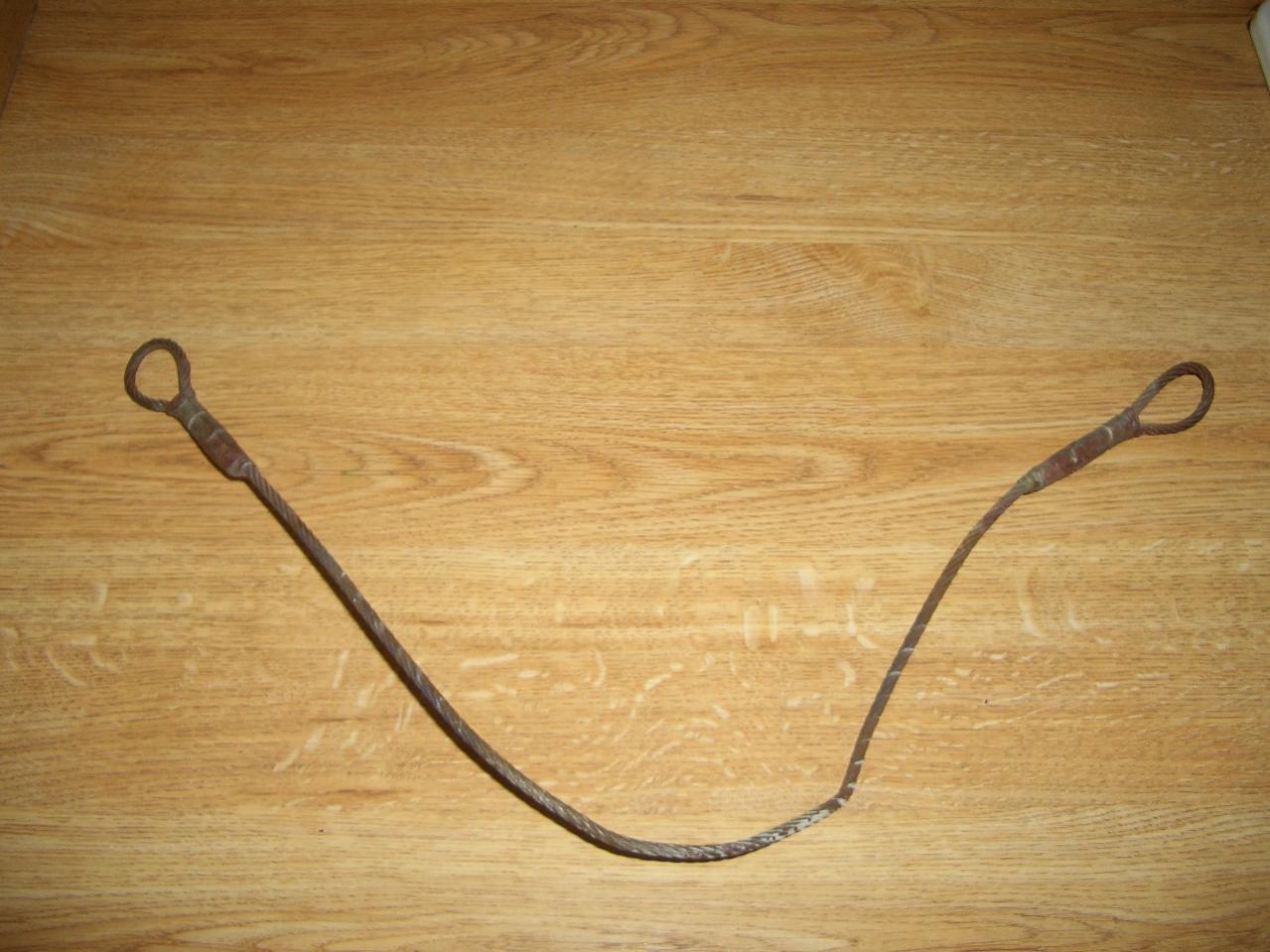

            I thought I would usurp this thread a bit with a parallel subject. I wanted to make new gear stop cables since mine are rusty and have a few strands broken. I'm including a couple of pictures of the old cables. A few questions:
            1. Are these originals? They appear to be wrapped and soldered on the ends
            2. What length should they be? If these are originals, that answers this question.
            3. I'm concerned about using Nicopress fittings that will leave sharp cable strands poking out to attack the bungies.
            4. How have you handled replacement of these cables?
            thanks

                Wrapped and soldered would have been original. Pre war and post war cables are different lengths. If you do the Nicopress sleeve I would put something over it like a piece of heat shrink tubing to hide the sharp cable ends.

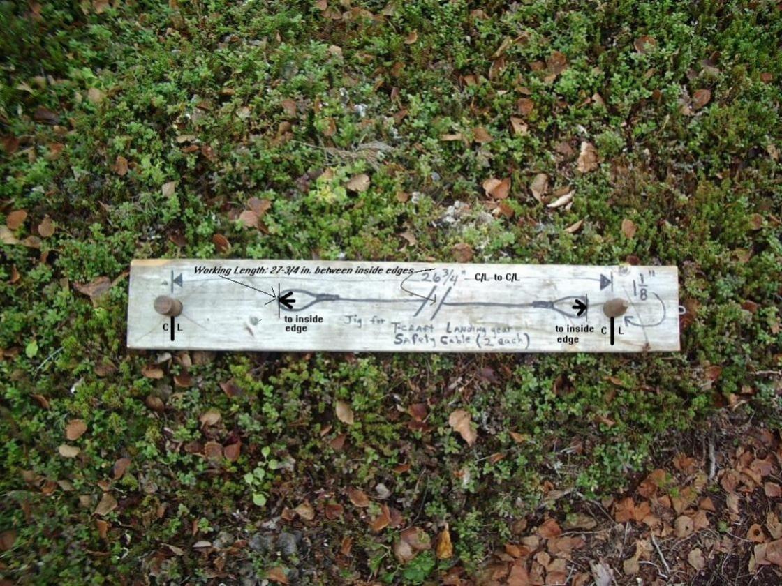

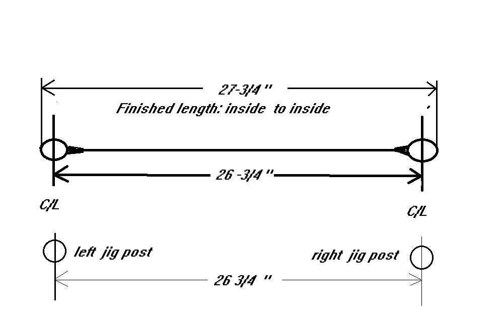

                  Ok, the pre-war and post-war are different lengths. I found these pictures on the other thread. Are the dimensions correct for the pre-war or post-war?
                  Thanks,
                  Hal

                    Those dimensions are within 1/4" of the cables that came off of my '46 BC-12D. My cables had NicoPress on them so they are not original.
                    But based on this, I'd say that the sketch above is probably for post-war (like mine).

                          The cable in the picture I posted above is almost exactly the length shown in the sketch (27 3/4 inch) and mine is a 41. If this isn't the right length I want to know before I cut the cable.
                          Also, the previously referenced thread said it should be 3/16 inch cable. My soldered cable is 1/4 inch. Which is correct?
                          • #28
                            Re: Gear Stop Cable Failure
                            Sorry, I spoke too soon. My cable is 3/16 inch, not 1/4.
