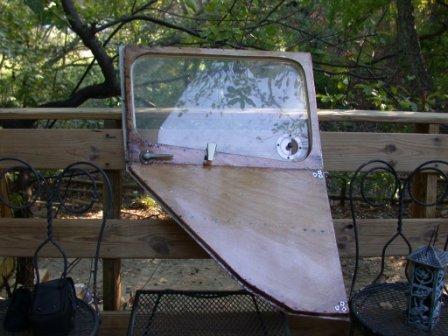

              They are actually fairly light and well designed, just VERY complex and hard to build. When I rebuilt my wood doors i used he fuselage door frame as a fixture to get a good fit with the door. You can't pull a strip of paper through the gap with the door closed. I did cheat a little before I put the ply skins back on and laid carbon fiber tape over the frame sections under the ply. Only added a few grams of weight and stiffened the doors considerably, especially the window frames! I also replaced the door and window hinge wood screws with T nuts under the ply and used machine screws with what looks like wood screw heads. The wood screws were worn in the holes in the wood and looked like they had been soaked with glue in the past to harden up the wood. I REALLY didn't want a window or door to be torn off in flight because a hinge screw pulled out! Click image for larger version

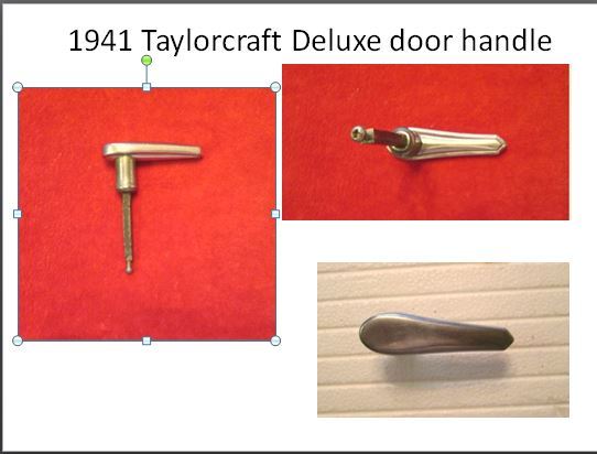

                        This handle Click image for larger version
Name:	1941 BC12-65 Deluxe door handle.JPG

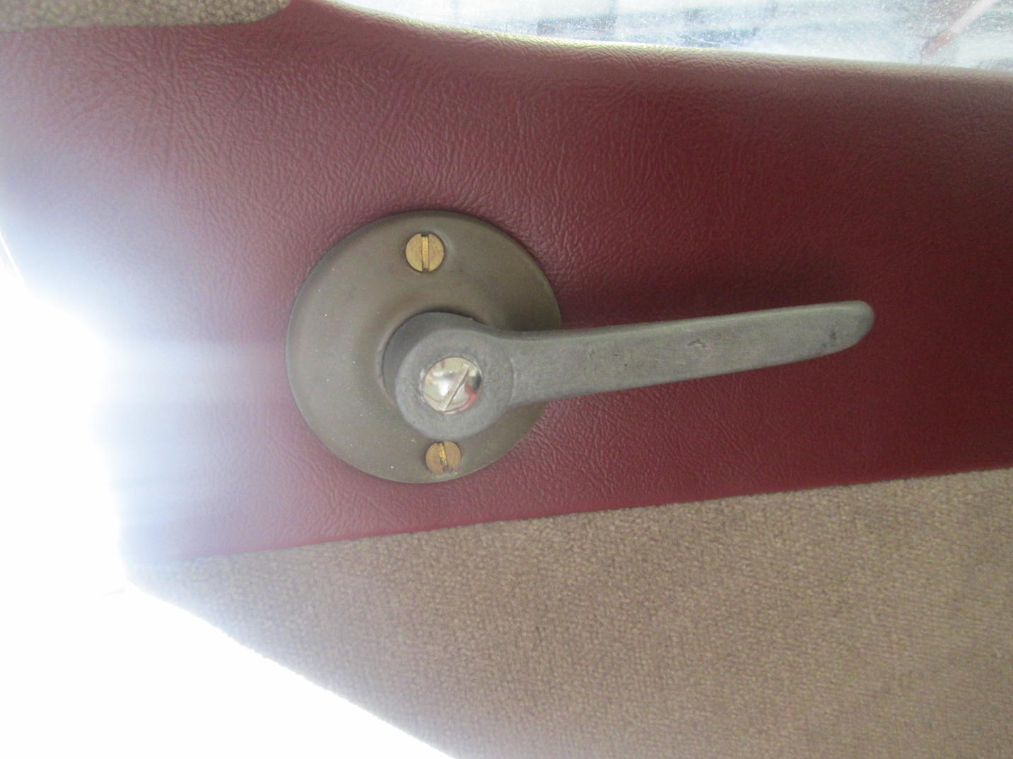

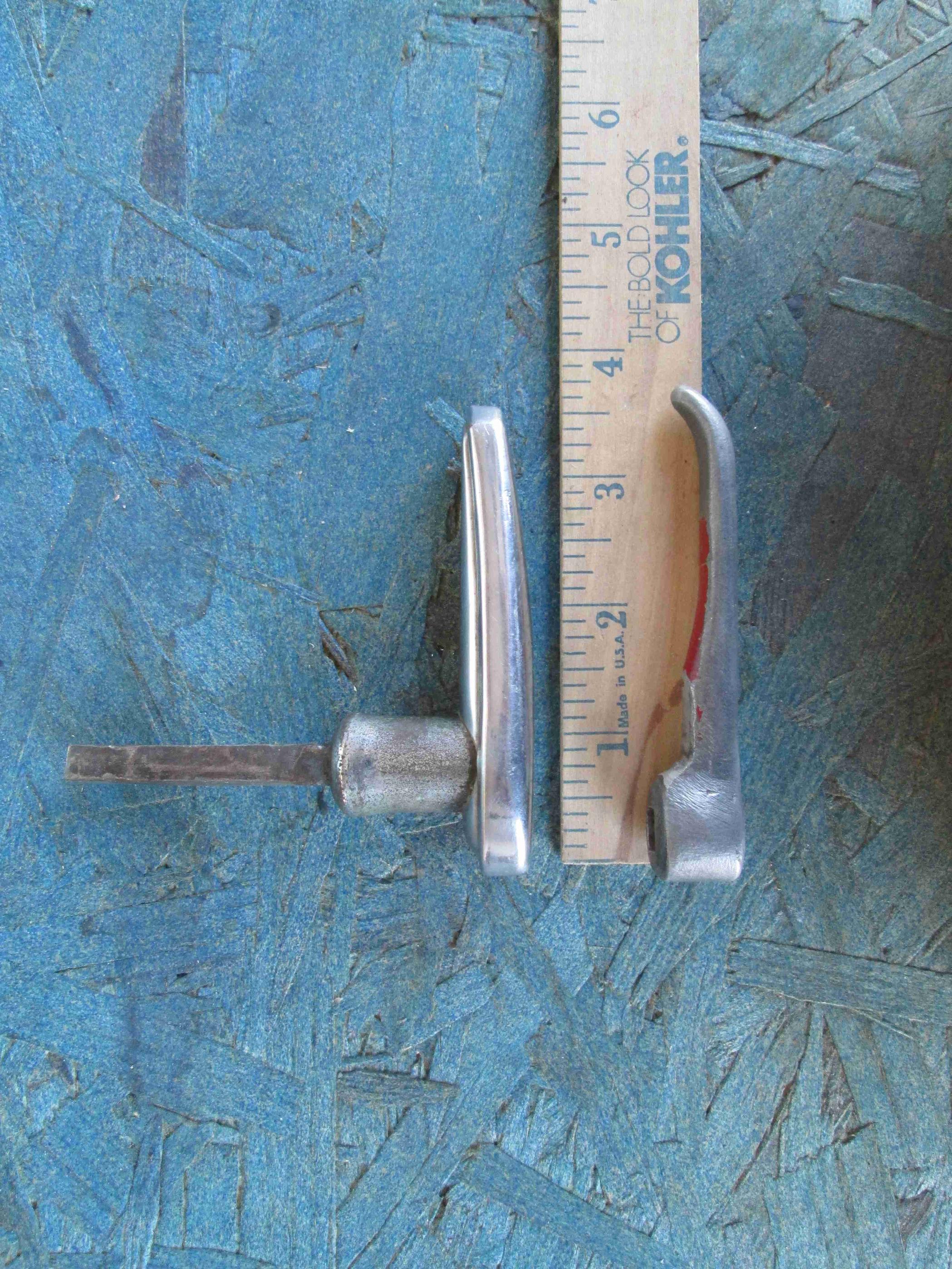

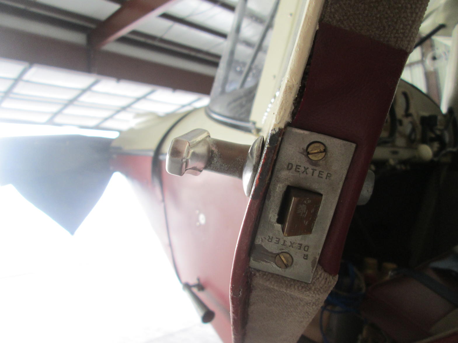

                          Hank, they are Dexter screen door latches and handles. You need to be looking at architectural salvage places. The right side is a locking latch, and the left is not.
