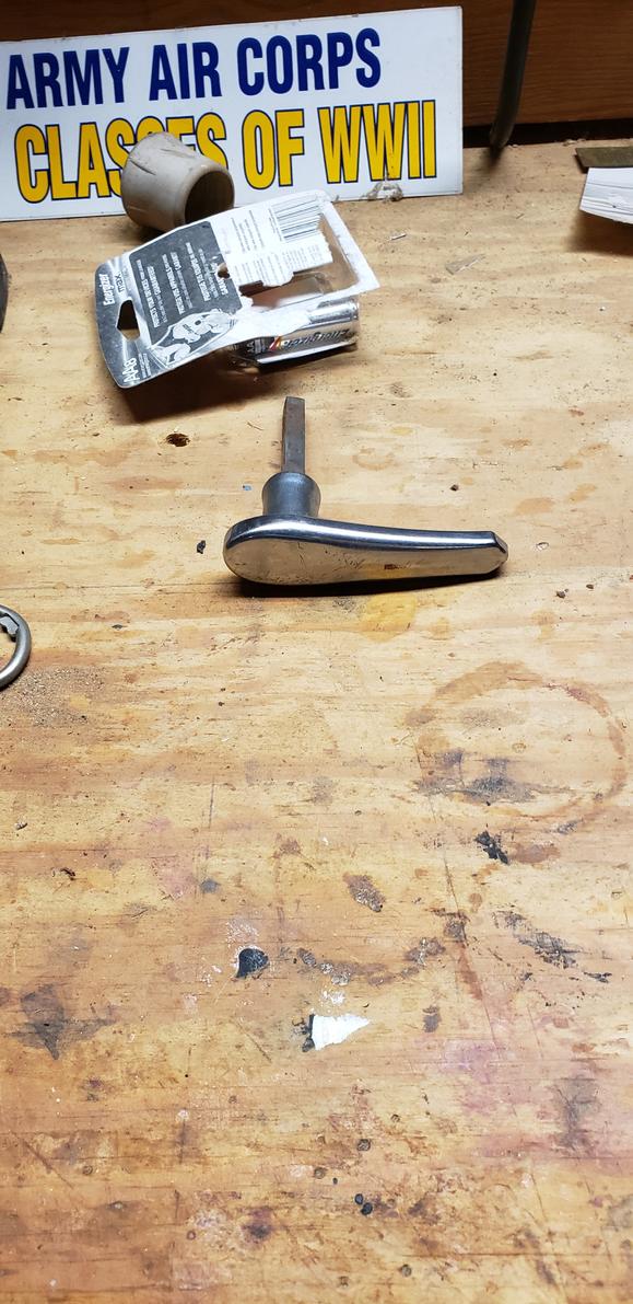

      This handle Click image for larger version

      Hank Do you still need this handle? If so I will bring it up. It came off a 41 parts airplane I once owned (for some reason the name of Powell comes to mind as his dad had purchased the plane when New ??9..He had posted pictures of it here. It was painted Maroon and ivory I think) any way it is about the last thing I have from it.
        Jim, that is the one I need! I just made a mold to cast a resin copy last night, but it was a last resort since past resin copies tended to break. Just not strong enough. I was going to try drilling a hole in the handle to insert a piece of steel wire this time, but it was a real Hail Mary shot. I am betting that might have been Buell Powell's plane. I haven't heard from him for some time. Buell? You still out there?

            Yes I believe it was Buell Powells or his dad's plane .
            I will bring the handle up with me when I come which will be very soon.
              Looking forward to it. Bring your Christmas list.
                Have to admit, that handle would look a lot better on my '41 deLuxe than the Home Depot closet door handle that's on there now.
                  Peter, Like I told Jim, I just made a mold to make them and have gotten several different handles that I have used but always wanted to put ORIGINALS on my plane.....and one was missing. How about posting some photos of your plane. I am always watching for 41 Deluxe parts and have made tooling for a lot of details. A lot of 41 Deluxe trim stuff was only used on that ONE MODEL AND YEAR! I may have some goodies to help trick out your plane. I do have several handles that were really nice, just not original.

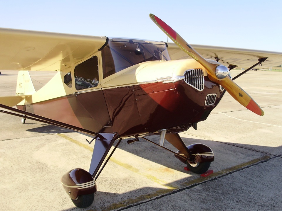

                            Jim, while digging through old photos I found this photo of Buell Powells 41 Taylorcraft. She sure was a beauty!
Name:	Buell Powell 41T.JPG
                              Was that his or his fathers? I recall him saying he restored his to look like the one his dad had which is the one I ended up with. (What was left of it) I hate to say I parted it out however parts went to other so theirs could live on. The last thing I had was the fuslage a d it went to a gent for his 41 restoration which I believe he said had been his dads! I keep up with him from Time to time.
                              Those 41s all dolled up are truly the bell of the ball. CG Taylors high water mark for sure.
                                Did you keep the paperwork and data plate? Maybe someone will do a resurrection!
