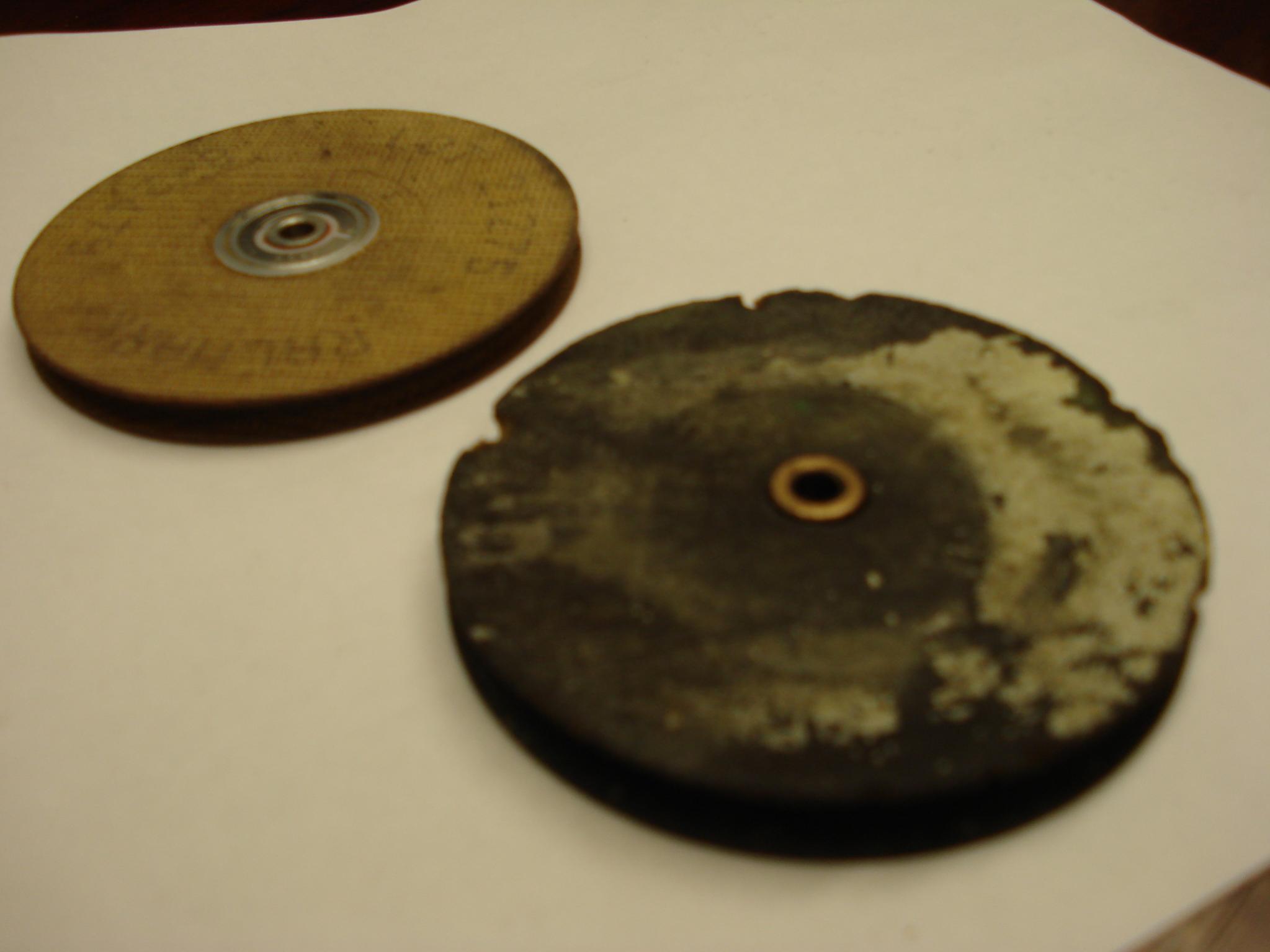

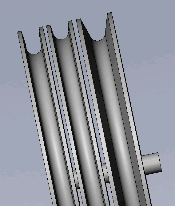

                        I don't think that the old pulley groove is worn. I'm replacing them because of the nicks in the flange (see my earlier picture). But see the sketch below. The middle pulley is what the new pulleys look like. The one on the right is what my old one looks like. The imaginary one on the left is what I imagine the new one would look like if the groove were worn to the diameter of the old one. But the old one doesn't look like that at all. The groove is tapered, not straight-walled
                        Tim Hicks
                        N96872
                          Re: An228 & AN229
                          It would wear like that if the pulley shaft was cocked to one side (not vertical with the cables coming straight back). Have you checked to see of the pulley is square to the cables?
                            Re: An228 & AN229

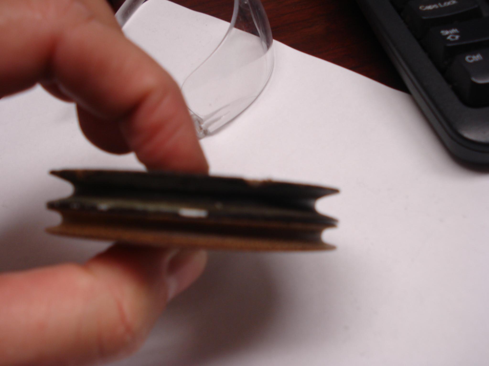

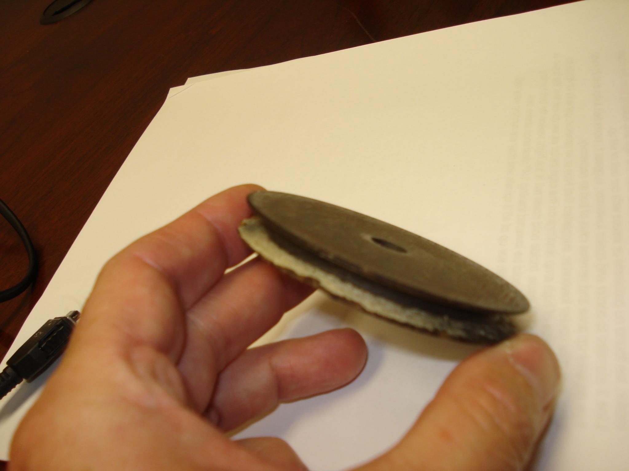

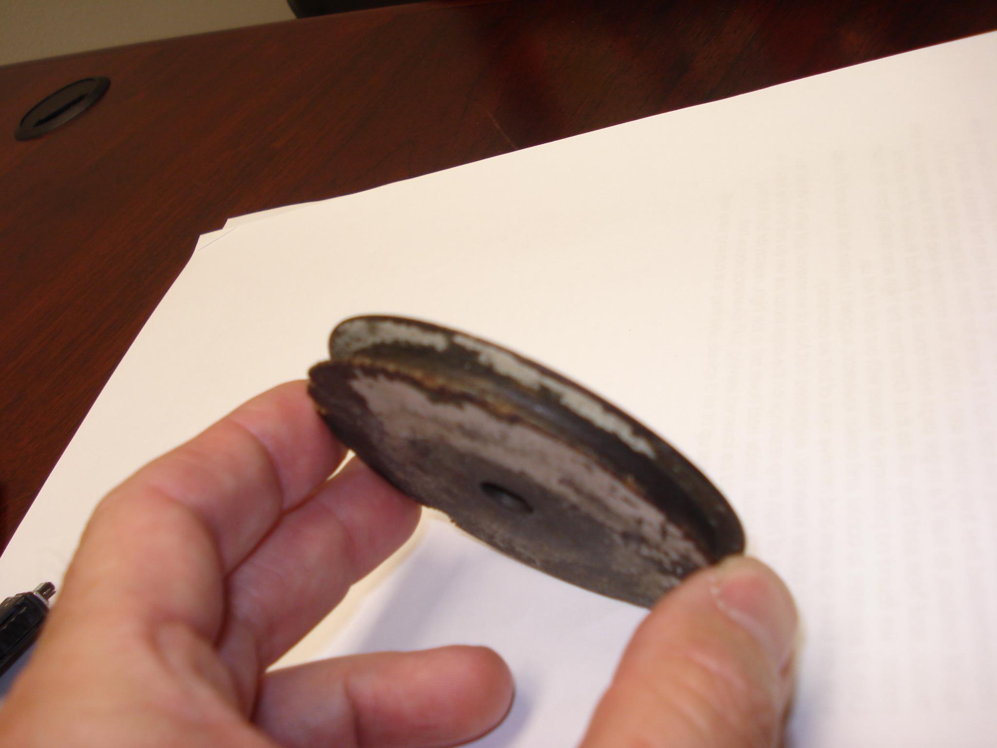

                            I'm really surprised that others haven't had this problem. I just assumed that the pulleys that I had were original to the airplane. Now I'm doubting that.
                            I'm convinced that the deeper grooves are machined that way. It is not wear causing the depth. The cables go into and out of the pulley without fighting the pulley. In fact, look at the pictures attached. You can see paint on the insides of the groove from overspray from the last time the airplane was painted (decades ago). If the cables were touching the flanges, the paint wouldn't have stayed there long.
                            The diameter (at the bottom of the groove) in the old pulley is about 2.515"
                            The groove diameter of the new pulley is about 2.690"
                            Tim Hicks
                            N96872
                              Re: An228 & AN229
                              I think you are right. That overspray would have stripped off the first few passes of the cable if it was touching. I wonder if someone turned the pulley on a lathe with a little round jewelers file or some sandpaper to clean it up sometime in the past. You can even put a pulley on a nut and bolt and use a drill press for that (NO, I am NOT recommending it, I have just seen it done!).
