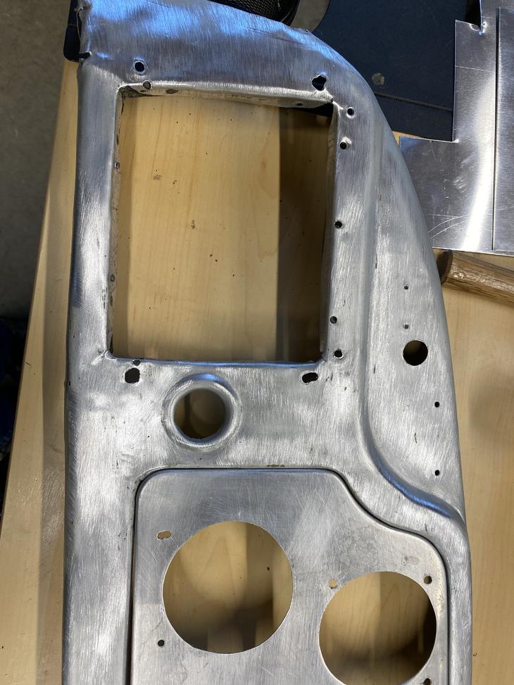

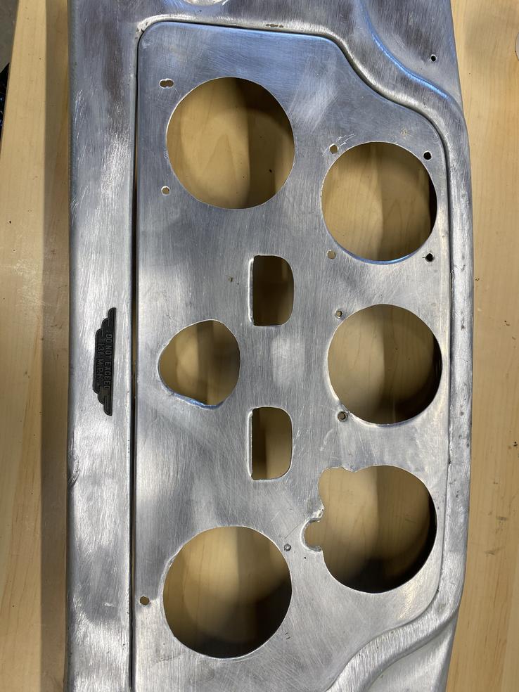

              • #52

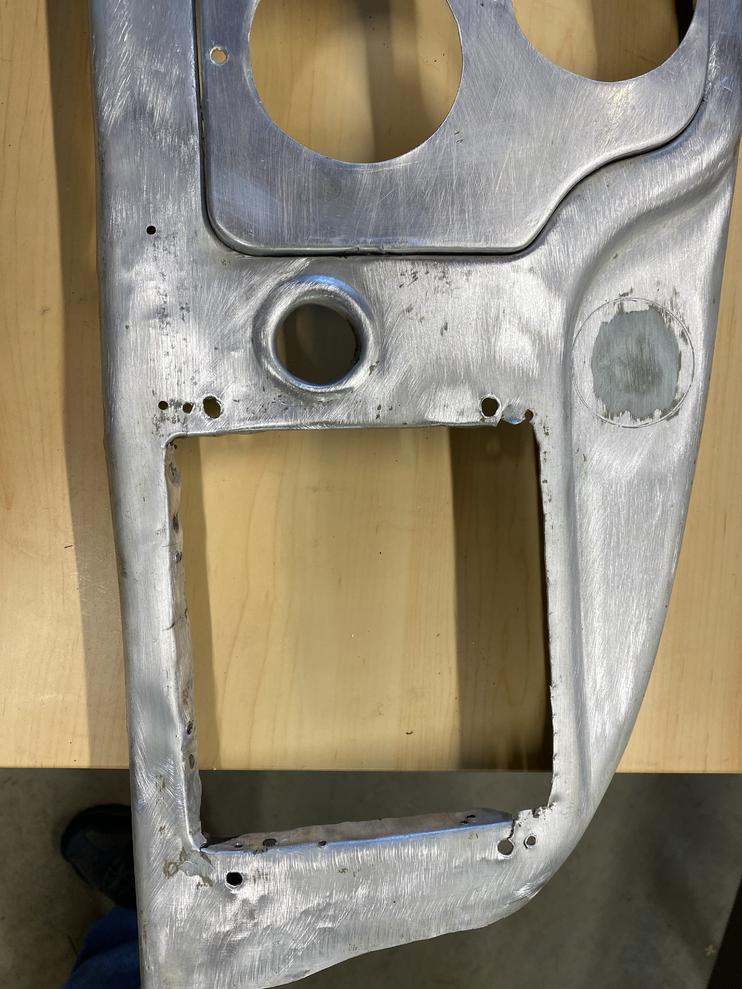

                Here are the pictures of my current panel project.
                I am looking for the A7 mag switch and the small gauges in the middle.
                • #53

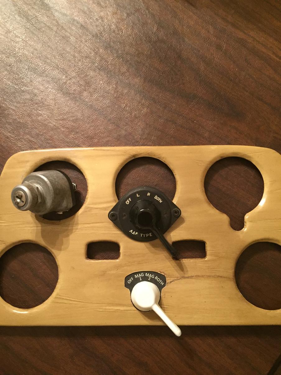

                  Paul, what do you mean by the small middle gauge? For the A-7 mag switch it was NOT used on the 41 Deluxe. There was a mag switch maounted BEHIND the panel on the instrument support structure. NONE of the instruments were supposed to be attached directly to the panel. That panel looks VERY repairable to me and could be flush patched to make it like new. The funny shaped bottom center hole above the VNE placard is where the mag switch goes if that is what you mean by the "small gauge in the middle".
                  I have drawings of the support structure that is supposed to hole the instruments behind the panel insert and am making a replacement lever and face for the mag switch so you can use a Grimes mag switch with a key in the lever that looks just like original.

                    Mag lever in this photo is still in primer but will be painted correctly for instillation. The A-7 is above it and a stock (relatively) modern Grimes mag switch is top left.

                    • #55
                      hank
                      I was referring to the two rectangular instruments above the mag switch. Are the round gauges behind a rectangular hole?
                      I am planning on repairing the panel. After stripping it looks possible.
                      thanks
                      • #56
                        Originally posted by TC747paul View Post
                        hank
                        thanks
                        Yes, they are standard round gauges behind the panel.

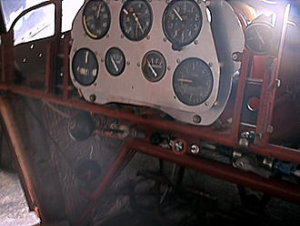

                        • #57

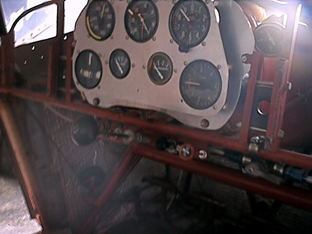

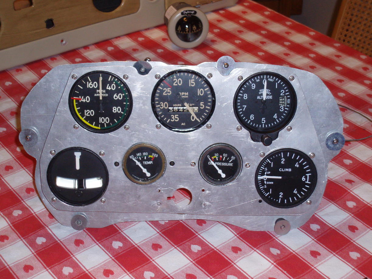

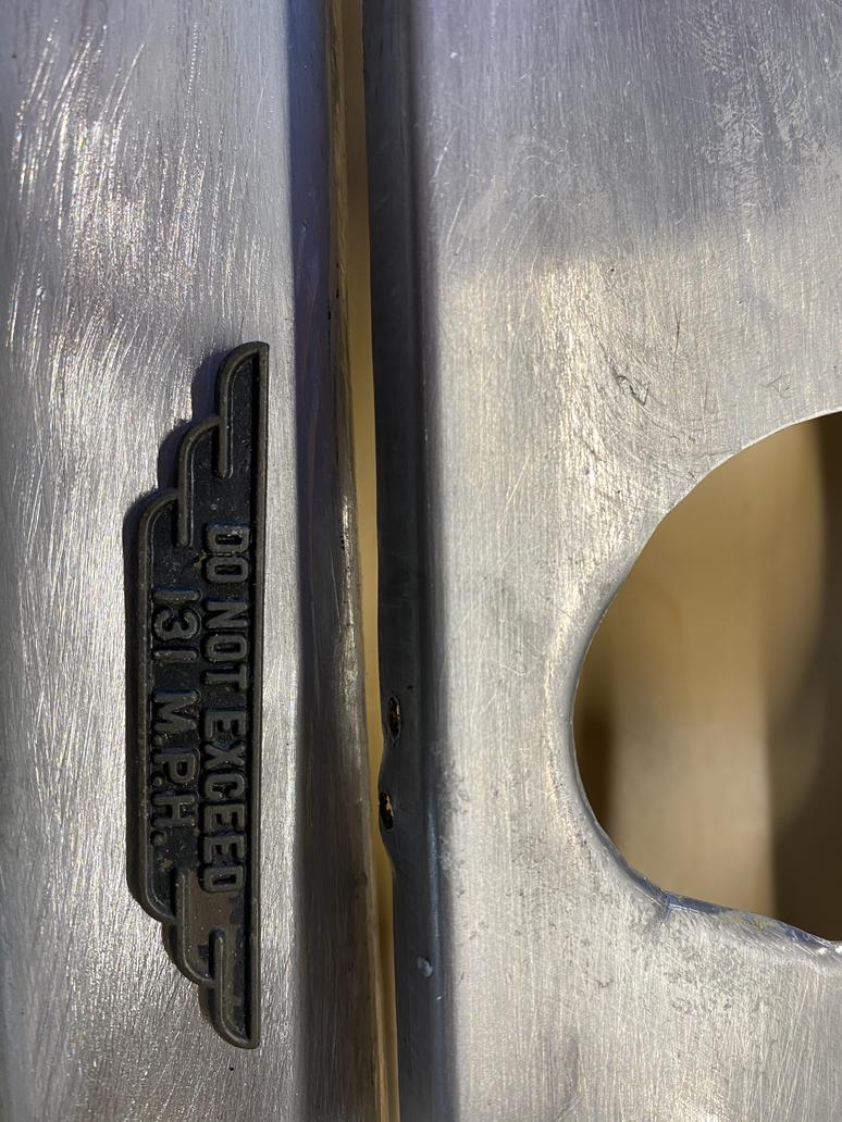

ID:	190476Click image for larger version
ID:	190477Click image for larger version
ID:	190478 This is what the instrument support looks like with the panel off. The support was shock mounted but way too complex for production and was not used on anything but the 41 Deluxe. It is rare and well worth saving. That panel is really sharp looking when restored! Note that I have the WRONG mag switch in the photo! Also almost all 41 Deluxe planes had the Banjo wheels which are VERY hard to find. The wheels in mine are the ones they put in when they didn't have enough Banjo wheels. I have a pair now but haven;t restored them yet.

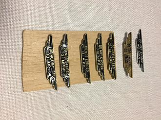

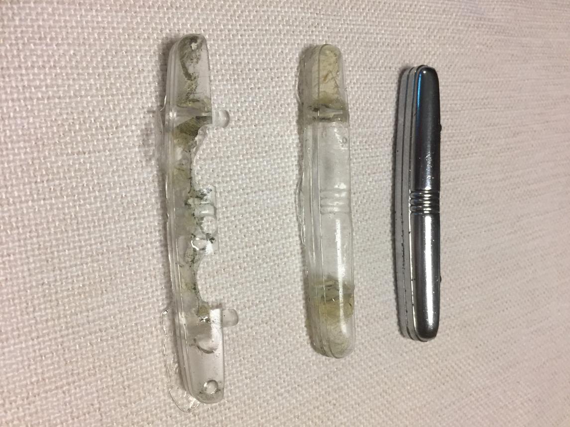

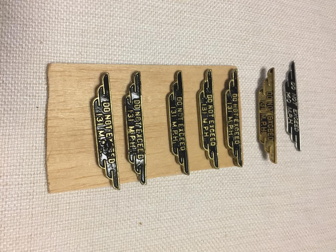

                            I tried a next generation of the VNE placards but am still not satisfied with the crispness of the lettering. Since I had to mix a batch of resin anyway I made a couple of molds for the early glove box handles. They only look different sizes because of the angle the photo is taken. They are all three the same size. Top (silver) one is the master, the bottom is one that was resin starved and is junk. Middle one is close but has some thin spots. Not terrible for the first generation copies. Will post more photos of the next batch of placards and handles. Still can't stop computer from rotating attachments!
Name:	VNE castings try 3.jpg
