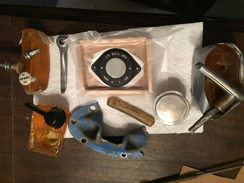

    Hank.... Search for broaching tool. Best be sitting when you see the cost. Maybe a square file would be better. Drill round hole, clean out corners with file.
    Mike Wood
    Montgomery, TX
    '46 BC12D
    N44085 #9885
    • #32
      Unfortunately it is a blind hole with only a small center hole for the screw. Couldn't use a file (my first choice, a LOT less expensive than a broaching tool!!! I ended up using a tiny chisel and being VERY careful not to punch through or crack the part. I shouldn't have worried. The resin was a LOT stronger than I thought when I started. I had to clean up some other parts and they are real blade dullers! I think if I do another one the square balsa insert is a great idea.
      • #33
        You might also be able to find a piece of square aluminum or brass tubing. Fill the ID with wax, cast the piece, the melt the wax. Instant lined hole with very little work.
        • #34
          Lathe and rotary broach, mount on faceplate, make in aluminum if you want, hey Hank when you get your gingerly foundry going, let me know!

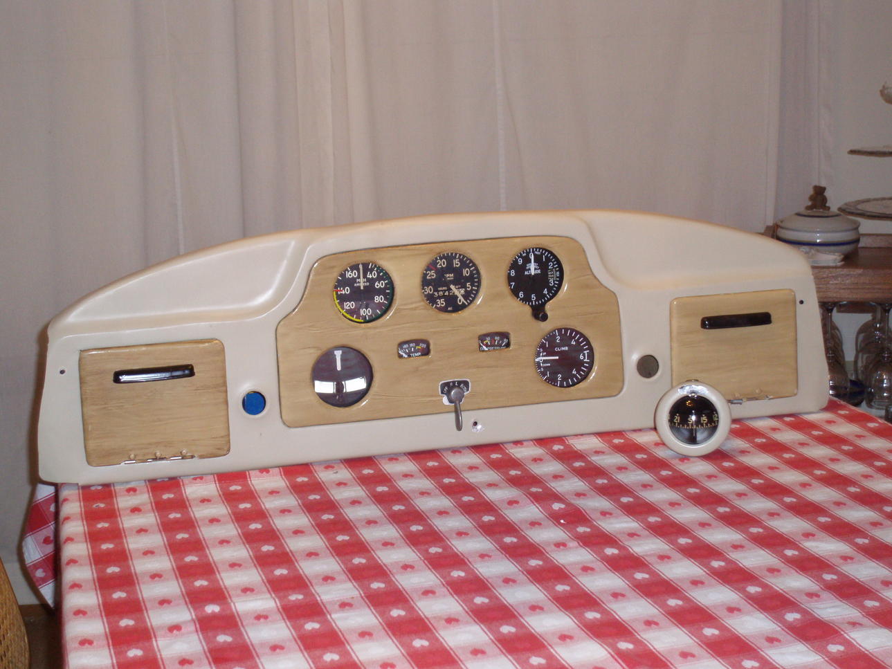

              Are the original inserts and glove box doors wood or metal with wood veneer?
              • #37
                Metal, but I don't think it was a veneer. I'm pretty sure it was painted or printed.
                • #38
                  All were hand painted in Faux finish. I had never done it before and the photos are of my first attempt at Faux finishing. Get a piece of metal and he Faux finish materials from an art store and just give it a try (NOT on your plane for your first time like I did.) I did it on my planes' panel because I had made my panel myself and didn't feel any personal threat I would be ruining an irreplaceable antique part. Since I made it I knew I could strip it back to bare metal and do it again. If is NOT hard, it is NOT skill. It is just patience. I got a really nice piece of wood I liked the grain pattern in (like I would have made he doors and insert from if they were really wood) and copied the grain. I used a few techniques from a Home Depot free class but a few feathers and some wadded paper made for some realistic grain. What i had NO luck with was the curved wood graining tools they sell. All I could get with that was a mess. Grab a chunk of sheet metal and give it a try. Click image for larger version

                      • #41
                        that is impressive, very very realistic. is the dimpling at the guages original or an added touch? i really like it. the one i have does not have the dimpling, only flat metal, maybe mine is an old reproduction? i will be checking with max and dave wenglarz to see about the glove box door
                        thanks

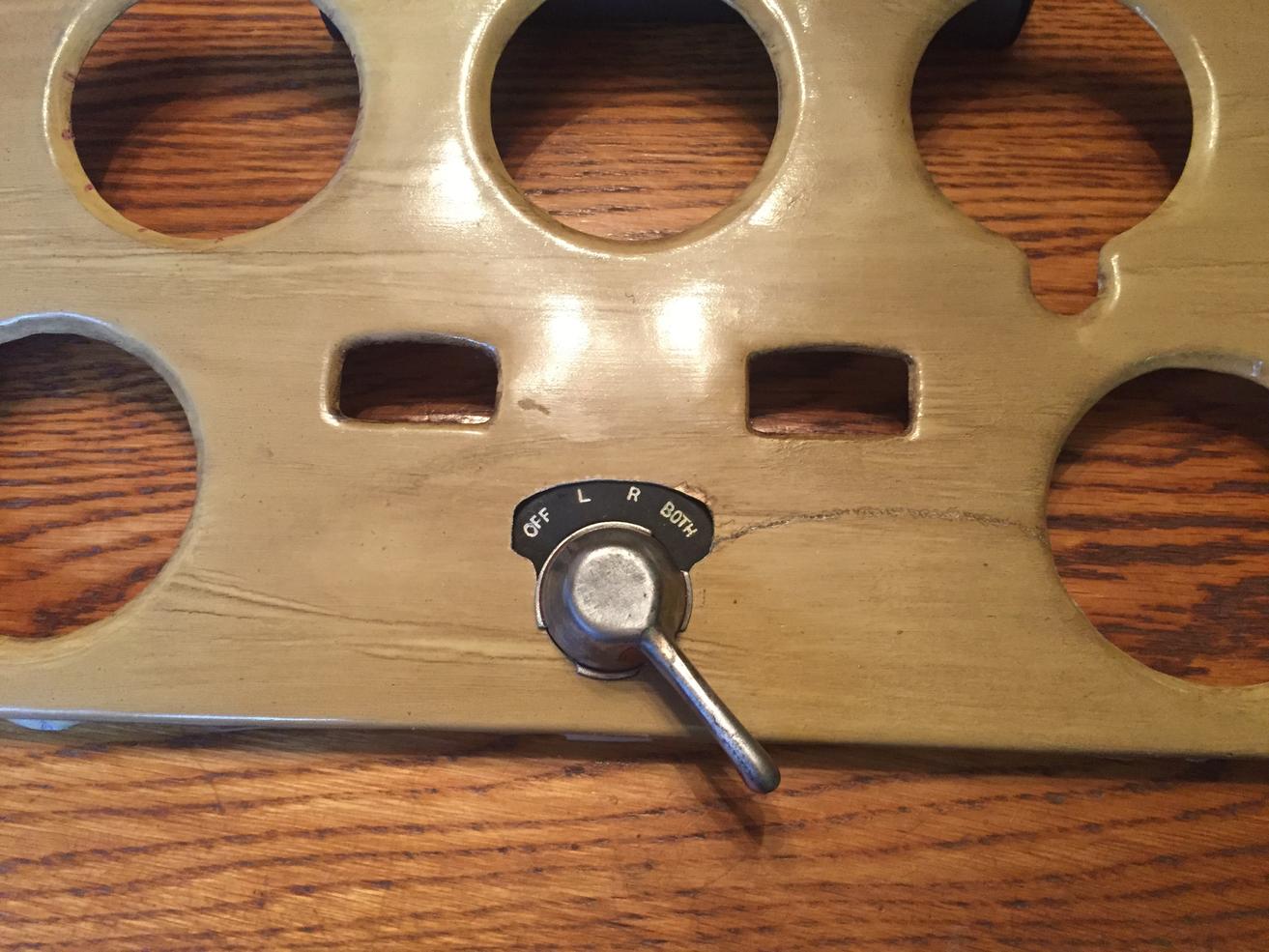

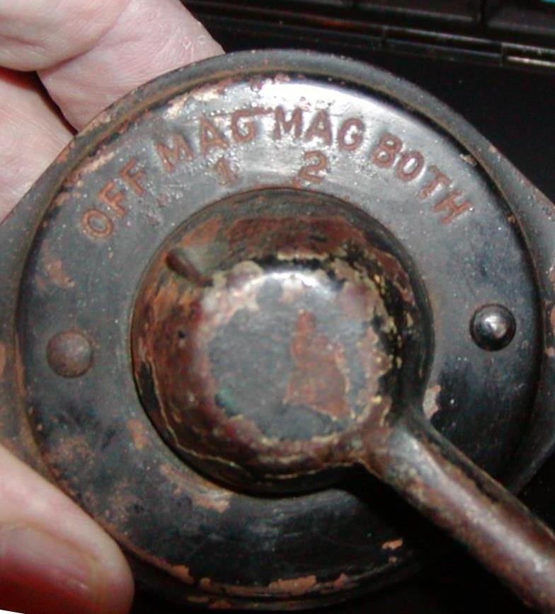

                          Face book is doing it's normal thing. When I type my text first it puts in the photos randomly in different places around the text. Hope it works this time. The left photo is of what the mag switch marking were in 1941. the RH photo is my first shot at a lever and face of the switch that would be behind the insert. I have the graphics corrected now but need to get them engraved and move the Grimes Mag switch in the sub panel so teh lever can turn through the hole smoothly. The printing on the right is for a POST war mag switch and has L and R instead of MAG 1 and MAG 2. I will get there yet. The later stock A-7 with the works removes and replaced with a Grimes Mag switch is a bit easier. I will post photos when I get it working reliably. The later replacement version should be able to be directly replace an A-7 with a keyed lever and look just like original.

                            Just a few of the parts I have been working on. That is the post war A-7 back plate in the middle and one of the levers on a mold top right. The door handle came out GREAT (right before Jim brought me an original!)and the inside lever will be sent off next week (the one that was such a BUGGER to cut the square hole in). That is a Cabin Heat knob I made and will be casting more of them with a BIG project coming to make wheel pant mounts with a welded steel core and replica exterior to make them look just like original cast ones but they won't have the cracking problem of stock ones. That is an original glove box handle and it was "interesting" making a copy and bending it straight as the resin cured so I could make a second mold that produced STRAIGHT handles!
