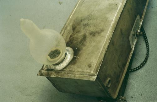

            In that case you are right; replace it! But leak-test your aluminium replacement before installation!

              I got some really funny looks when I did my fuel leak check on the 41. Not as funny as the pharmacist I was trying to explain why I wanted condoms as large as possible that wouldn't burst easily. I needed an opening that could stretch over the fuel filler neck. Of course when I was asking I did NOT do it in a way he would know what I was really doing. When I came back and told him I had photos of the condoms in use it was a classic time. Click image for larger version

                You need to go to the veterinary supply stores Hank. We get them for horses (Clydesdales) that your arm will fit in.
                  Wouldn't have been NEARLY as much fun as our regular drug store! Even better that I bought 3 and when I went back first thing I told him was the first one popped and I was lucky I got extras. I still have the third one. Not sure what to do with it. Been married for 48 years and no kids. I don't think I really need it for anything but the plane.
