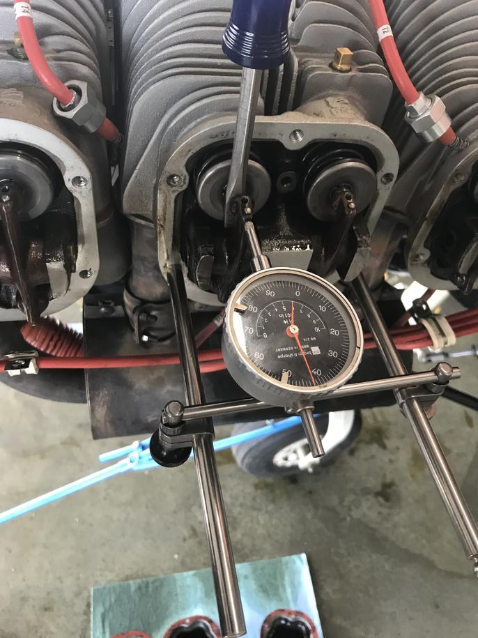

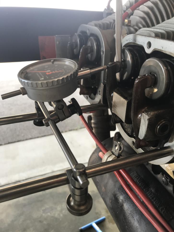

    I didnt want to pull the jugs on this engine, 17 hours since major and it was pushing the rocker shafts through the valve covers at 14 hours. So I used a dial indicator and a wedge (screwdriver) to collapse them at TDC. Most were in the .091-.113 range when they were fully collapsed. I just didnt have enough ass to keep them collapsed and try the feeler gauge method. I sure didnt want to pull the jugs either. Worked like a charm. Tim

            Superior has no solution for the problem, we are going to put shafts with anti friction buttons in. I will email you the videos on how it works, tim
            the spring pressure will collapse the lifter, it takes about 2 minutes, I could not do it by hand with the jug on.
