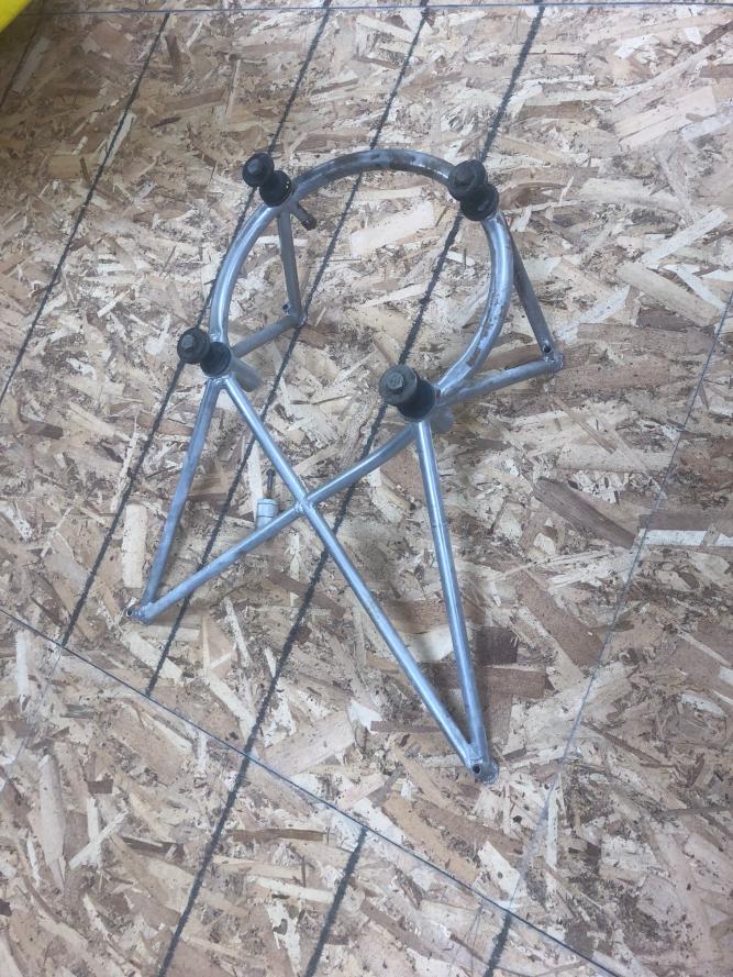

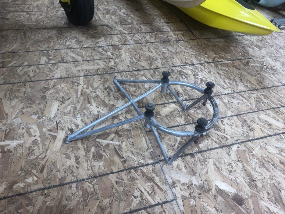

            sorry i was gone all week and back home now
            here are some pictures of the mount
            it came with shims, i am thinking for angling the engine off center line???

              Originally posted by TC747paul View Post
Name:	0235 mount two.jpg
ID:	184403Click image for larger version
Name:	0235 mount one.jpg

                That's not a dynafocal mount. Dynafocal mount all the bolts point to a central point. they are not parallel.
