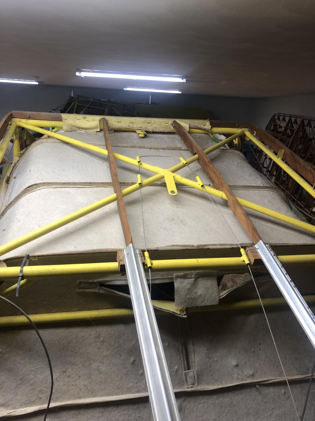

          i do not know what that tab is in the top of the roof on the last picture

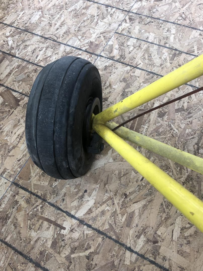

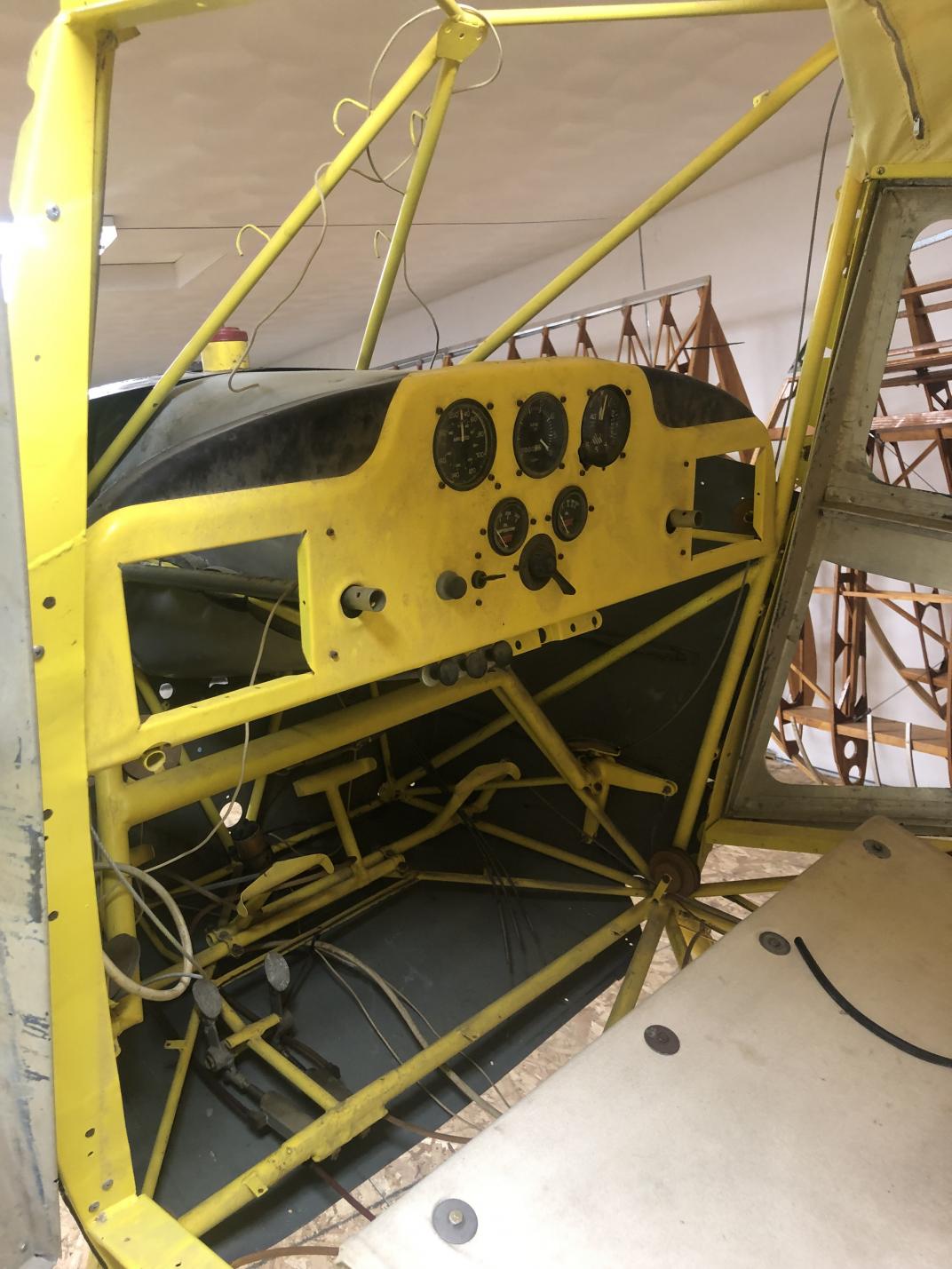

            Well Paul, I see a 65 style header tank it does not have the boat style indicator and a sealed cap. F-22 would have wing tanks only from what I have seen, you would also have toe brakes with cast aluminum pedals from the one drawing I used to have, I think you have a mix of parts or at least some of an F-21/22 or later with some early parts grafted onto the airframe? The instrument panel is an early one with what looks like an A7 magneto switch. I have not figured out what brakes you have, seems like they are hydraulic calipers with some type of heel brake actuator, are they mounted on straight axle shaft gear? I don't know what the tab is for. Hopefully someone else can chime in, maybe an antenna mount?
              F-21 wing is same as F-19 except it has slightly taller spars. F-21A is quite a bit different more like the F-22
                That is not an F-22 fuselage. Everything up front is wrong. Shouldn't have heel brakes, header tank, or that instrument panel. The door jambs or wrong for F-22, they are wider. Should also have a more conventional style seat like a 150 too. Start looking for the serial number on the door hinge.
                  The tab is for a panel light.
                    I didn’t think that it looked right, maybe an f19?
                      Looks to have hydraulic disc brakes...possibly a conversion?
                        No, F-19 has toe brake as well
                          maybe F-19/21 gear but thats it.
                            So it's a bit of a hybrid.
                            I guess the logbooks would make interesting reading, eh?
                              it is listed experimental, so it looks like i am the proud owner of a bit of a mutt. the seller called it a F22 so i went with it. i like it all the same. It did come with a 0235 mount. The big thing is get the wings done and fitted,. i will check on the serial number on the hinge areas. is there a specific location that is more apt to have the number?
