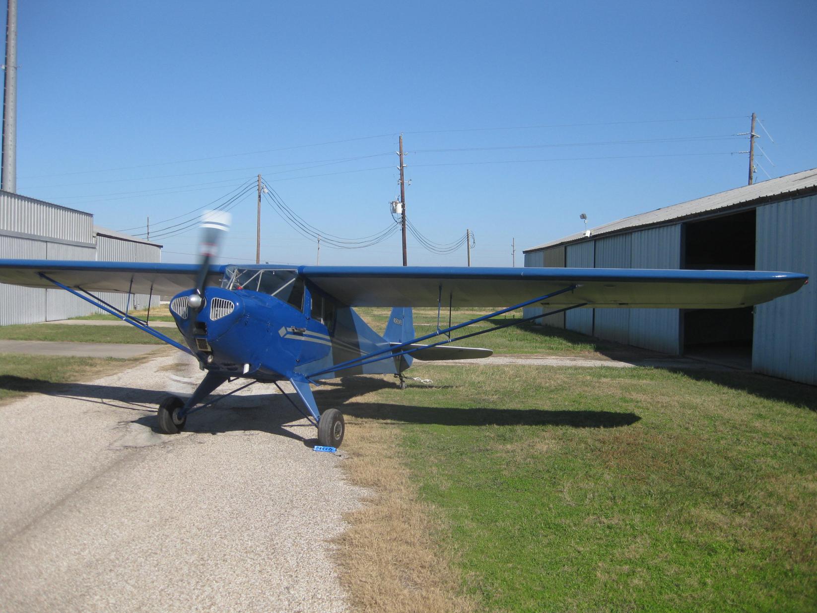

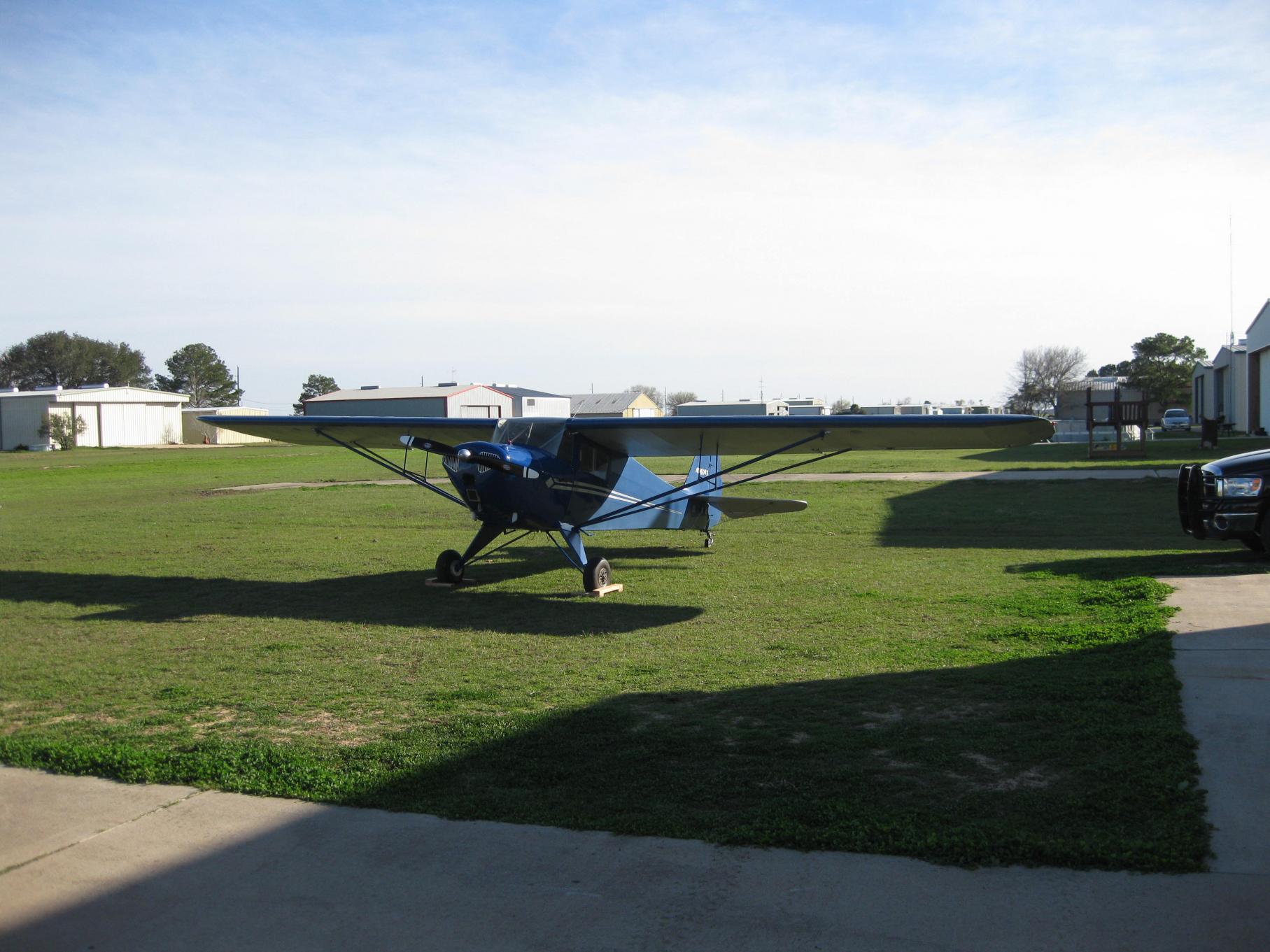

    Acquired this beauty from a good friend that I helped with his restoration of her back in the mid '90's. He always promised me first shot at her when he decided to let her go. I took possession back in October of 2008. Lots of little projects to get her in tip top shape. Brought her home to Texas last October. 28 hour flight from Redmond, OR to Houston (Brookshire), TX with my wife of one year as my copilot! More to follow.

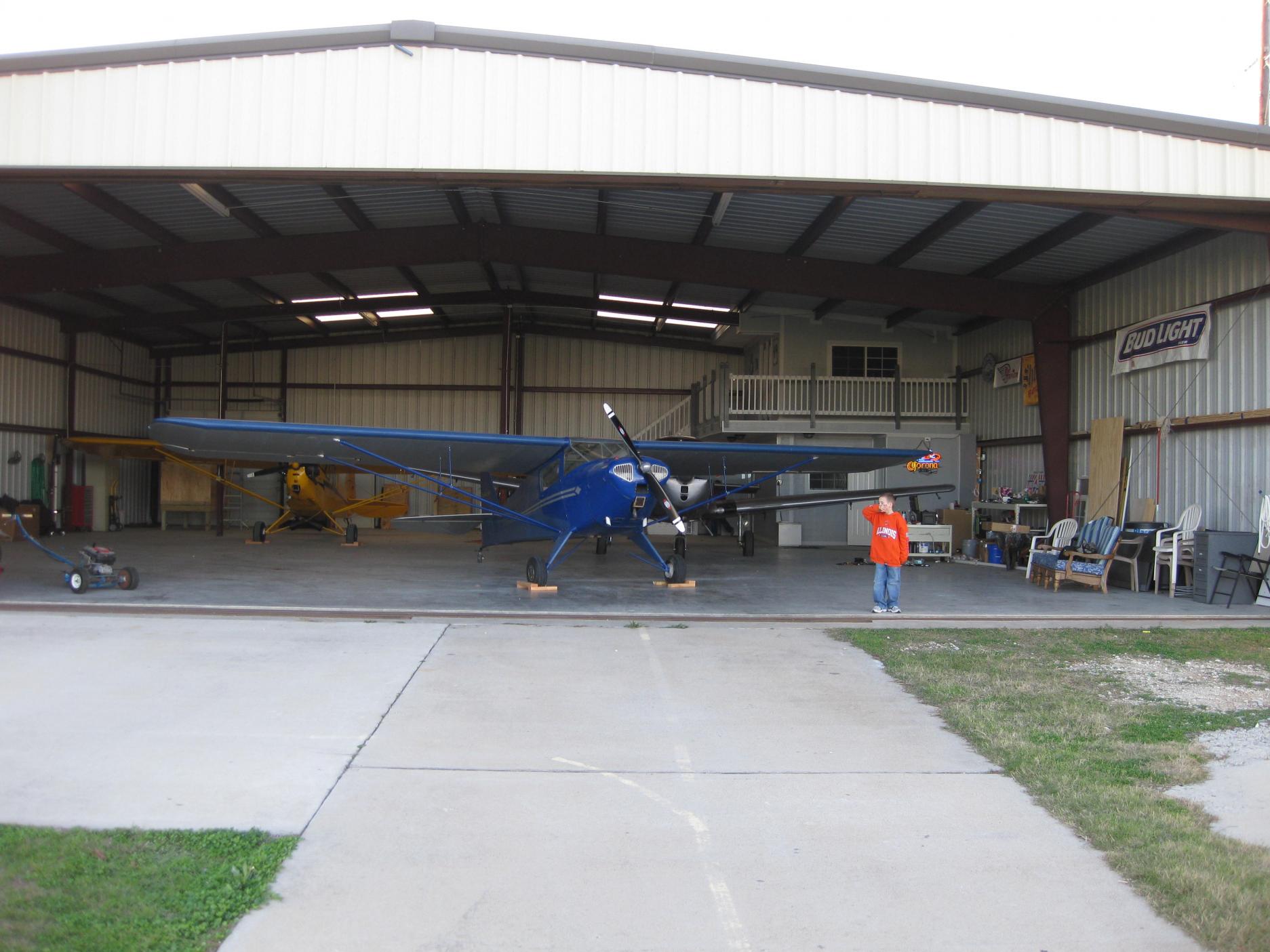

    Thats a really nice lookin bird. Really nice hangar too. I hope to meet you and your wife at the Fly-in in March.
      Re: N96043 1946 bc12-d
      Thanks Terry. Really hoping that we are able to make it too. If we can have a couple more wet weeks of weather I think we will be there!?

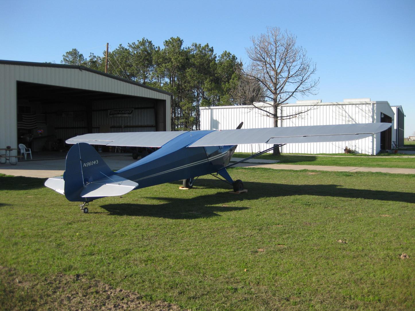

        BTW, the Navion and J-3 belong to my hangar mates (and the C-185 not shown). I am renting a spot in the hangar on Sport Flyers Airpark (27XS). So far a lot of great 'aviation' folks there! Really nice place to be with a Taylorcraft.

          My first thought when I saw your pics and all that grass was: I think I could like this place! L

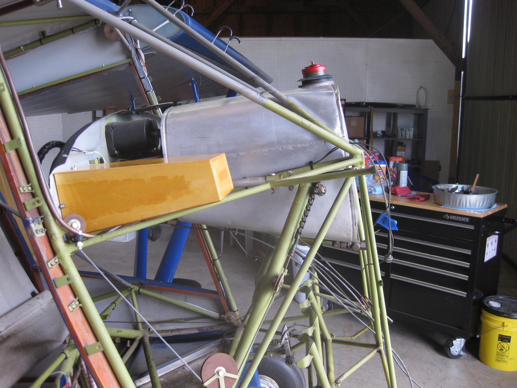

            Doing a little sprucing up?!

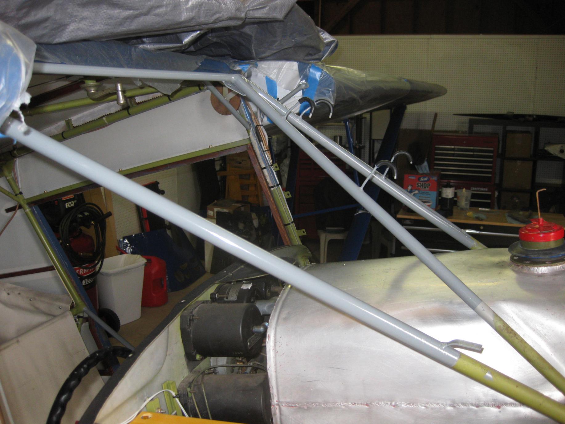

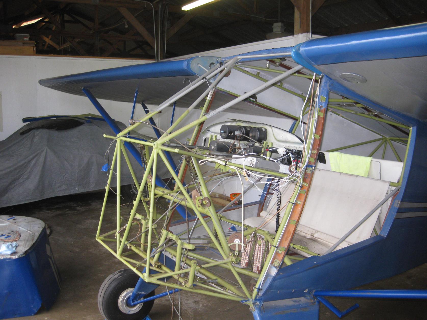

            Time for the annual and to address a few items that were creeping up. Short List:
            Replace leaky main fuel tank (note Hank's recommended test of new tank! :dance

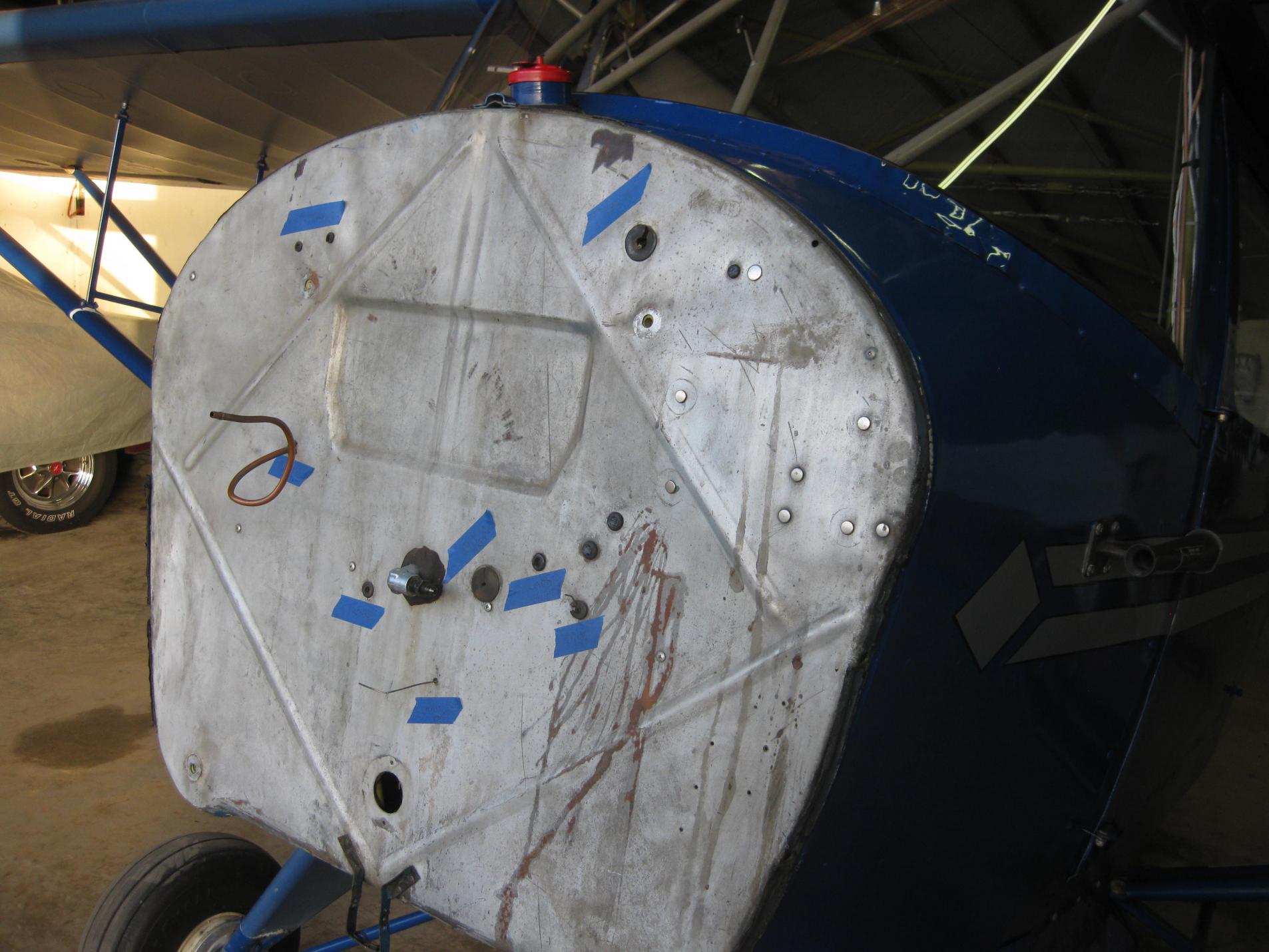

            Replace cracked/patched bottom sheet of boot cowl
            Replace patched/drilled glare shield
            Replace bent and worn floor boards
            R&R bungee cords and safety cables

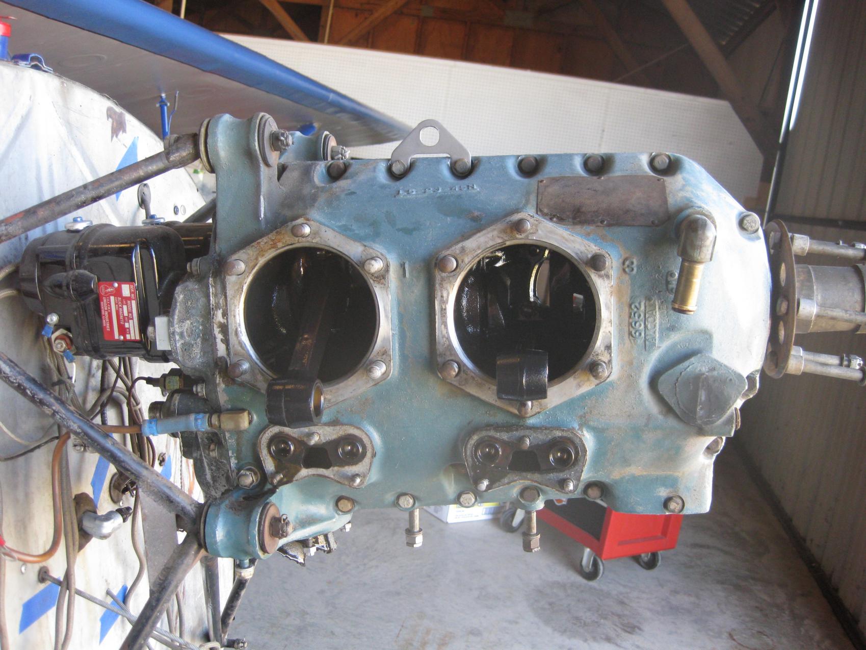

            Overhaul three cylinders (did the other one last year)
            Clean up and repaint numerous items to include struts, tail brace wires, window tubing, engine and mount, etc,,,

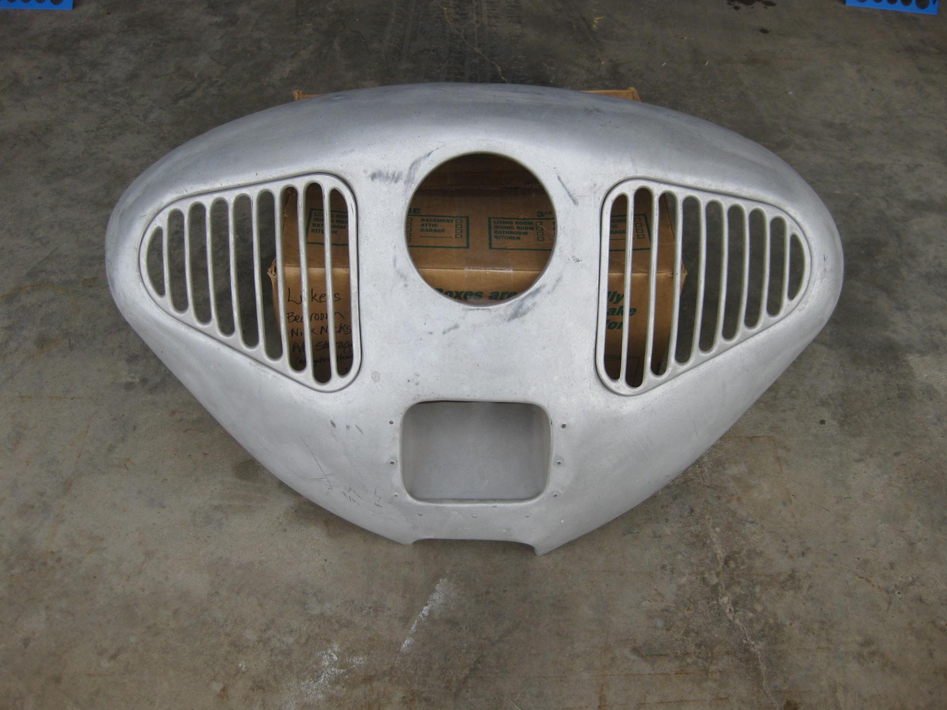

            Replace all cowling from the firewall forward to include a NOS nose bowl! :tup:
            Lots done but much more to do, a few pictures of the process.
