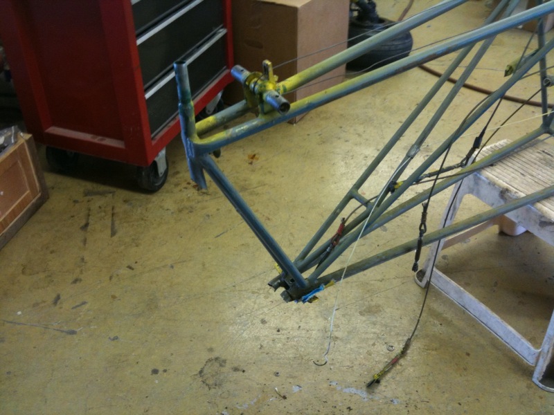

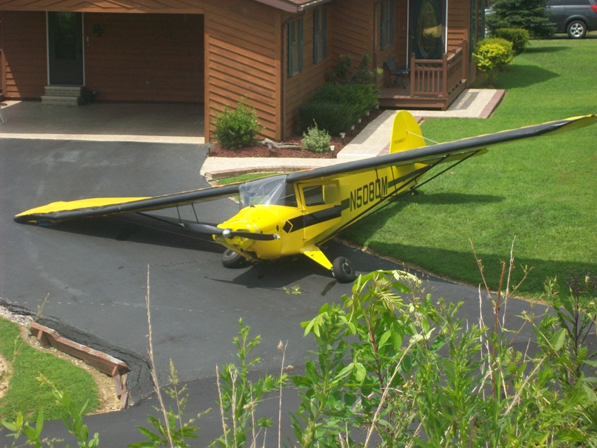

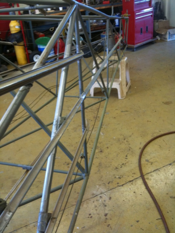

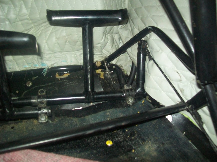

    Here's a few pics I took yesterday(and an old one or two) as we unloaded and reloaded the fuslage(it was on the trailer backward and had to be turned around for transport) of the t-craft that over ran the runway at my place last weekend. We had to turn it around for transport to it's new home in Ashland,Ky(DWU).I'll let Dave(plater) continue this or start another thread when he returns.

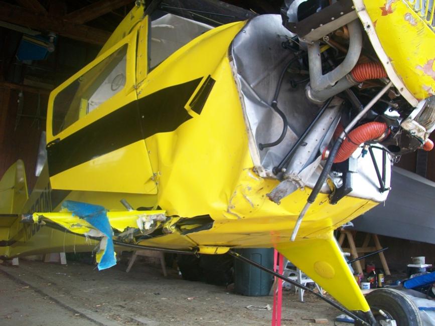

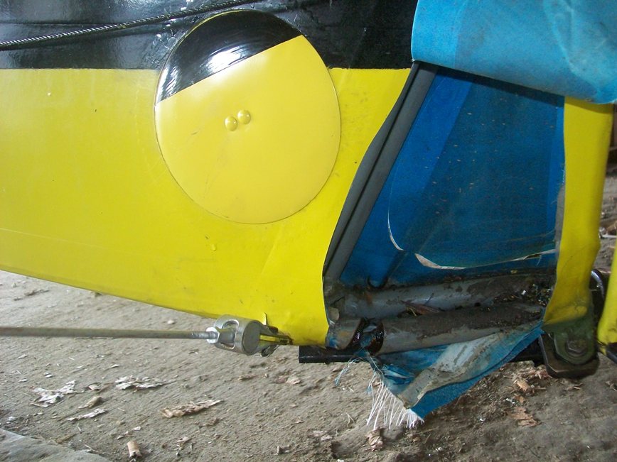

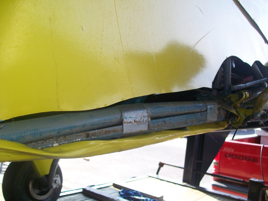

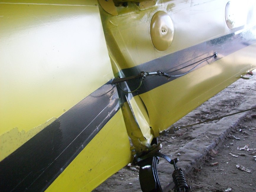

          Just posted some pictures of the damage to the fuselage. We removed the tailwheel today. Both tubes where broken. Going to measure and order replacement tubes tomorrow. I didn't take pictures of the right landing gear. Not much left to take a picture anyway !!!! If anyone knows where I can get a right landing gear please let me know!!!

            She looks like a VERY restoration project! Looks like everything is in nice shape too. Whoever did the work last time did a nice job.
