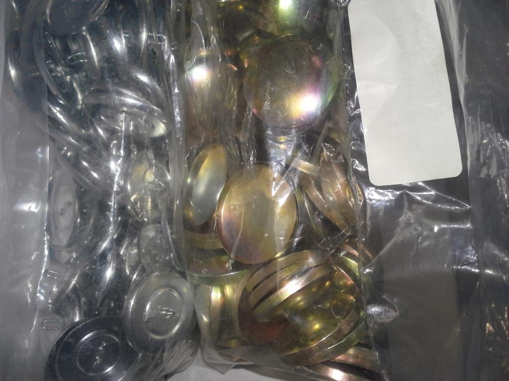

              Today I happened upon a new revelation in the age old banjo center cover dilemma. I happened to walk past this package while shopping in an upholstery supply store. [SEE PHOTO] These things are identical to the Taylorcraft Center cover, but they were a smaller size. The store had several sizes but not the same size as Taylorcraft. So I asked the shop manager about it and I learned something new.
              THE GOOD NEWS IS: The mystery is solved. The center cover is a standard item known as a #95 Brass Upholstery button shell. Below is a link that illustrates the sizing and concept of the upholstery buttons.
              http://www.ccmetal.com/catalogs/dyna-line.pdf
              THE BAD NEWS IS: So far, I cannot find any supplier who makes the size 95. Also, I think brass is no longer available. All I have seen are either cad or zinc plated steel or aluminum.
              So I've done a little searching online and came up short. But my hope is that maybe by getting the word out to all of you resourceful Taylorcraft restorers, maybe someone may stumble across a source for these.

                I made a bunch of upholstery button at my dad's shop 30-40 years ago when I was a kid. I knew the shape was the same, but never saw any that big or made of brass. I'll ask dad when I talk to him tomorrow.

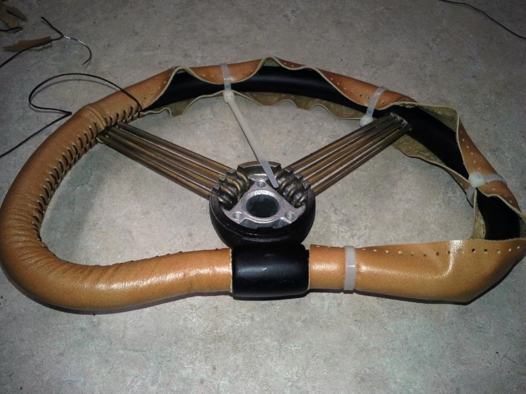

                  Re: Banjo wheel center cover Just did my first ever leather cover with baseball stitch.

                          Where did you get the supplies to do this, Terry?
                          Did you sew it on while wet? Or dry?
                          Tim Hicks
                          N96872
                          • #43
                            Tim. Leather came from a local upholstry supply... they were scrap cutoffs. Waxed lacing cord came from tandy leather online. Also bought from tandy a nice little tool to punch four 1/16th inch holes evenly spaced. My wife has a great roller razor knife that she uses for sewing. It works great against a straight edge for cutting leather. I did all the work in the dry condition. Baseball stitch does a great job of sinching it all to the correct taughtness.. the leather aroma is quite relaxing and helps prevent frustrations as I normally get when doing tedious work. Once yoy practice a little and learn the correct width to cut your leather, you're ready. And once you start, you become so obsessed to see how cool it's going to turn out, you don't want to stop.

                              I finally talked to dad about the upholstery buttons. In his opinion while similar they are not repurposed upholstery buttons. The hub centers have straight sides and the buttons have tapered sides. He thinks that the hub centers were made specifically for the wheel.

                                Here's a photo of the work in progress.
