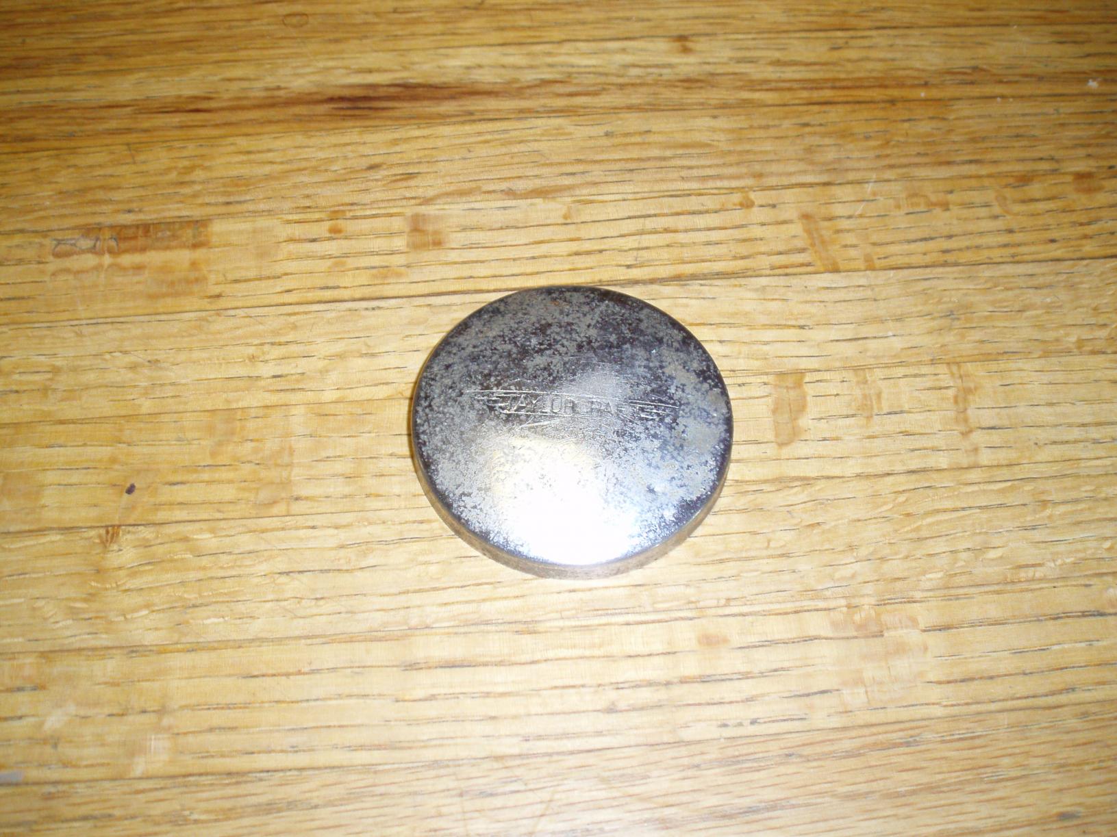

    You guys know me well enough to know I tend to loose stuff in the pile on my Taylorcraft so this is another one.
    Someone on the group had a lead on getting new center covers for the pre war banjo wheels and needed one for the manufacturer to copy.
    OK, so I found the old wheel I have (I need a second one if anyone has one laying around!) and got a box to mail it off, but I CAN'T FIND THE MESSAGES from the person who needed it!
    Whoever you were, speak up and get me your address and I will ship the cover off.
    Thanks

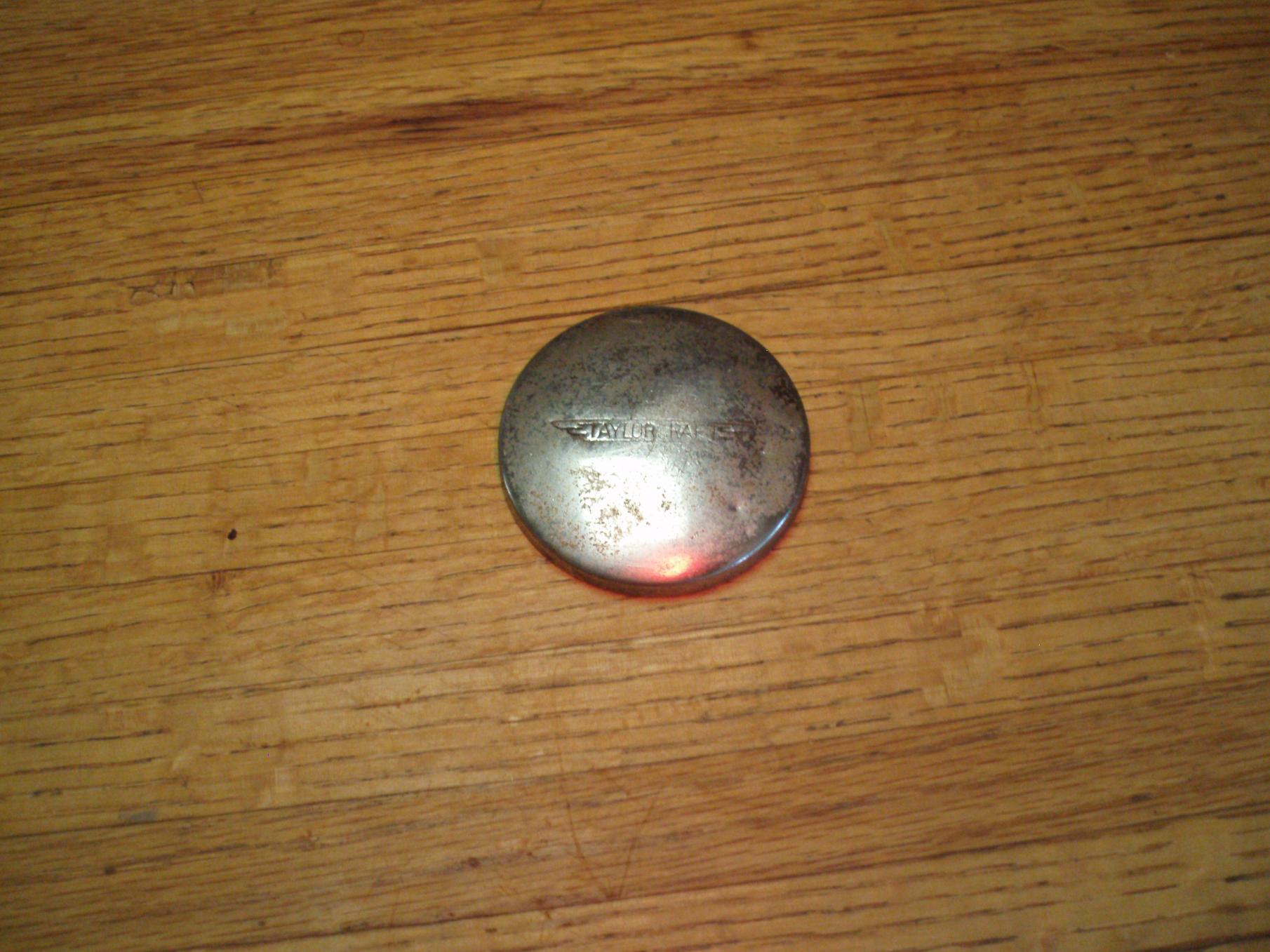

          I will try and ship it this afternoon or tomorrow morning. If anyone lives near a "Tractor Supply" I was told that they were originally made from tractor engine block freeze plugs. The plugs were dome topped and 2.43" (2 27/64") OD and the lip is ~1/4" with just under 1/4" of "dome". The metal appears to be Brass with a Nickel plate put on after the "Taylorcraft" logo is stamped in. The metal is about .020" thick.
          If anyone can find a freeze plug like this let me know. Starting with that could REALLY drop the price down. Then Mark and I can compare his stamping of the logo to my getting them engraved for price and appearance after plating.
          Next step is I only have ONE wheel! If I can't find another to restore I am going to have to start working on making a whole replica wheel.
          Some one STOP ME, PLEASE!!! That wheel is going to be a NIGHTMARE to make from scratch!

                        The original one I have is ~.020" thick and is brass with what looks like Nickel plating on it. It was NOT a car freeze plug from what the old time car buffs have said, they were used on farm tractor engines. Remember that Prestone was invented and used in WW-II and before that freezing blocks was a common problem. They used BIG freeze plugs to prevent the block from breaking. From what I was told, farmers would drain the water and oil in the winter and bring them inside with them. In the morning they would pour the warm oil and water in the engine before starting. I have pictures somewhere of German mechanics with pails of coolant and oil next to their stoves trying to keep them warm so the Luftwaffe pilots could get their engines started in the mornings.
