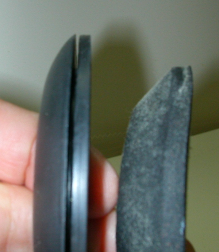

        The best part of the grommet I referred to is is actually seals around the neck and the cowl. Less chance of spilled gas getting in the cockpit. The plunger grommet and the ercoupe grommet still allows fuel to work its way down and into the cockpit.
          Re: Fuel Tank Filler Neck Grommet
          I used the Ercoupe grommet from Univair (their p/no F40430, now $13.18) and it worked fine, albeit fiddly to get on (easier to fit the grommet to the bootcowl first and then llift the tank into position).
          Edit: The Ercope one I got was more like the one to which Marty refers (i.e. the left one in the photo below). Perhaps Univair have changed their source.
