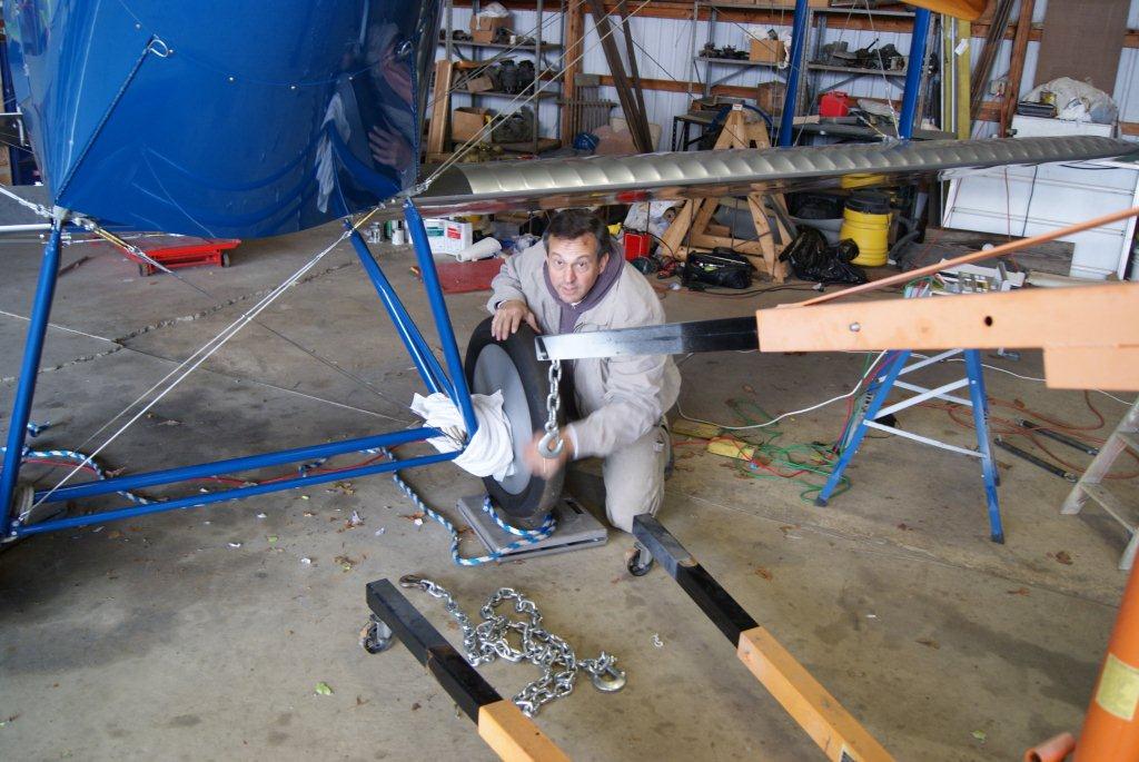

              OR you could stop by Alliance. We have electronic ones that we just used on a Taylorcraft; an Affordaplane and last week the WACO 9. I too have used the 300# scales with bridge , checked against a calibrated one at the feed mill.

                          I have a set of the longacre scales, weighed a taylorcraft last month in 30 minutes. It took longer to get all of the measurements for the arms than to actually weight. The TCDS said the tailwheel is 197 inches and measured 201. Tim
                              Yes, it is important to actually measure your arms & NOT use the TCDS values.
