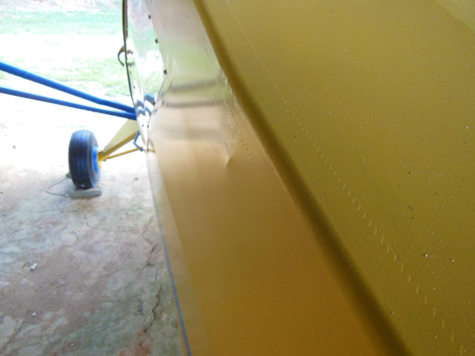

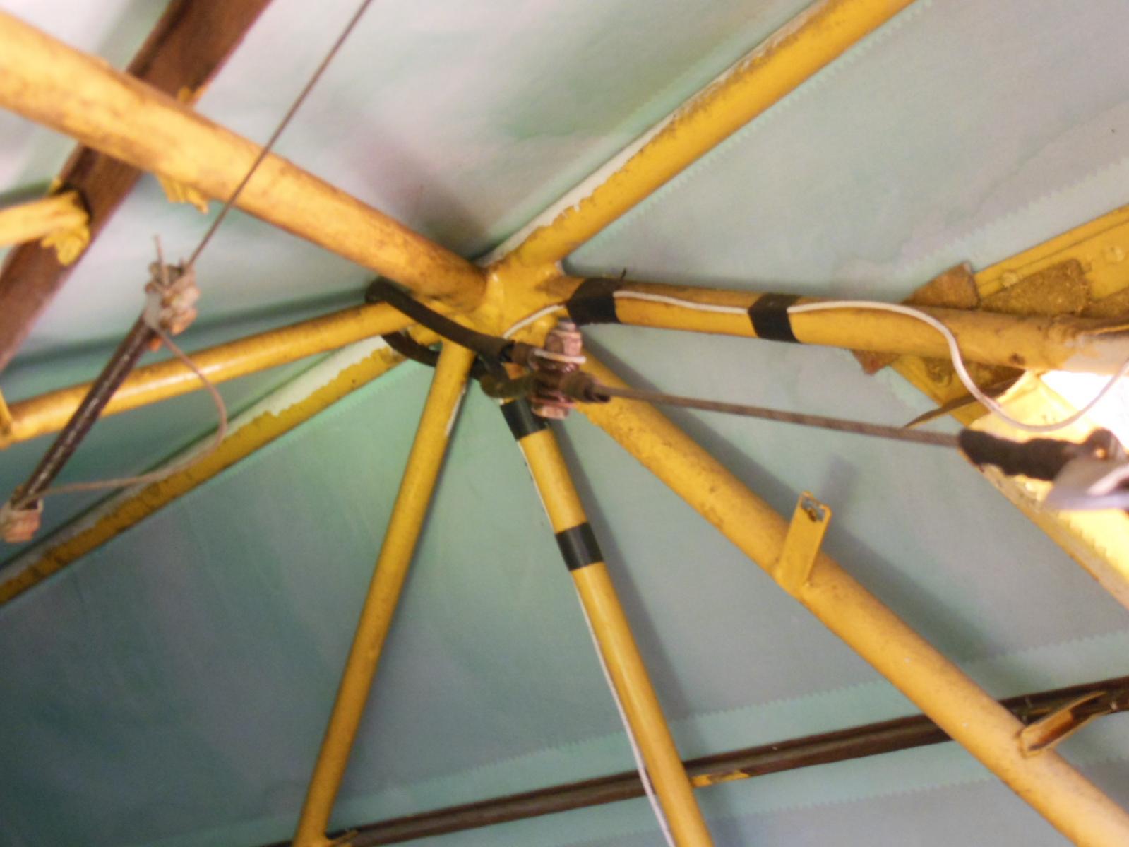

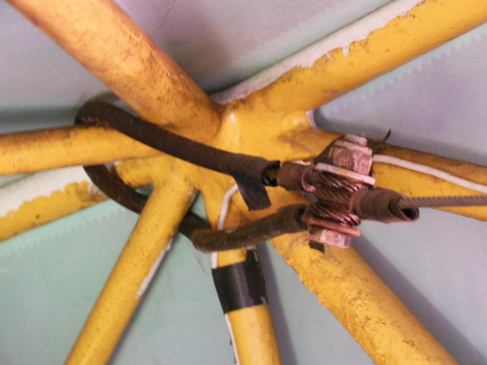

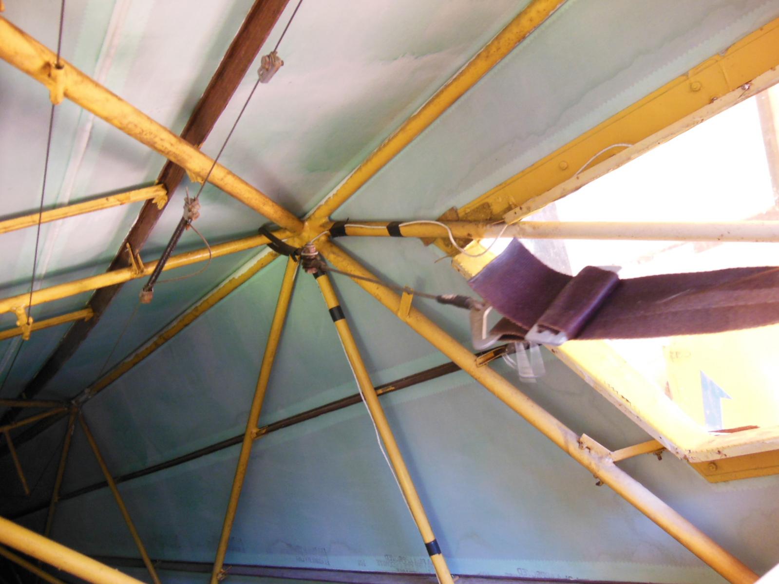

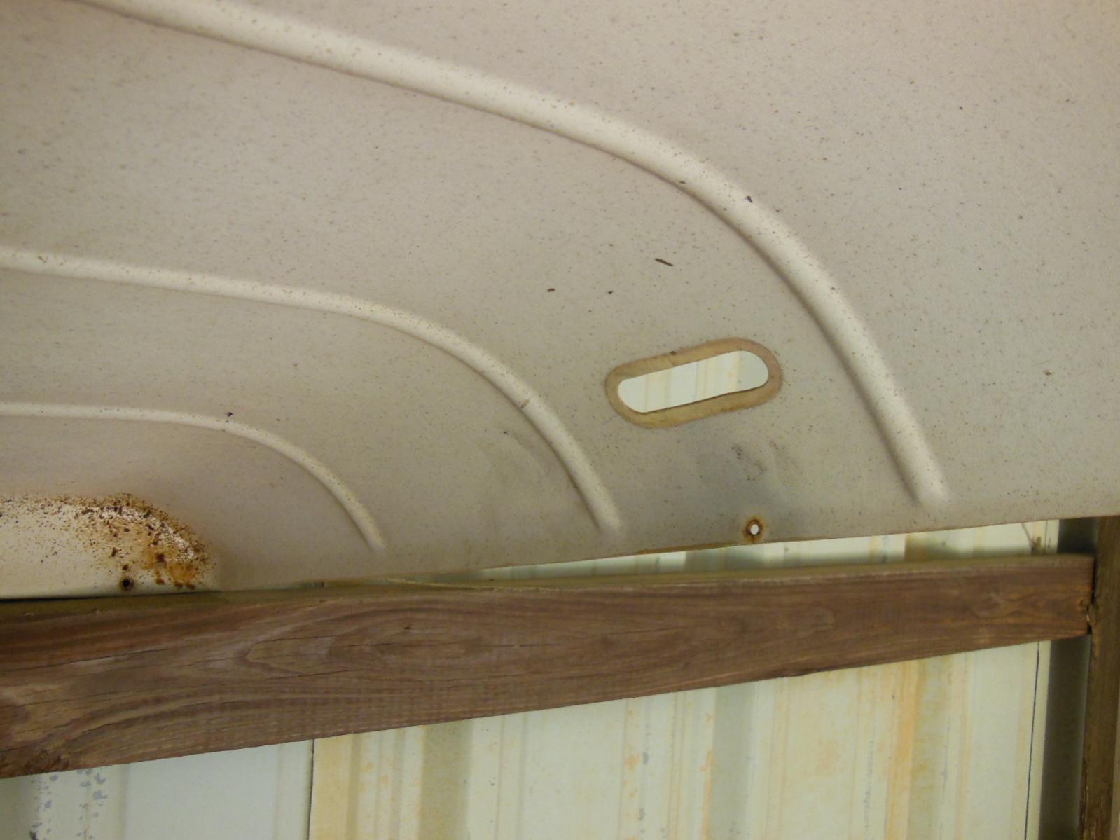

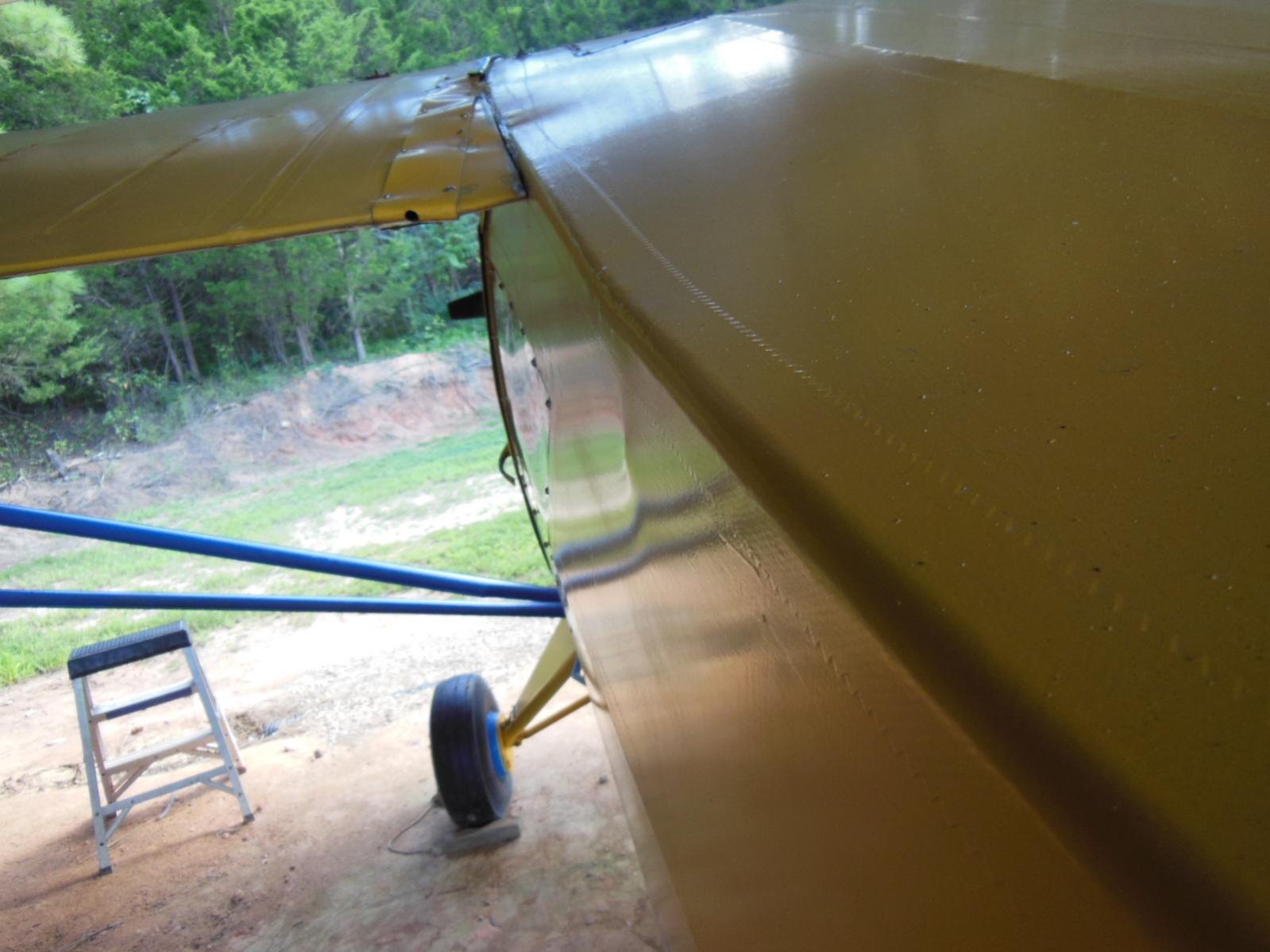

                                My harnesses are from an F21 and the rear headliner is as well.
                                They attach to the cluster in the picture by a cable covered in vinyl tubing and wrapped around the cluster. On an F21 the same cluster has a plate welded to it that has a hole that the longer cable bolts too.
                                The cable comes thru the slots shown in the plastic headliner section.
                                The wrapped cable makes a small bump that can be seen in the fabric on the outside. There are 2 pictures of that.
