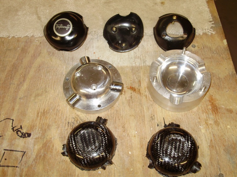

    Here is our rendition.
    I am going to play with these molds and see if I can get decent results. I'm not sure of my fiberglass skills but it is worth a try. Originals appear to be injection molded.
    The graphite hub was done by a local company using this mold. They are not perfect, but they can be easily cleaned up and used.
    Note the originals had threaded metal plugs to hold the screws. I would probably consider threaded epoxy plugs.

      Mark, those are BEAUTIFUL! I want a pair for my 45, how much? Remember to NOT clean the flash off or fix the pin holes (if any) or cut the holes out. If someone wants to challenge our use of them we want to be able to do a substantive part of the work so we can call them "owner produced".
      I think I will do a drawing and QA plan too, just to be safe (and anal, as usual).
      Also looking forward to seeing the tube end fittings "NY86" (I wish I knew you by name instead of just as NY86) is looking at casting. I need a set of those too.
      Who wants to stamp coins and who wants to do the silk screening? I have the negatives for the center logos made from an original.

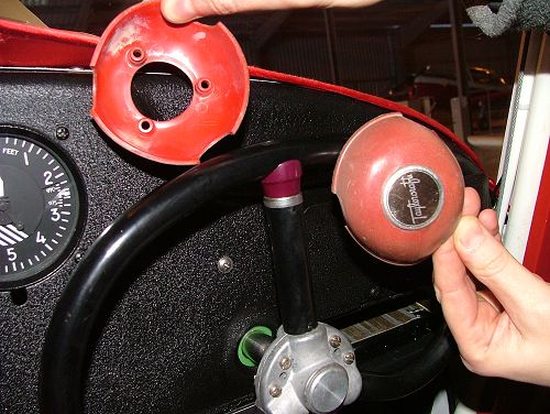

              Here's my two hub pieces against the rather maroon of the new-ish Univair Ercoupe pretzel yoke. You can also see the bare aluminium structural hub that I am living with at the moment.
              Given the choice of colours so far, I think I prefer the richer maroon to the scarlet shown in Ron's photo.

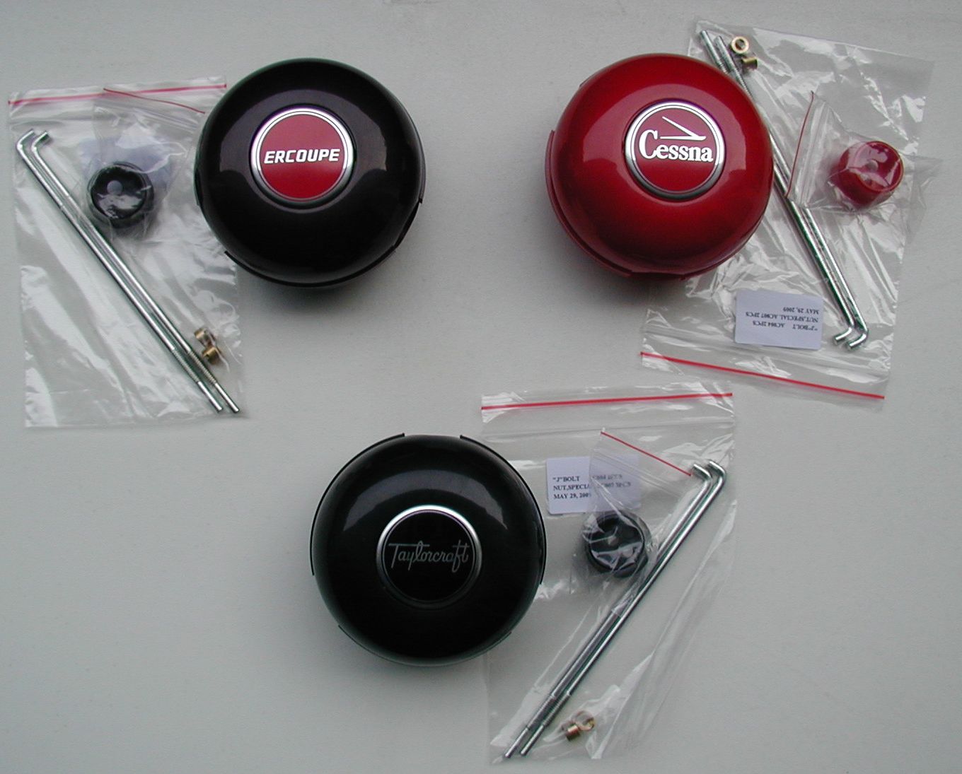

                            We made a couple of improvements. The covers are thicker material than the originals and there is an interlocking edge to help prevent the distortion present in the originals. All new hardware is included.
                            We also made a kit which includes the plastic trim at the base of the center spoke and the hardware needed to replace it. Note that you will need to remove one of the taper pins holding the yoke to the shaft in order to replace this trim. The hub cover can be replaced without removing the taper pins.
                            Disclaimer: Please note that I have made a significant investment in tooling to make this happen, and I am in it to make some money. I am pricing them at what I think is a fair price for both parties. Contact me via e-mail or PM if you're interested. I can supply any of the three colors with the Taylorcraft (black) logo cap.
                            The picture is best viewed full size (click on the thumb nail, then click inside the picture then click inside the picture in it's own window). The Ercoupe cover is maroon, not black...
                            (They are so shiny I had trouble getting a good picture, but I think they came out great!)
