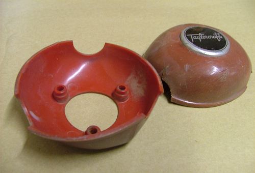

                          Here's my rather misshapen, faded and generally manky hubs from my 1946 BC12D.
                          Points to note:
                          1. The "button" is indeed black on silver, but how original these are to my aircraft is a moot point.
                          2. Like Hank's, the outside has faded somewhat, the inside shows a much richer red (maroon, John?) than that of Ron's rather scarlet appearance (his hubs, not him!). Is this a quirk of the camera? I bought new Ercoupe pretzels from Univair a few years ago, and the red of the inside of my hubs is much more akin to the red trim pieces on the yokes (see the difference in Ron's photo).
                          3. My 1945 (ex-1941 BC65) has black hubs. So it appears that at least two colours were used at some point, unless black was used originally, and then in later used the Ercoupe maroon was used as a replacement? I'm sure the drawings would show.

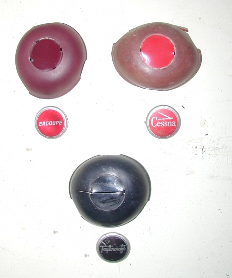

                            OK, here's where I think things stand:
                            Ercoupe: Maroon with Red emblem
                            Cessna: Red with Red emblem
                            Taylorcraft: Black or Red with Black emblem.
                            As of noon today the centers of the plastic pieces had not seen the light of day in over 60 years...
                            Unless somethoing else comes up, I'll pursue three colors of plastic parts and one color for each emblem.
                            Also looking into making the small colored trim at the base of the spoke for a complete restoration...

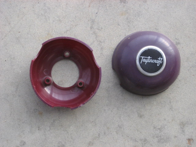

                                I have a near perfect pair of maroon faded to a nice purple. The company that made them is perfectly legible on the back with a patent number so make sure it is not in effect (which I doubt) before proceeding.
