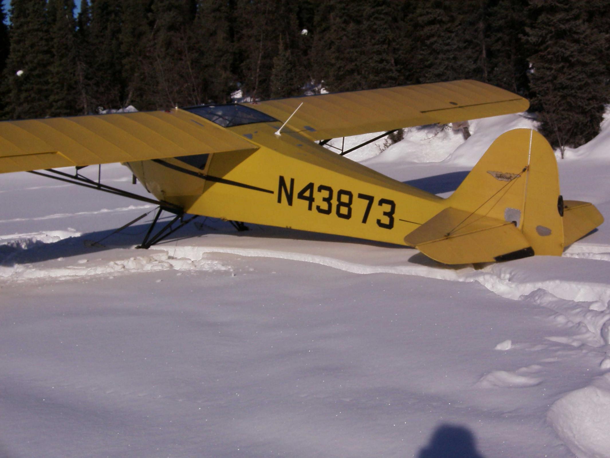

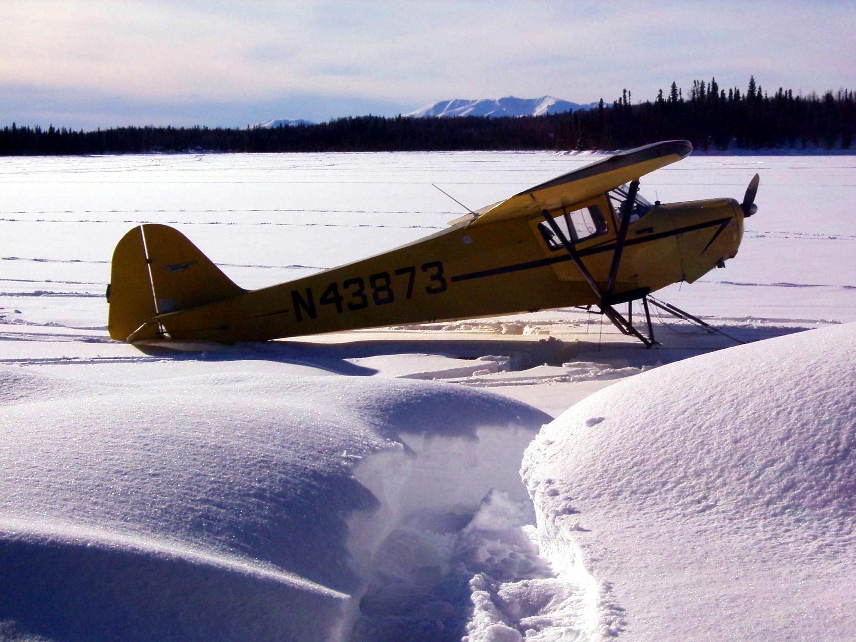

            As far as skes more power would be great I have the 90 in mine Ive takin
            off in 4 ft of fluffy stuf but i pack a bout 50 ft with the snoe shoes never had a problem. Its not as bad as overflow thats where the 150 would be the ticket...
            These are more normal conditions
            Lance Wasilla AK
