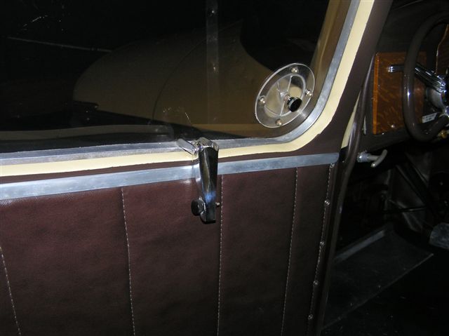

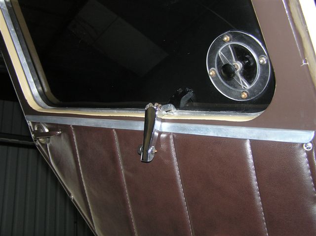

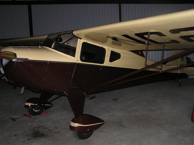

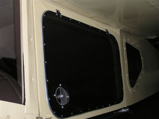

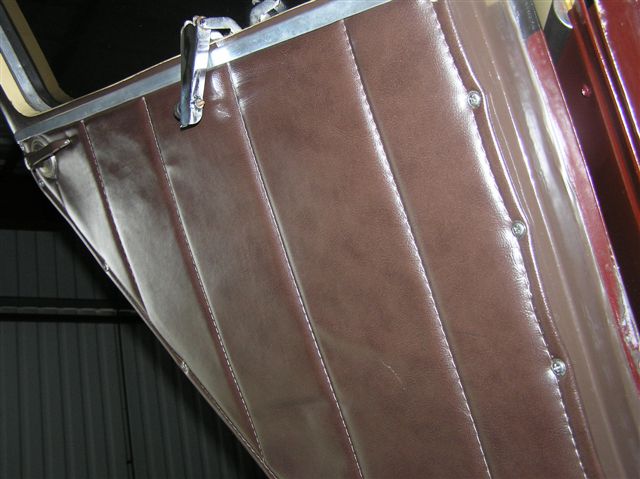

                          Colin,
                          Here are some pictures that my wife took for me-Will try to take some more detailed when I go to the hanger next and check why I cant get them to send to you.
