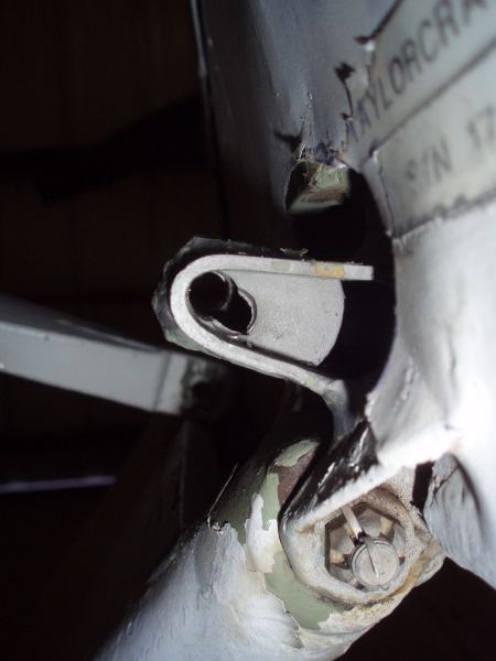

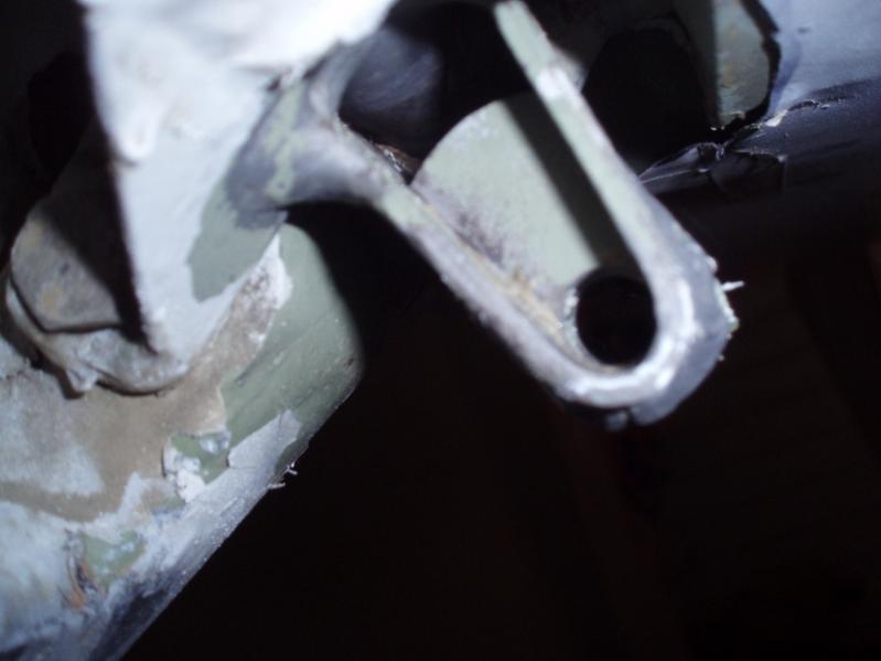

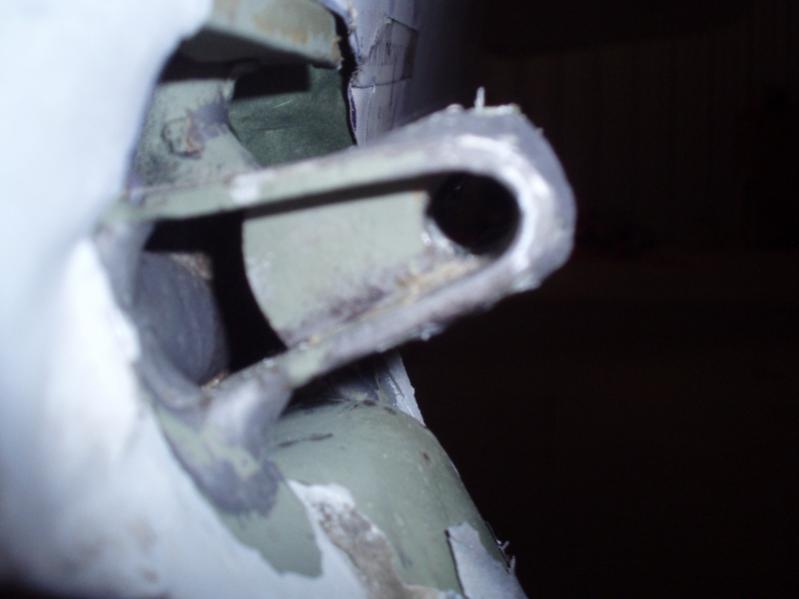

                    Lift Strut Fitting Hole Elongation
                    Guys,
                    I've just finished blasting the exterior of the left lift strut fitting and I found this scenario:
                    the rear strut fitting lug is torn as though a compression load was imposed on the back strut. The bolt came out easily enough (with the wing propped up) and is not bent in any way.
                    I put new struts on it per that AD. The old strut wasn't kinked or anything.
                    Has anyone else seen this sort of damage? Am I looking at replacing the fitting on that side?
                    Thanks,
                    Josh
                    NC24369
                    Reposted with new photos. Looks almost like a manufacturing defect or maybe like someone tried to drive a bolt through the fitting from the back. The last photo has the bolt inserted. There's no play in the aft fitting, despite the odd malformation.

                    • #70
                      Re: Wing Strut attach fitting A-A11 Inspection results
                      Hi josh, Does it look like the missing material was worn away or a piece fractured out? Odd.
                      20442

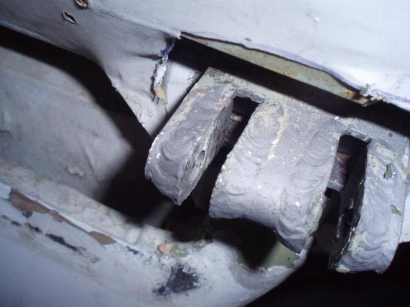

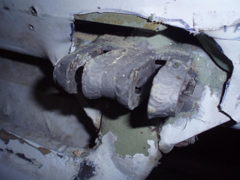

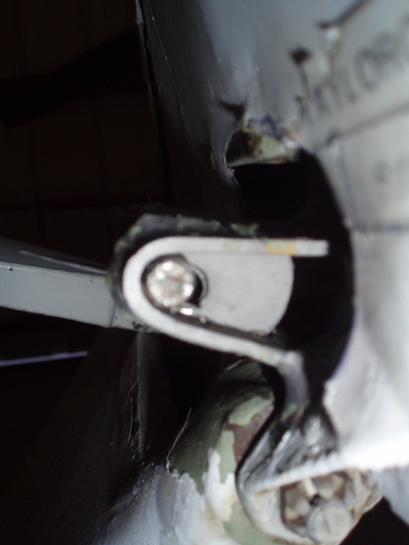

                          It seems like I'm always late to the dance. But I'll try to attach some pictures from my strut attach inspection. Passed.

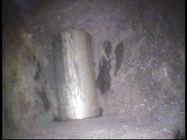

                            • #74
                              First time writting to the site, have a question. But first let me say it is fun and informative to see what you all write about all the subjects. I have a 1946 BC12D that I rebuilt after my wooden prop came apart at 2000 feet above a small town here in NE Tennessee. A whole lot of shaking and an uneventful landing in a field. Wing rebuild, rotten spars, and a new paint job plus a little more and it flew again. I did the inspection on the attachment points and it looks real good, passed. Sorry to go on and on, now for my question. We inspected a 1941 Taylorcraft here on the field and there is no corriosion on the fitting but there is also no tube in the center attachment point? Were the early attachments made without the tube for the bolt to pass through or do we have a problem and if so how can it be repaired? Any information would be appreciated.
                              Thanks,
                              MTH
                              • #75
                                Mike,
                                Mine doesn't have a tube, either. As far as I know there is no tube in there-- are you going by the picture with the bolt running through the fitting? Could that be what you're seeing as a tube, or does the one you've got have a tube there?
                                Seems like if there was anything there except for a bolt and the strap around the outside of the fitting, you'd have a hard time getting behind it to remove any corrosion.
