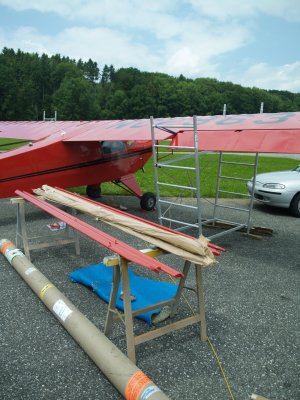

                  Nice and clean, but curiously somehow different from the illustrations in the service bulletin.
                  Is this SB/AD supposed to indicate something about the wall integrity of the lower longeron tube where the attachment fitting is welded. I imagine the attach fitting brings a substantial piece of rotten longeron with it when it tears off.
                  I must be missing something?
                  New struts installed!
