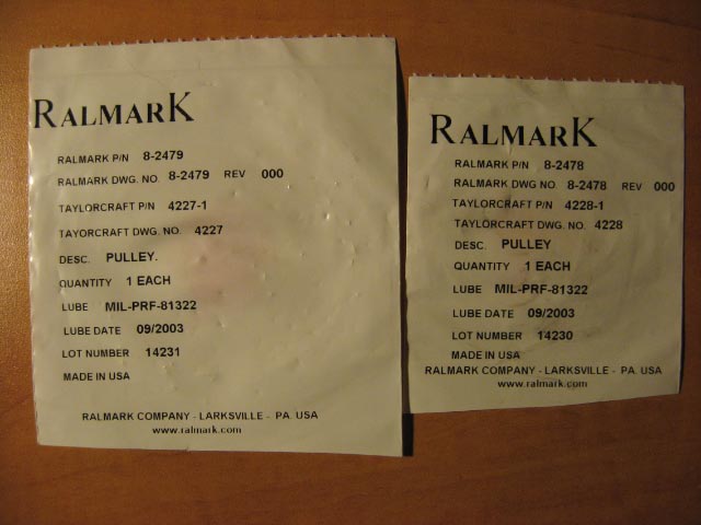

I have not been able to find replacement pullys. I would like to find the name of the manufacturer the the now defunct factory was using. DOes anyone have a part number or name. Univair, wicks ect. don't seem to have the corect size.

Re: pullys
I purchased several from Harry in Texas but they were always giving me a little runaround about the delivery. Thankfully, they never jazzed out my credit card.
When they were giving me the runaround a couple of years ago, I called the pulley manufacturer and they said that contractural agreements disallowed them from selling direct. They don't have them in stock and make them to large order.
This is definitely one of those things that could be purchased in quantity and eventually sold off for a profit by any concern. Univair would trade them for gold bars, probably, if they agreed to start stocking them again.
I eventually had to drive up to Dart Field in New York state to beg for some used but serviceable pulleys.
The new bearing style are definitely desirable. They will last forever.

Re: pullys
I contacted Ralmark and the pulleys are propriatory to Taylorcraft LLC, and they would only tool up to make them in lots of 100 or more at $10.00-12.00 each, I bought 16 from the lads in NJ, at $25.00 so I did well not to buy a large lot. If your pulleys are not broke, you can install the bearings yourself and you can get them from spruce. I know of several aircraft that are flying with them. TimN29787
