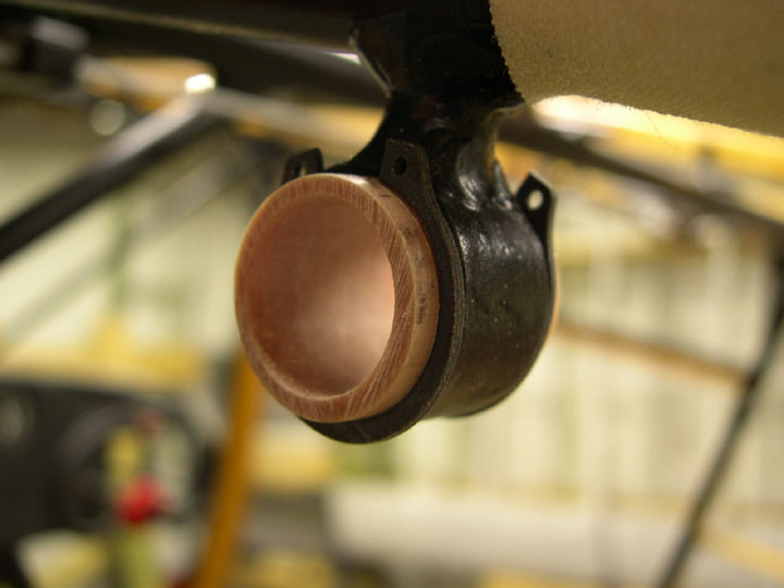

    These look a lot like BC-12D fairleads. Same outside diameter as original with slightly more wall thickness. Genuine phenolic.

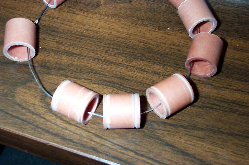

    Make then by chucking the phenolic tube on a dowel, spin it in a drill press while dragging a needle file on the tube. This process takes about 10 minutes per piece. If you don't have a big honking drill press then wrap masking tape around a reasonably large dowel until the dowel is built up enough to hold the tube. A little more tape holds the tube to the dowel on one end while you groove the other end.
    Taylorcraft needs ten of these. I will provide 12 pieces of tube, cut to length but not grooved for 10 bucks and I'll pay shipping in the CONUS. You can screw up two of them learning to cut the grooves yourself -- really you don't want to pay 2 hours of A&P shop rates for someone to cut the grooves now do you?

                Howdy: 12/24/2006 Just an update for the 10 fairleads found hanging on my hangar door handle at 1T8...it was a mighty nice looking Christmas wreath Mark! Anyway, I put a micrometer on the new leads...they were just a little larger than the originals and they would not safely be tapped into the rings. I took a one-handled hack saw blade and slightly deepened the grooves, and then lightly belt sanded the tubes until I could get an individual snug fit on the rings. If your leads come without grooves, I would suggest you dry fit them before grooving for the snap rings. They look original and are better than the stock tubes! Let's call them ersatz (replacement) leads rather than faux (fake) leads! Doc

                      I got my 12 Julicher fairleads last week and put them on my "T" this morning. Beautiful! A bit more work than the nylon fairleads, but worth it. Original style and phenolic too.
