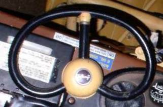

            Could someone explain the difference between banjo and pretzell styles? What years were each? Photos would be helpful.

              The first one is the pretzel and the second is what I've always considered the banjo style.

                Seems to me I flew a 140 Cessna that had the pretzel style as well... always liked them... but those banjo ones are a bit classier. Mine had the cast, cold, standard ones.... thought they were gone (finally ) but Richard sent them back... hahahha
