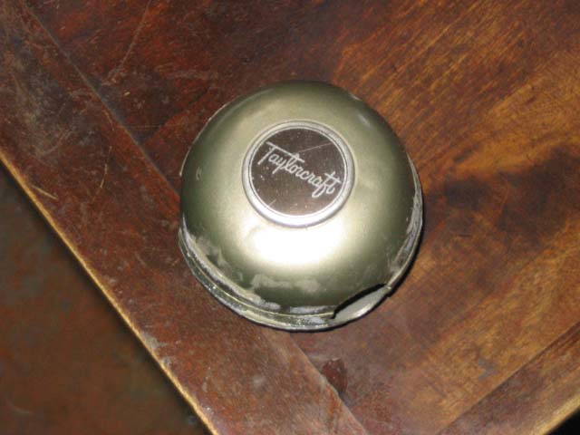

        Rob, I have one that's pretty good...sitting here looking at me.... if you're serious about a pattern... I'm interested. I'd think that a "badge" company could repop the center emblem...

          George:
          I could use both centerpiece and glove box door. I'd use them as patterns to make new and could return them when I'm done. Contact me on the Private Message function. Thanks!

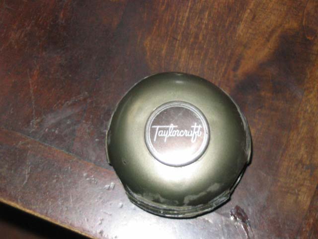

            Tom has said he will OK my passing the turned wood master on to someone with the time to cast new plastic centers. I have the parts and even a litho negative to silkscreen the logo on the button. (This is really THREE different projects, the ball, the buttons and silkscreening the logos). The cast will require an inside and outside mold or a layup in a female mold. If it is cast you could drill down into the cast "land" on the inside of the front ball half for the threaded insert and just Epoxy a RivNut in the hole (using the back half to hold it in alignment while the Epoxy cures). If it is made with a layup of resin and chop glass you would need a fixture to hold the RivNut in the right position while the resin cures.
            Who wants to sign up to make the parts? I would recommend we all agree to share the cost BEFORE the lucky volunteer takes the master. He will need to know how many to make and you can bet we will need to share the cost of a few unacceptable ones. Who's ready to be committed (Uh, I really mean, who's ready to commit?).

                  Just an update. I wasn't able to get the stuff from Hank, but I found a yoke with centerpiece on eBay and ordered that intending to use the centerpiece to make a mold. Of course, when it arrived I found the centerpiece plastic was warped and deformed and useless for making a mold.
                  So, I ended up using a Christmas ornament and a broomstick to make a fiberglass mold from scratch. The resulting centerpieces turned out rather nice and will surely last another 60 years. Photos and details click here, then find the "Yoke Centerpiece" link at the bottom of the page.
                  I think anyone could make their own mold following the procedure on the link, or send me a PM if you'd like to use my mold.
