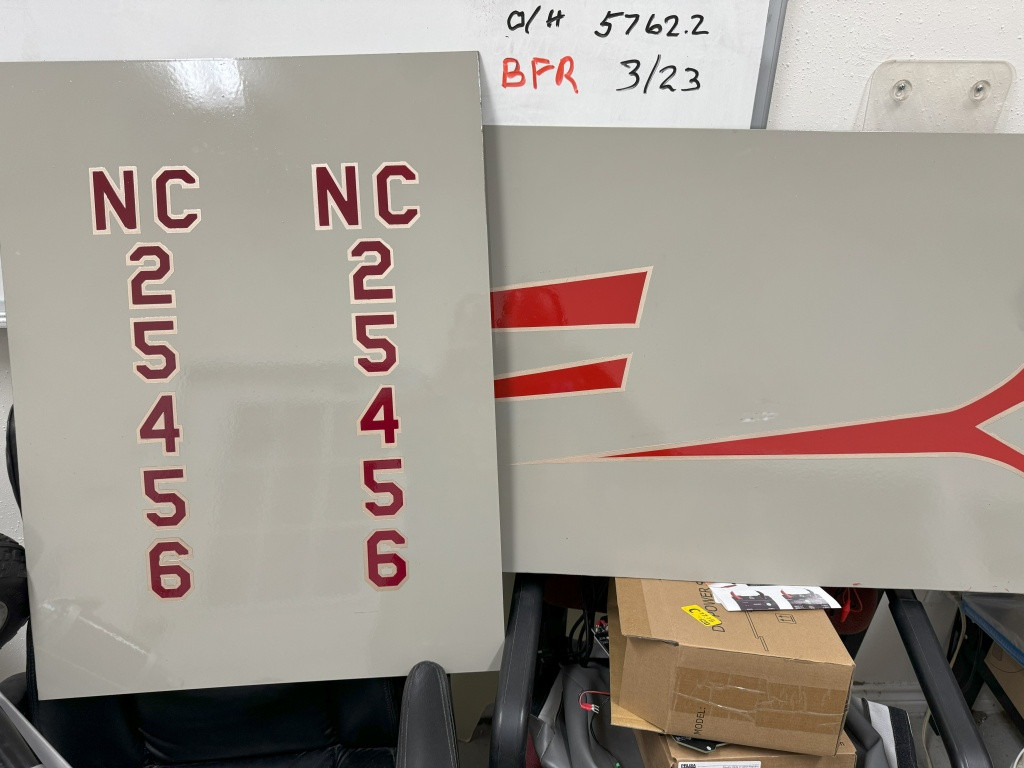

        I just bought 7 gallons of Aerothane for my Rearwin. 6 was recommended but since I had it color matched instead of a standard color I decided to get an additional gallon just in case. This was a test of my N-number masks and and different trim colors (Santa Fe vs Tennessee red). Base is a 2020 Jeep color called Gobi.
        Click image for larger version  Name:	N-number and red trim test.jpg Views:	0 Size:	143.3 KB ID:	196491
