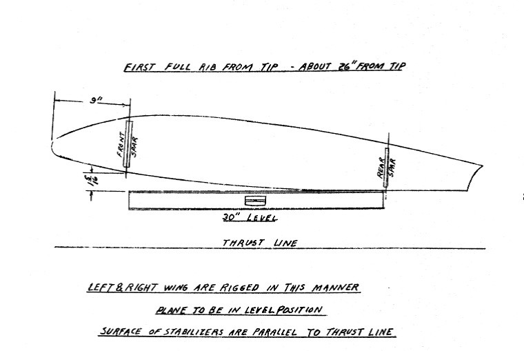

      To get a plane in rig you need to look at more than washout (twisting the wings by adjusting rear strut length). There is a whole process to rigging a plane. If you take the twist out of the wing and the real problem is the rudder is adjusted wrong you could cause dangerous stall problems. BOTH wings trailing edges should be up compared to the root (NEVER DOWN!!!) to insure a stall starts at the FUSELAGE end of the wings.
      The first thing to check is how much twist is in each wing by leveling the fuselage (measured on the horizontal stab) and then remeasuring the existing twist on both sides at the location on the drawing. ON BOTH SIDES. If both sides are the same then you adjust the rudder tab to get the plane to fly straight. Next, once the plane flys straight, you do a careful and GENTLE stall and see which wing drops. The plane "should" stall straight ahead, most don't at this point. BE READY for a wing drop! You then adjust the strut of the wing on the high side from the stall by turning the adjusting screw out a turn and fly again, adjusting the rudder again to get her flying straight. You keep doing this till the plane flys straight and stalls straight ahead or seems to go one way or the other at random (this means you are probably making rudder pedal inputs).

Name:	Incidence stick.jpg

          Hank, I know that the horizontal is the leveling means. It is called out in the TCDS and the manual. Where do you find the documentation that it is parallel to the thrust line?
            Most planes the thrust line is NOT parallel to the horizontal datum. I never measured on my planes because there is no way to adjust it after the factory locks it in when welding the fuselage up. Other planes I HAVE looked at often had a slight down thrust and often some right thrust but I never had any documentation to see if it was off. Down and right thrust are often added to correct for pitch and yaw changes with sudden throttle changes. With only 65 HP I doubt it is a big deal on our planes.

                          Never seen anything that would allow you to twist a Taylorcraft fin and I wouldn't suggest trying it. Yaw is controlled by the rudder and is adjusted with the rudder tab. Roll is controlled by the ailerons and is trim adjusted with changes to the washout on one wing by adjusting the aft strut length. NEVER take all of the twist (wash out) out of a wing! A "flat" wing could result in vicious stall spin characteristics. The angle of incidence of the root of the wings should always be slightly higher than at the ailerons so the root stalls first.
