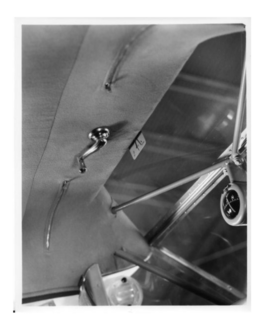

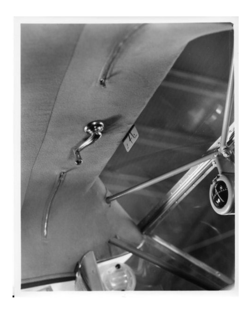

                I have an original one of these vents and they were made from a plastic called "Pyrene". Pyrene was a REALLY terrible early clear plastic that would distort in temps you could easily get in a hangar, it was sensitive to almost any kind of fuel and oil and got really "crunchy" and would shatter if you bumped in to it. Easy to see why they are pretty rare now! I planned to make a form to vacuum mold replacements from thin plexi but because it has shrunken down over the years it is really a sculpting project. Haven't done much to make one since there didn't seem to be any demand from anyone else for them. Might be a nice project for this winter if there is enough interest to justify making some. The cockpit photo is from 1941 and you can see it in the middle of the bottom of the photo. These are old1941 photos and not of my plane or my vent which is pretty twisted up.

                    The photos I posted are the early vents in the upper corners of the windscreen. Note that on the pre war planes with the 4 piece flat front and curved sides and top as four pieces divided by metal strips the front flat piece is called a "Windshield" where the side pieces are called "Windscreens". After the war the one piece windshield was used and the single piece was all refereed to as the "Windshield".
