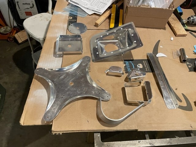

Name:	Radio install components.jpg
                    Radio panel, boot cowl reinforcements for antennae, yoke push button brackets. Thanks for the bead roller tip.
