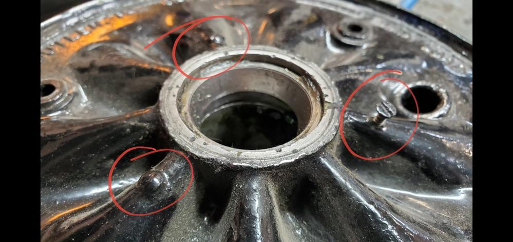

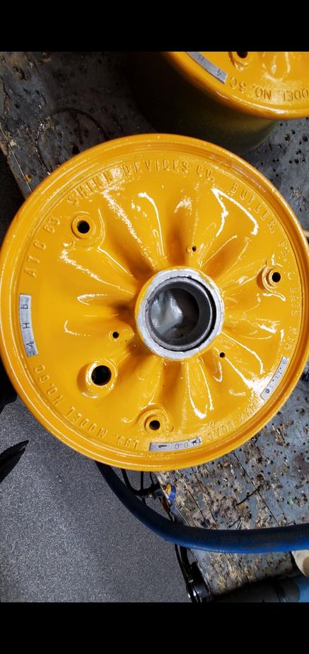

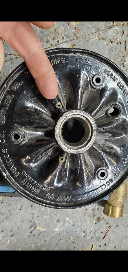

    Any info please? Why the 3 screws?

    I don't think that is standard. Hub caps screwed into long castle nuts that hold the wheel half together.
      If its not original I will weld them shut.

      As already mentioned, they are (or may well be) magnesium! It's not difficult to weld; it just requires the right equipment!

        that is the mount holes for tripod L-2 style hubcap mount.
          Pre war airplanes used the tri-pod mount before the L2. Look at the date on the wheel, and I bet it is 1941 or before. Real early airplanes like the A model, and maybe early B models did not have hubcaps.
            Great! Thanks guys! 1941 and 1940. Any idea where I can find a hubcap or maybe pictures?

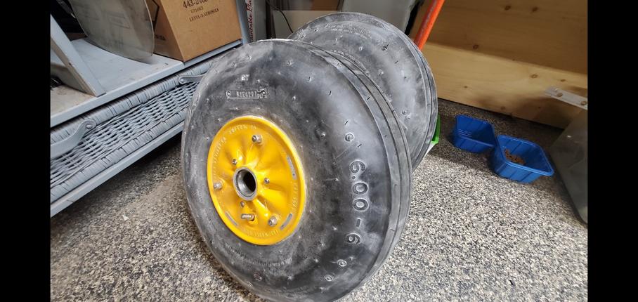

                          Thanks ! I look foward to getting the dust seals! My wheel are ready to go! Landing gear fixed.
