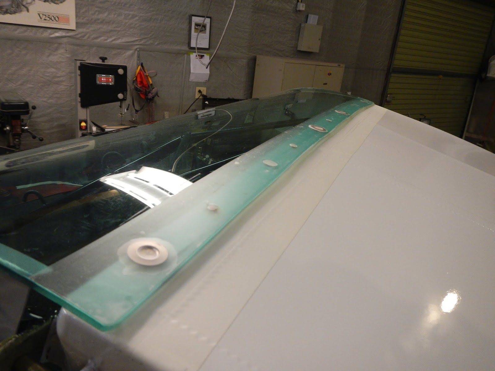

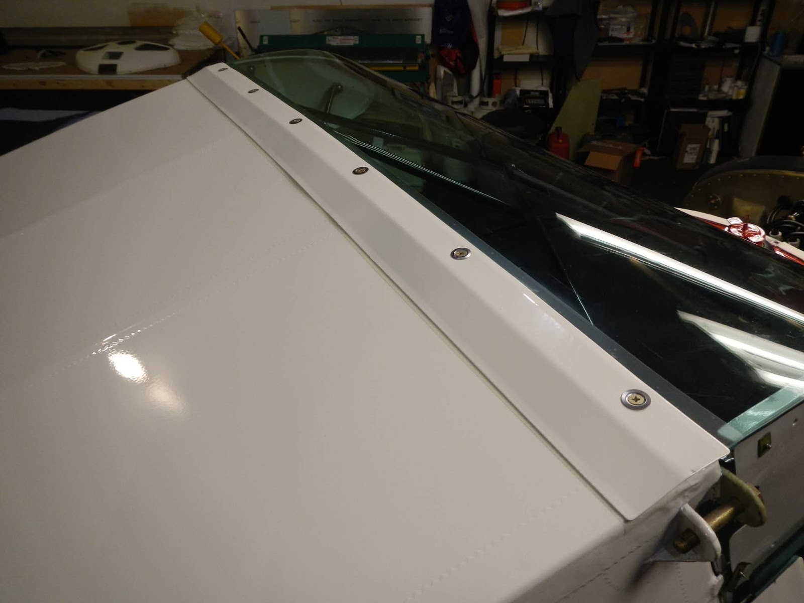

        I used adhesive-backed felt ( believe it's actually synthetic). It is what LP Aero ships with new windshield. If the boot cowl is shaped correctly, water will run out of the trim at the door posts.
        You'll need the wings in place to do final fitting but you can do the bulk of the trimming by following the roof line and positioning the root ribs for reference.
        At final assembly I covered the top aft edge with abrasion tape that was wide enough to protect the fabric/finish and also the windshield.. and also provides some weather seal.
        Plexiglass can be safely cut with aluminum oxide cutting discs and flap discs at 120 grit work well for shaping and smoothing the edges.
        To drill holes, you need to sharpen drill bits at a shallow angle ie so they won't "bite" but rather take small shavings with light pressure.
        See "Final Assembly" at c-fclr.blogspot.com
