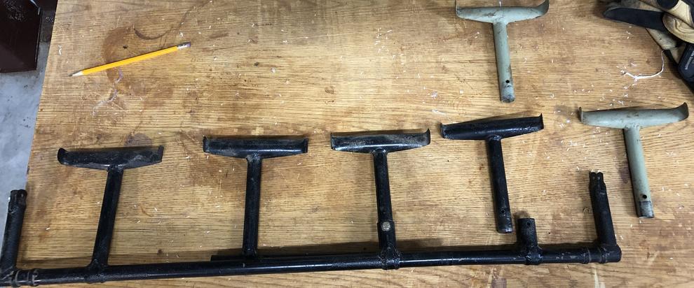

    Here's one I hadn't seen before........... anyone ever run into "Removable Right Rudder Pedals" I have a set of rudder pedal bars that have the right side just bolted on, as if maybe there might be times when they don't want the right side to have rudder controls.......... I also have a couple of extra "bolt on" rudder pedals..... what gives with this?
    Did the company offer such a thing, that bolts on, or removes at the pilot's discretion.........
    I am finding some new things every day.......

    My BC12D has them removable on the right side too.
      So maybe that was an option.........
      "Captain Jon" Timlin
        Both of my planes have bolt on RH pedals as well as a number of spare sets in the parts pile.
          Yes, you can remove them and install pedals that have toe brakes...just say'n
            Ah! Now there's a thought! But you'd then have to fly it from the right seat.............. I have not seen any left pedal as "bolt ons"..........

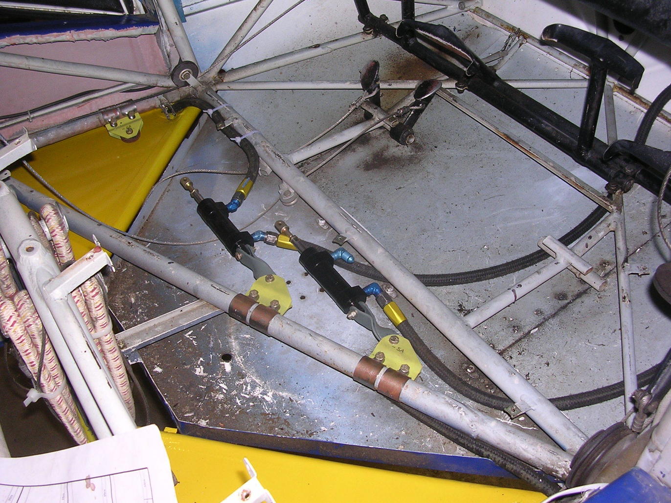

              Piper style pull masters mounted on the gear legs, run the cables from the heel brakes to them, install disc brakes on axles, mount the reservoirs on the masters. Pretty easy to be honest.
                Maybe this way also.

                    I'd like to see the completed installation.................... will there be a bellcrank of some sort to transfer the cable pull force to the brake cylinders?
                      pull masters, no bellcrank required
