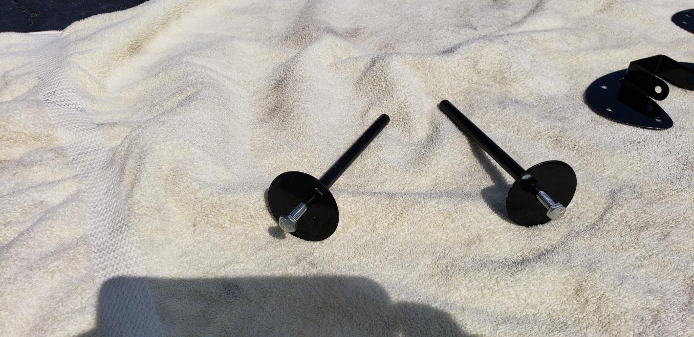

          It appears I was dead wrong. Ryan you will recognize this as the Wag Aero hardware. After going through the package (duh hu) I found bolts and that the threaded holes accepted them. I thought at first glance only large enough for screws The outer hardware is not as robust as what Scott built but it will work. Any one Dejavu on the starting condition of the pants shown in previous post?
          Those are the ones Jim and they are holding up just fine for me. Attached just as Scott describes. The other way of attaching the outside of the wheel pant that should be mentioned for completeness is the wheepant axel nut. There is an axel nut that is about 2-3 inches in length that is threaded on the outside to except a bolt. I have a set of those as well and can post a picture of them when I am to the airport next. I do believe they are difficult to find however.

            Ryan, I was wondering about available "extensions" in my fathers pictures he took of the plane Circa 1969 it appears to have extensions out the center of the wheel. Ha retrieval on the way ! On second thought.. Why did you decide not to use them?

              I have a set of the axle nuts on the 41 too. They shouldn't be hard to make. Just a piece of steel hex stock with a small hole drilled through and threaded followed by a larger hole partial drilled and threaded for the axle. Thee is also a small safety wire hole to keep them from turning if I remember right. I will get dimensions.
                Hank, When you recover from the heat going to the hangar let me know. It has been a real bear in SC this summer also ! Thank you again for going way out of your way. Glad you received hopefully an award for that already!
                Excellent question! We did. They are aluminum and our wheel pant vibrated enough that it wore the threads in one of them. We fly off grass and in the summer can get hard and rough, which may not be an issue if you are based on pavement.. Also our airplane had the off airport excursion going to Oshkosh a few years ago and that may have played a part.

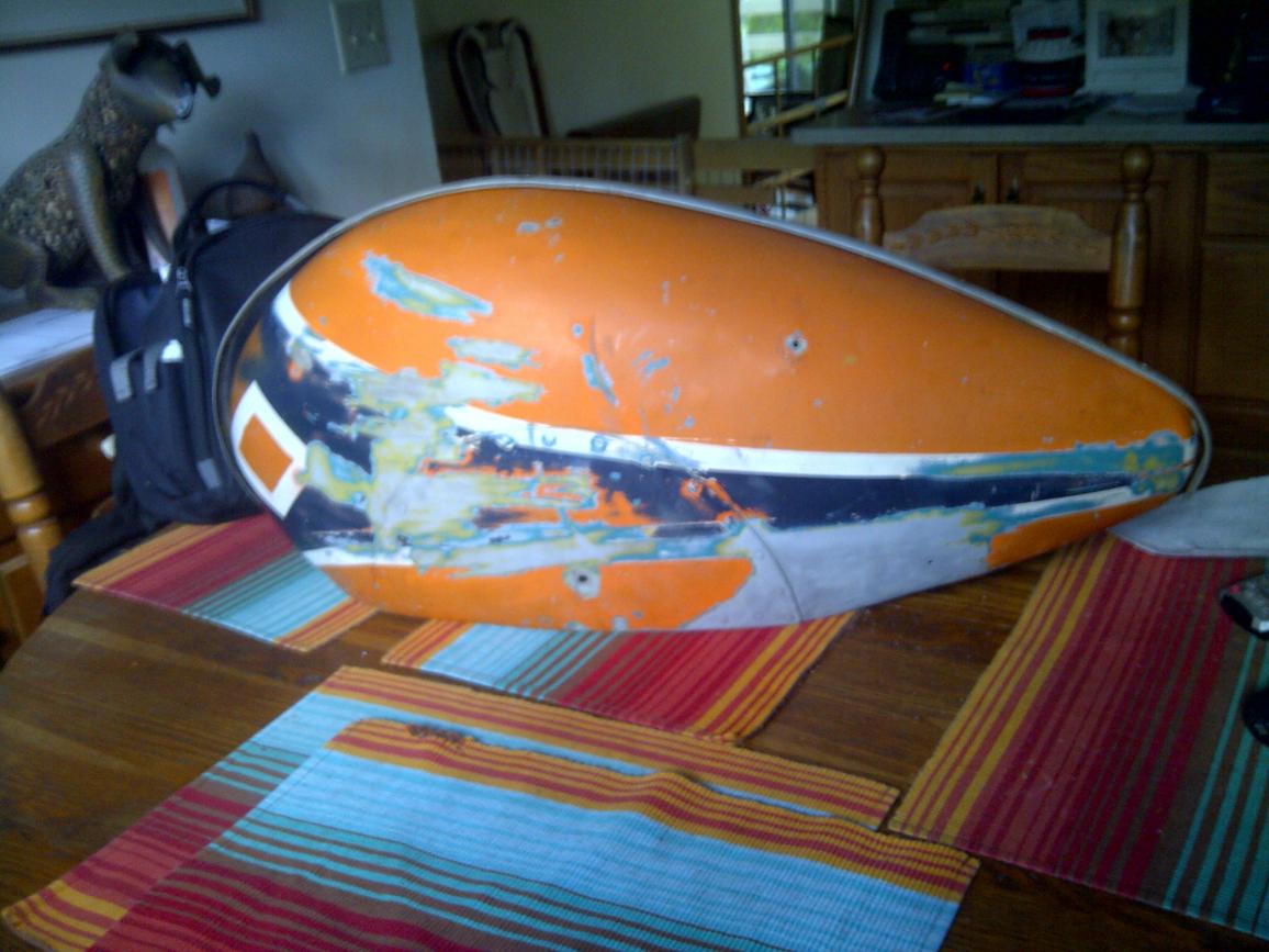

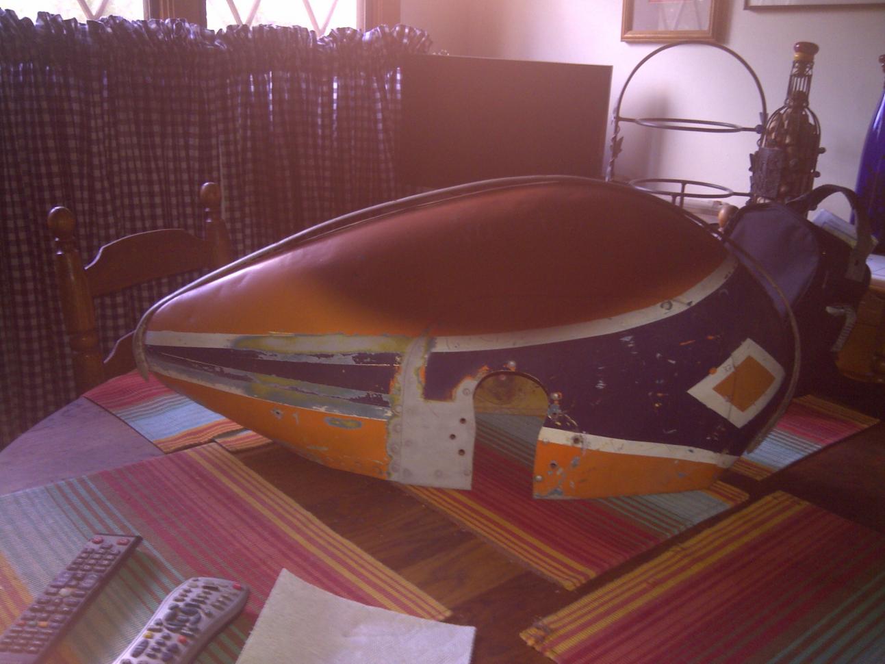

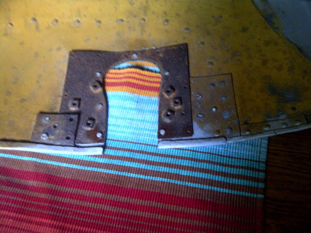

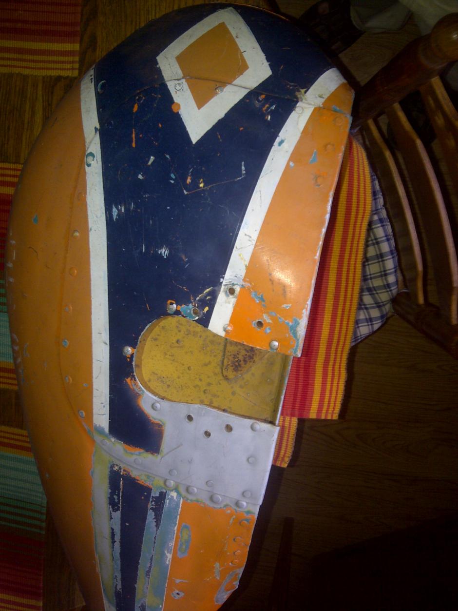

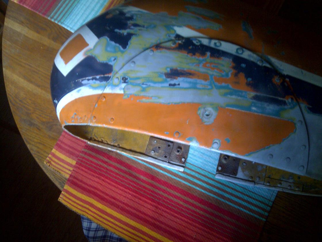

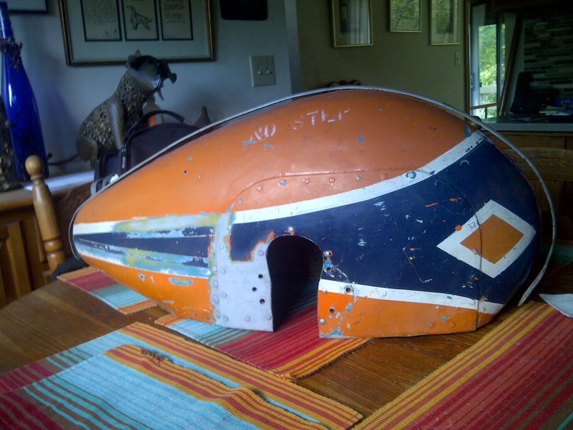

                    Got some photos of the metal pants from the 41. Hope you guys can let me know if these were like the production ones before or after the war. My 45 was an "odd bird" in that it has lots of parts from Pre-War and Post-War. The 41 has what looks to me to be an aftermarket GRP pants with odd mount holes. I will be starting a thread on restoration of them in the"Model B - 1941 Deluxe production topic area". If it turns out the metal pants are also like the 41 I will post the resto process there too. Nice winter projects for when it goes from too hot in the hangar to too cold.

                      Note that there are LARGE external doublers on the sides of each pant. These are aluminum while the internal doublers are steel. The square doubler in the 4th picture next to the cutout dobler looks like a repair. There are also a few (surprisingly few) aluminum repairs . I need to get a shot of the outboard side doubler that reinforces the bolt hole that is normally covered by the "Bird". It is also steel and I will get some tracings of all of the doublers now that the pants are clean enough to be in the house (and yes, I did have to clean the shower!)

                          They have the chrome strip so they are postwar pants.

                            I was thinking the same thing.
