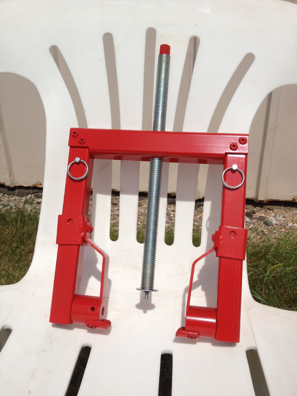

                    I just built one for myself and have the steel to build a couple more, if I ever find the extra time--need to get my plane up on legs and back in the air before that will happen.
                    By the way, I'm not looking to compete with anyone, if I do find the time to make one or two more that would be all.

                      You can simplify the fabrication dramatically by eliminating the two sliders (I was never sure they could retain a wayward bungee anyway). All that's needed is a smooth notch on each "toe" for the bungee to sit in while your cranking it up. It won't roll off even without the notch, but the notch creates a more positive seat. Once up against the cups a blunt pry bar helps the bungees into position.

                        Nice looking tool!
