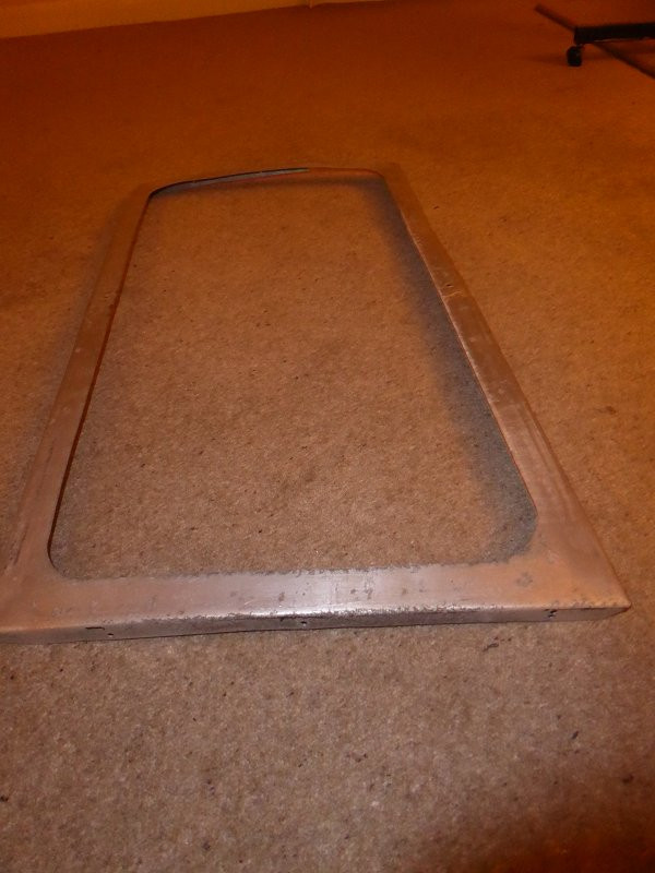

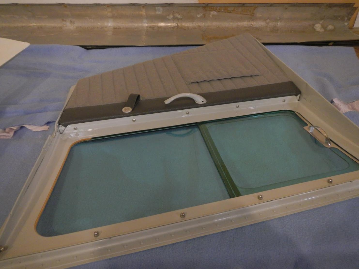

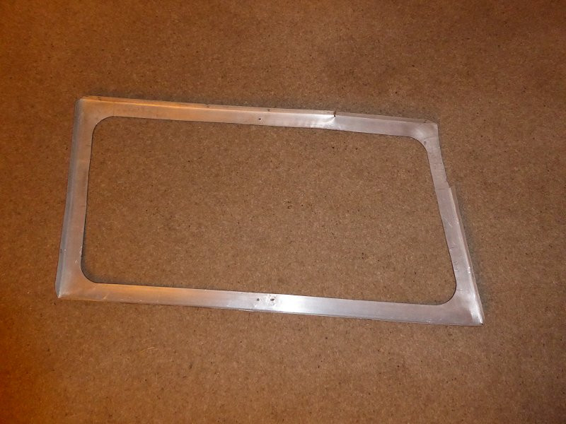

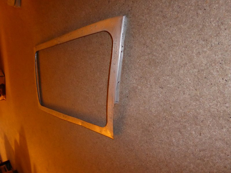

      Anyway, to answer your question, and assuming that the doors themselves are still original, the interior frames are easily made fron 0.025" aluminium with common sheet-metal forming tools. The glazing is simple acyrlic sheet.
      You can so this under pilot-owner maintenance for the side glazing. Just a log book entry.
      I attach some photos of one of my old ones (I made new, due to corrosion). Simple cutting & folding tools, plus a shrinker to form the curves.
      All the best, Rob

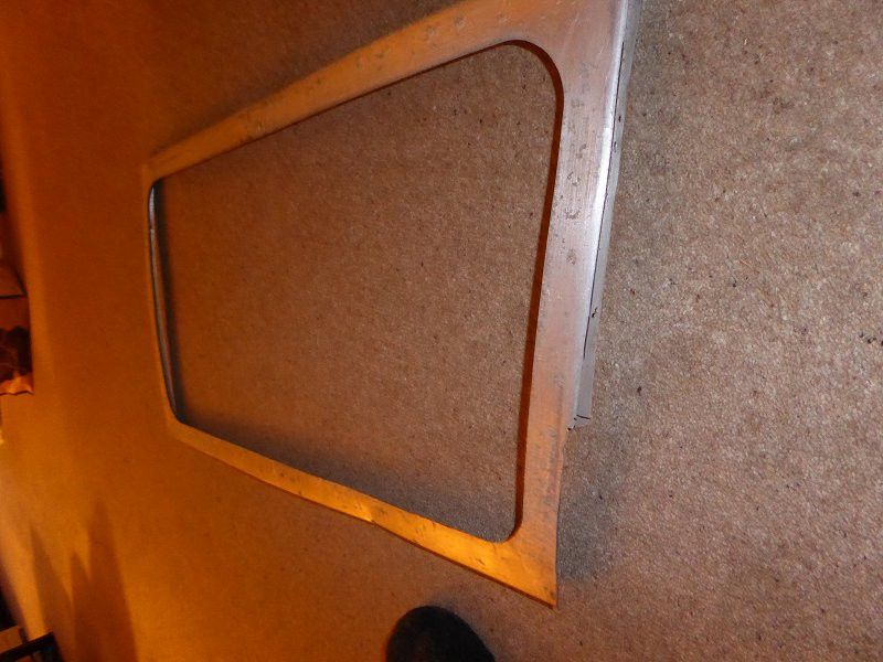

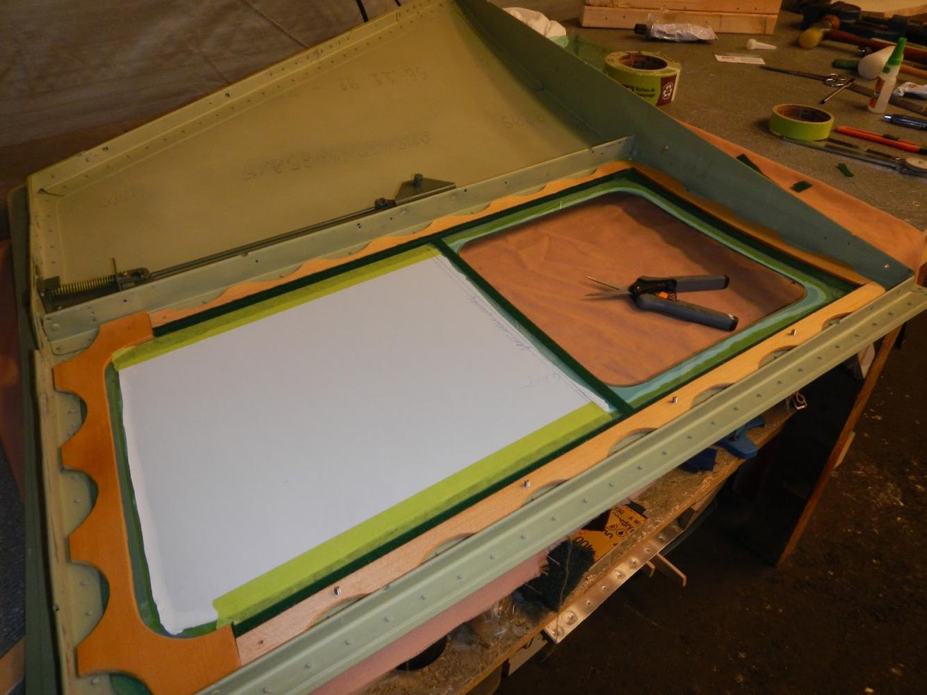

                Thanks Rob for sharing the photos of your frames, I would like to find a example of the sliding tracks for the plexiglass, I saw a track on a Aeronca Chief at Oshkosh last year The owner had made it out of hard foam he had purchased somewhere and routed groves top and bottom for the sliding plexiglass.
                  The basic problem with the sliding windows in post war doors is that the doors/window frames are curved (top to bottom) and plexiglass is straight!
                  The typical installation I found during my research is basically two pieces of plexi sandwiched between the frame (that Rob showed) and the door frame, with various amounts of felt to try and make them tight.
                  There was a post wherein someone had formed plexi in the oven to get a better result. I built on that idea and fabricated wood frames/spacers to get an airtight and smooth operating result. All the gory details of the complete door rehab can be found here: http://c-fclr.blogspot.com/p/doors.html

                    Here's what it looked like after final assembly;
                      That is beautiful if you take your plane to Oshkosh as you did last year I hope to see it to get a good look. Thanks Scott
