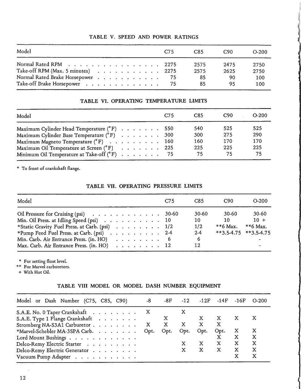

              On RPM for the C-85 from the Continental overhaul manual. Gives 5 min take off power of 2575.

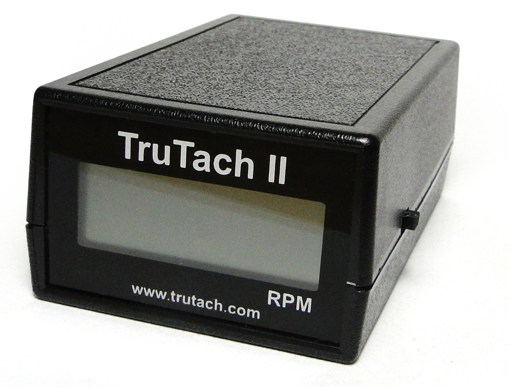

                      If you install a new tach and engine try to get the tach's accuracy checked with an outboard tester. Mechanics and those that do prop balancing have them. They're a couple hundred from parts suppliers and mount on the panel top with velcro.
                      Digital tach readers are cheaper than that, and can be hand-held from inside the cockpit in flight. You just have to tell the device how many blades.
                        Here's a couple of portable tach checkers. Mine is the second one and I loan it out locally to anyone who's curious about their tach's accuracy.
                          It also gives normal rated power at 2575, so there is no 5 minute limitation. Look at the C-90, and the numbers are different, so it has a 5 minute limitation.
                            The tach should be marked per the documentation for the airplane. If you are doing a STC for the 85 installation, then you need to mark the tach per the STC.
