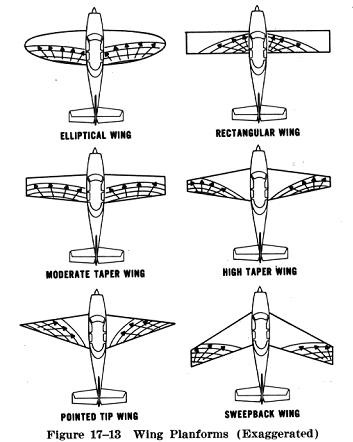

                          I suspect that with the elliptical wing of the GB the tip wants to stall. If so down aileron may provoke it sooner especially if there's no washout to the wing for speed. See the pics>>>> Click image for larger version  Name:	2H8Bm.jpg Views:	1 Size:	38.4 KB ID:	182802
