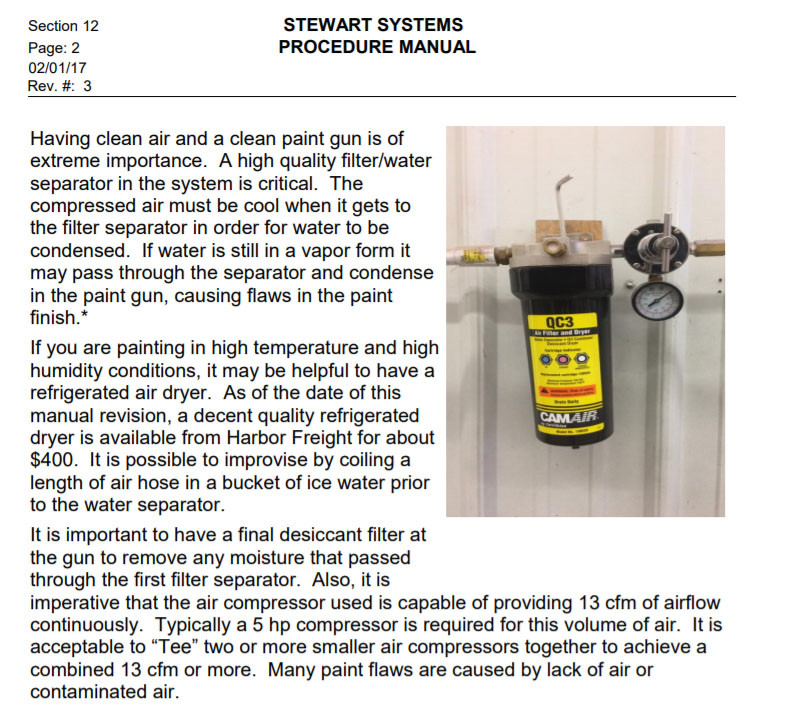

I assume they're describing this thing.
Between my neighbor's improved success by adding hangar air conditioning, and the addition of this info in the manual regarding high temp/high humidity conditions - it tells me that there are difficulties using Stewarts paints in the conditions that are predominant where I live. Regardless, I'm not interested in experimenting further. I'll use the urethane that I'm used to, coupled with a fresh-air full face mask and paint suit.Brian Cantrell

There is an inexpensive solution to moisture problems... I run a small dehumidifier in my hangar whenever the temperature is above freezing. My air compressor intake is right next to the dehumidifier outlet.
I originally did this because the floor is asphalt and moisture percolates up from the ground (which is poorly drained) and used to condense on the ceiling. Yes it would actually rain inside the hangar.
The dehumidifier provides me with a supply of distilled water (no water supply in my hangar) and keeps the relative humidity below 50%. Sweet?Scott
