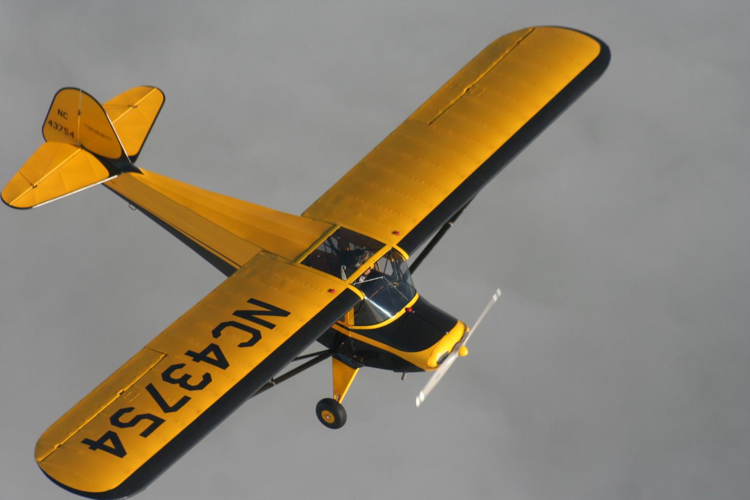

      Ours is smoked 30% if I remember. We never have the bad greenhouse effect.
      Ryan Newell
      1946 BC12D NC43754
      1953 15A N23JW
      TF#897
        Seems like mine is 30 per cent also, haven't noticed any problems, no one has told me it looks strange, course I don't fly with anyone from across the pond,
