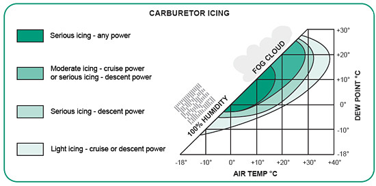

              that temperature and dew point spread represent a relatively low probability of carb ice.
              the most likely reason things improved with carb heat is because the heat results in a richer mixture.

                              useful chart. Note the low probability of carb ice with temp and dew point from original post
