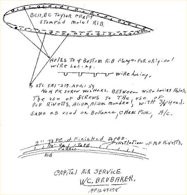

                  The Taylorcraft wire not being available I used rivets with DER approval, works wonderfully

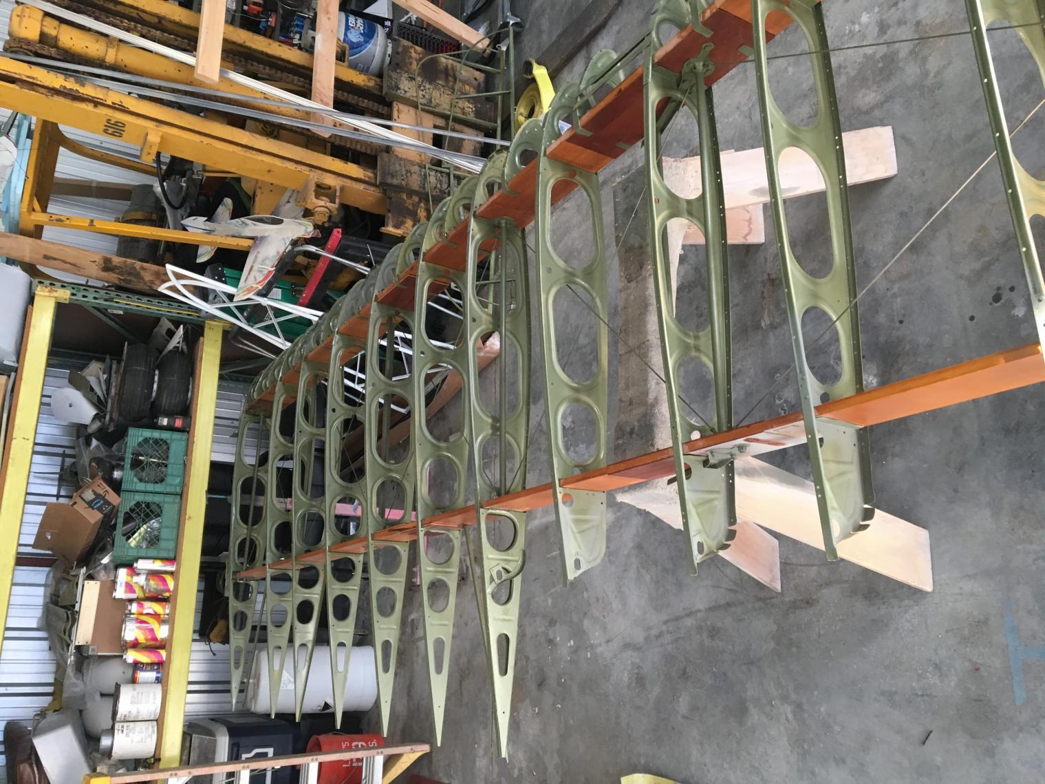

                      Havent figured this out yet but getting close

                          This is from the 337. Pretty straightforward really. The F19 is an evolution of the type, has for all intents and purposes the same wing and the aircraft has a VNE 10MPH higher than the BC12D.
                          The 337, the FAA Memo, the Polyfiber Manual, AC43.13-1a, to which they both refer, other 337's that are out there, constitute "acceptable data" in my view. More than enough to support the modification and whatever certification is required.
                          Note that one of the reasons for the modification is to "eliminate damage to the wing ribs during removal and installation of the wire." I would be interested to hear from anyone who has found undamaged ribs. Most of the holes in my ribs were keyholed, meaning that even new wire would be compromised had I used it.
                            You got a ways to go yet!! Nice job so far
