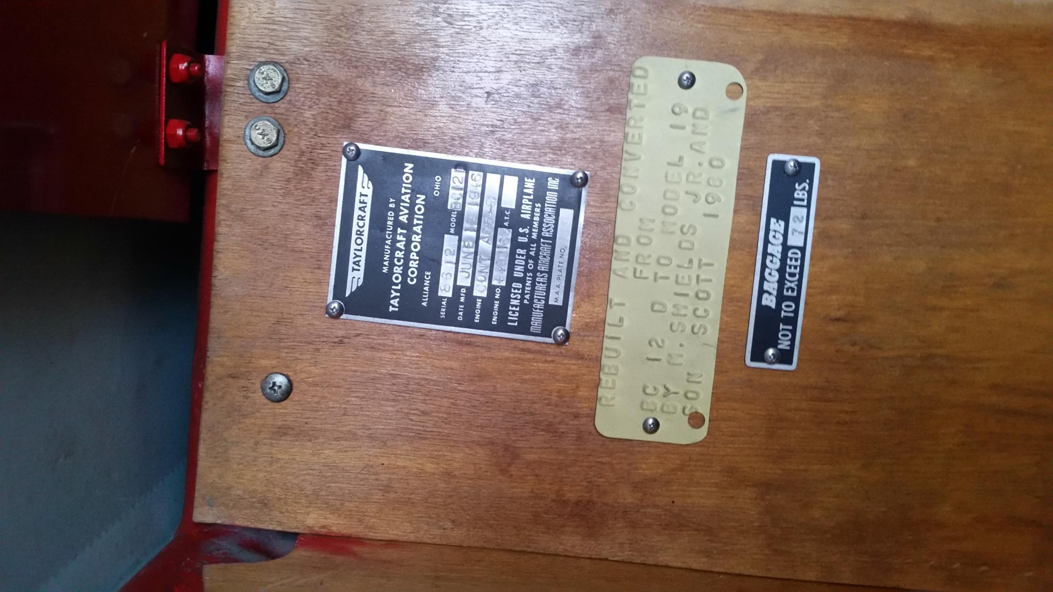

      Also when at the plane I have the placard that describes the plane was built to a f19
      Also have a one time stc for conversion to a f19 or to be used as a bc12 85f

              so here is the wrench.. one time stc for this plane to be considered model 19 or bc 12 85.. should i carry the 19 information in the plane then.
              also looking back at one point the plane was blue and had a 2ft speaker in the baggage compartment as a public address system
                Re: required DOCs
                Its still a BC12-85, just has the attributes of a model 19, so the BC documents should be what you want.

                      Re: required DOCs
                      I agree with Dr. Tim,
                      The data plate shows that your aircraft was a BC12D, modified to a Model 19 configuration (probably by the Gilberti STC), which is different than a F-19. The model BC12D-85 is a continuation model under the CAR3 Type Certificate A-696, but the Model 19, the F-19 and all the F-xx derivatives are under the TCDS 1A9.
                      What Gilberti was doing as the Taylorcraft designer was providing a way via STC to make a few modifications that increased gross weight and performance to close to the Model 19. The problem is that you cannot modify an aircraft by STC from TC A-696 to another Type Certificate 1A9, so your aircraft has to remain a BC12D, albeit modified. Your FAA Registration and A/W Cert should be for a BC12D, not a Model 19 or F-19.
                      Mike Rice
                      Aerolearn
                      BC12D N95910 Tale Dragon
                      TF #855
                        Re: required DOCs
                        Mike's right on the money! It is and always will be a BC12. You most likely will have some operation parameters that are specified in the STC that need to be carried. The STC will call that out. If it's done by the Gilbertti STC, there's a flight manual update, if I remember.
