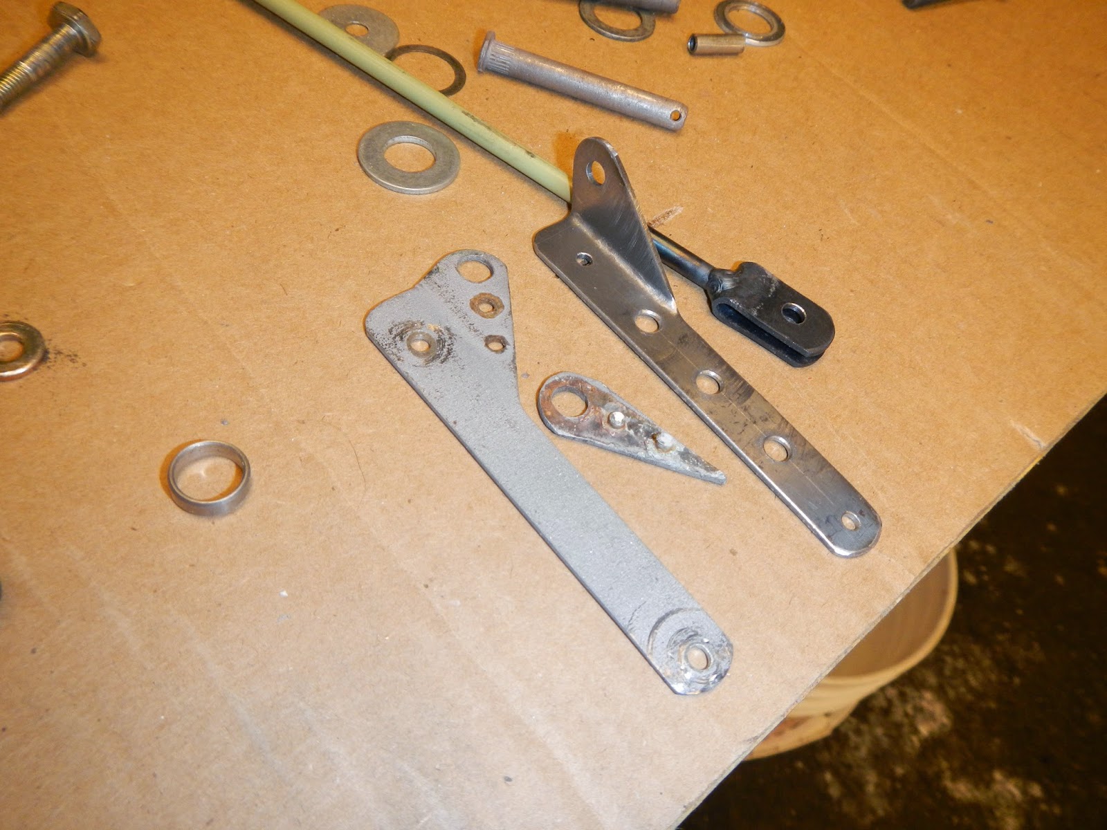

                Because the bellcrank is asymmetrical (the tab pushrod side is longer than the screw-jack side) a small amount of play in the shaft and associated pushrod,translates into a relatively larger amount of slop at the tab. I used a thin nylon washer to take out all the end play in the screw-jack. This made a big improvement.
                http://4.bp.blogspot.com/-u08gTg_hw1...0/DSCN3156.JPG
                I also found the holes in the pushrods and the tab horn were worn. The original material is quite thin (040 or less) so there is very little in the way of a bearing surface. The horn is easy to make, pushrod ends a little more involved as they need to be welded. I used 050 chromoly and suggest a sticky grease like EZ Turn to keep the pins from spinning/vibrating/wearing.
                http://3.bp.blogspot.com/-x6cAPor_gn...0/DSCN3154.JPG

                      Hah! Caught again by someone who knows better. I never really looked at mine before. But from the fine pics offered above I guess I need to look again.
                      If that castle nut with key comes off then I should be able to washer it up. My inspection covers are new lexan so I can look and get right to it after I call my mechanic about my plan. I have or can get thin aircraft washers or maybe a nylon on but usually they are Ace Hardware stuff and thick.
